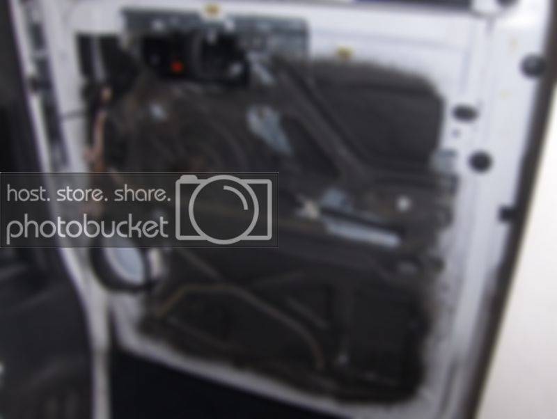

I decided it was time. I used the Spectrum Spray on my doors, but I couldnt get it thick enough, so it didnt work worth a shit. Worked great in the back where I put it on really thick, though.

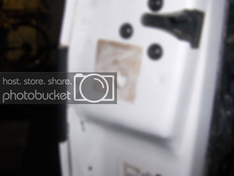

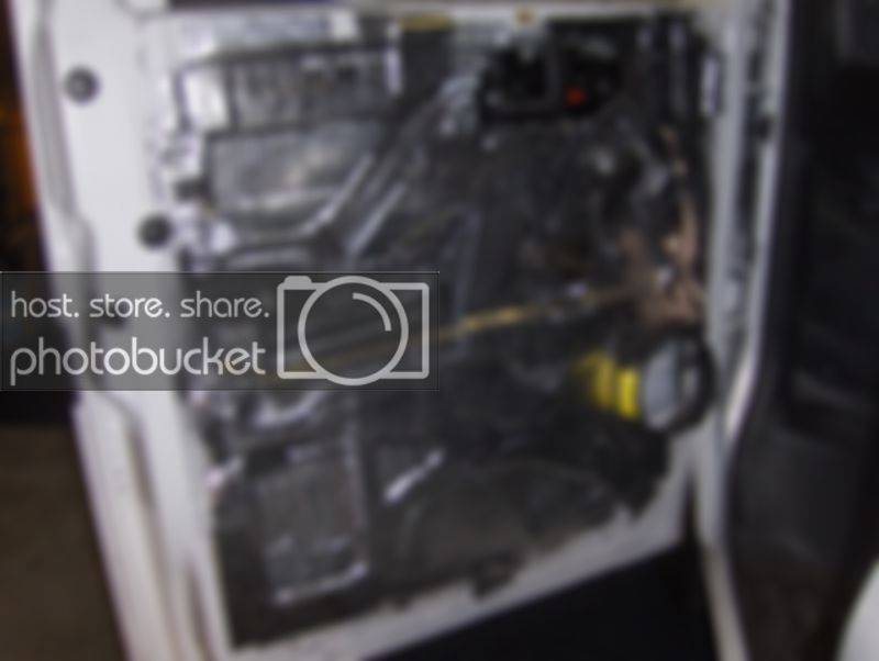

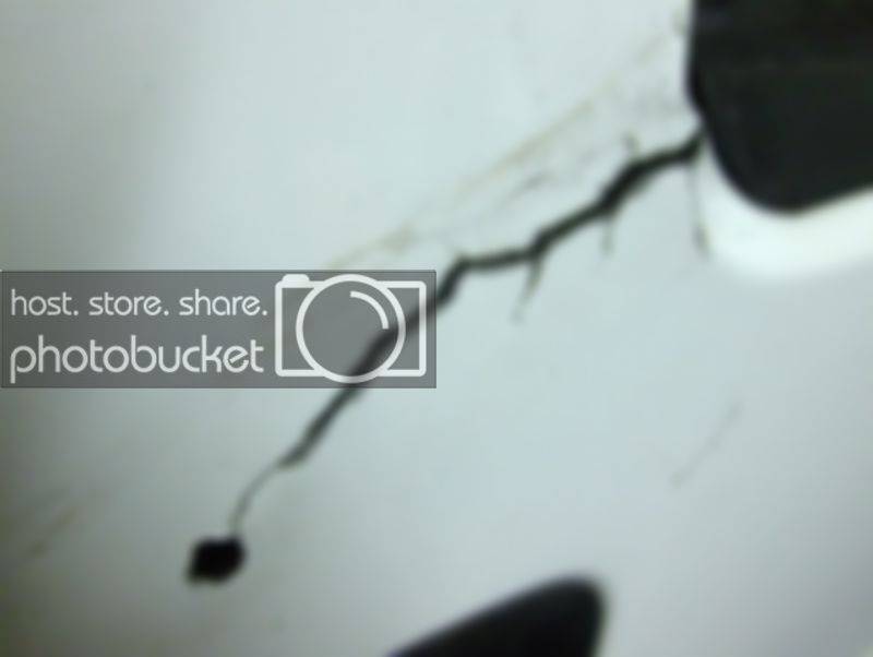

The rattling was driving me mad, so I broke down and bought 60 sq ft of Damplifier. My doors flexed so bad, something needed to be done. I was getting a pretty nasty crack in the passanger door, and I found one in the driver door as well. People said the latch was the only thing holding the door on, and they were right. A crack began around the latch, which I have never seen before. Eventually if it grew enough, It would probably just break off, seperating the latch assembly from the door.

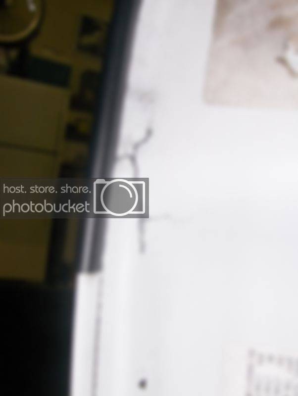

There was a crack growing on the passanger door, and Scottie Johnson told me that drilling a hole at the end of it would stop it from spreading. I took the leap of faith and drilled a hole through my door pannel. //content.invisioncic.com/y282845/emoticons/crap.gif.7f4dd41e3e9b23fbd170a1ee6f65cecc.gif It worked though, as it hasnt spread at all lately. Now I gotta find a way to fix it.

Anyways, heres some pics of the deadener and damage.
Before
After
Stupid latch crack
Passanger door crack

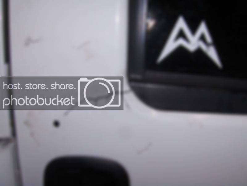

My window flexes in my door and it messes up my stickers. //content.invisioncic.com/y282845/emoticons/crap.gif.7f4dd41e3e9b23fbd170a1ee6f65cecc.gif

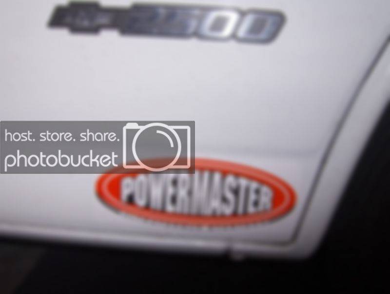

FTW
