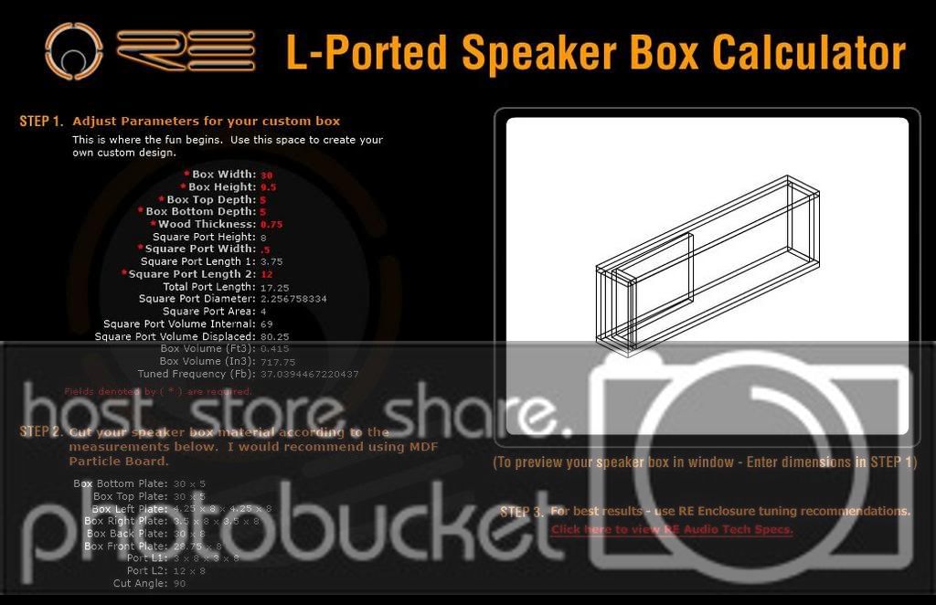

for his dime: 8" ER sub. .415CF box at 37Hz, and a lil kenwood KAC-646S

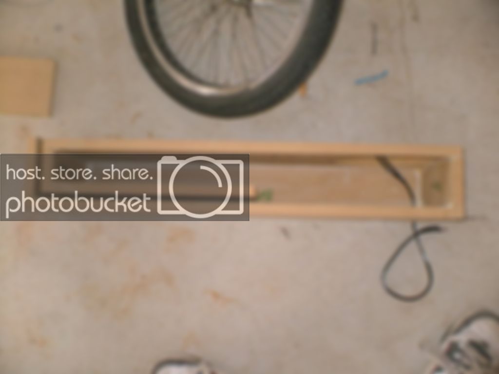

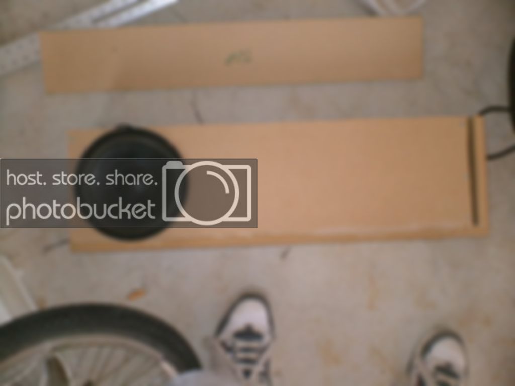

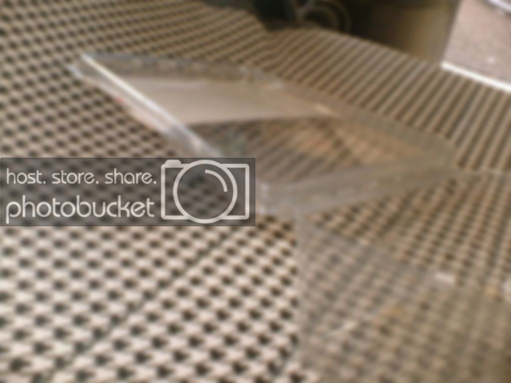

a few shots of about 85% done:

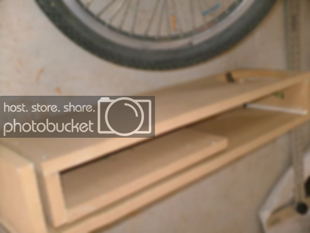

a little dry fit:

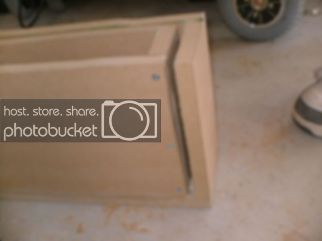

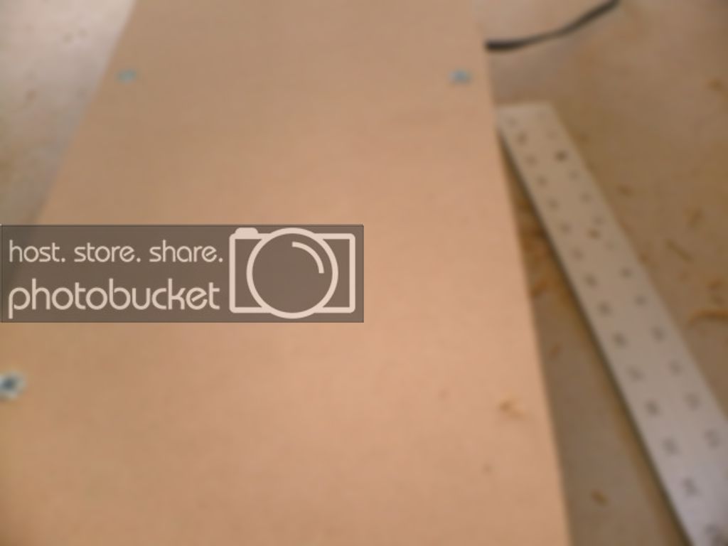

CRAP! One screw short!
uh oh! looks like it was hiding!:

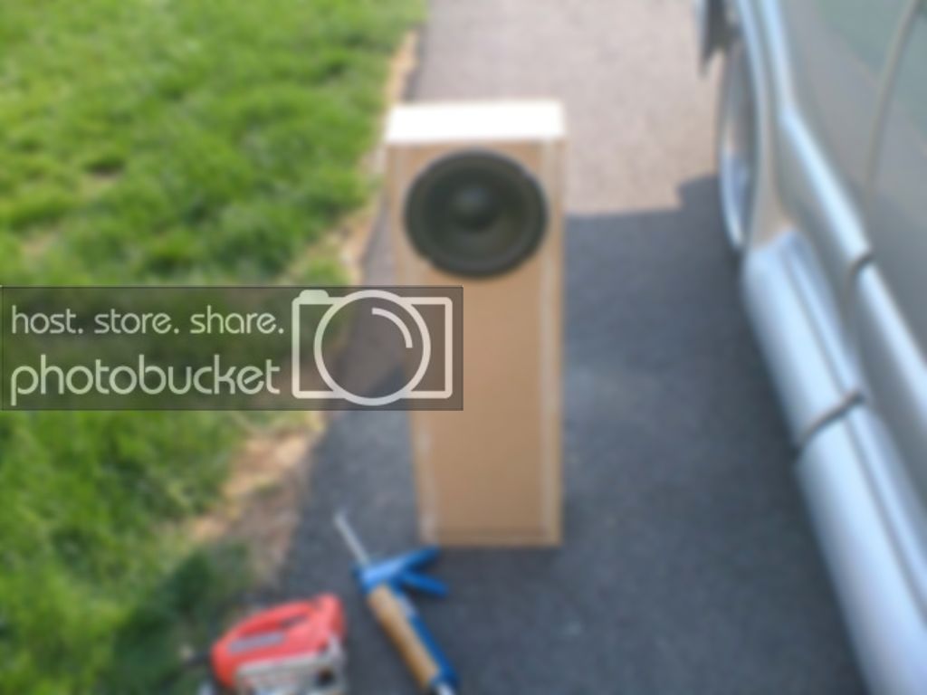

and the finished product //content.invisioncic.com/y282845/emoticons/smile.gif.1ebc41e1811405b213edfc4622c41e27.gif
//content.invisioncic.com/y282845/emoticons/smile.gif.1ebc41e1811405b213edfc4622c41e27.gif :) //content.invisioncic.com/y282845/emoticons/smile.gif.1ebc41e1811405b213edfc4622c41e27.gif
cause he has no sub, and he is on crappy coaxials, so I'm amping his system and giving him some bass he doesn't have...
