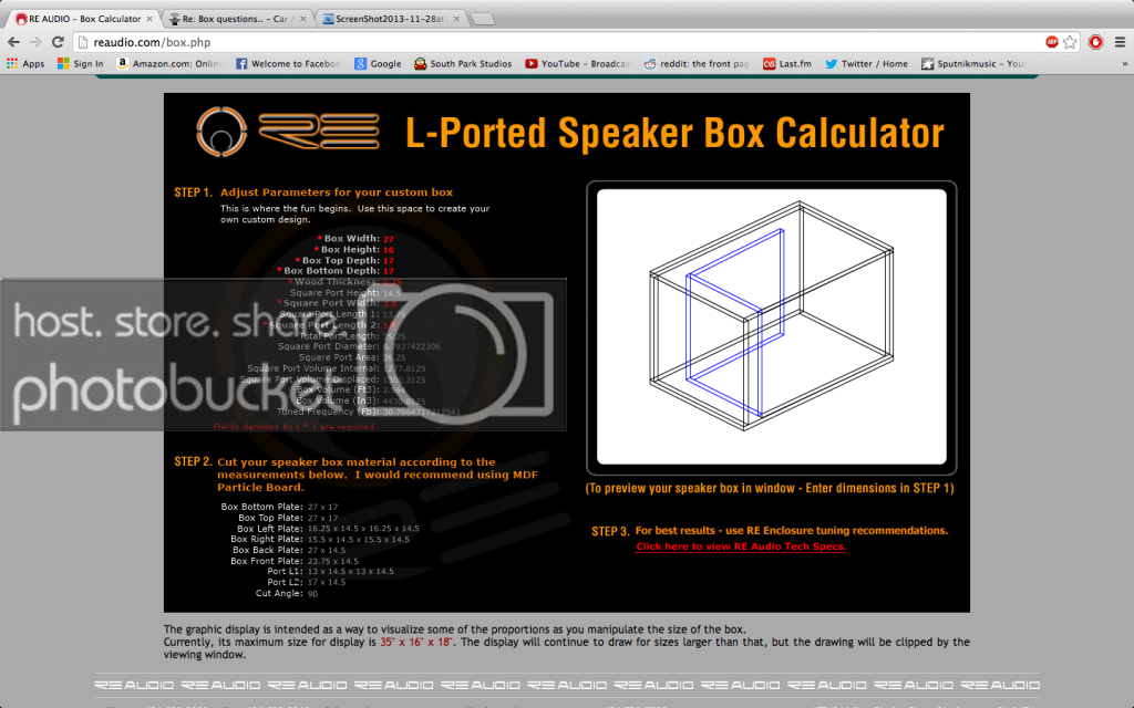

This is my first box i've ever tried to build. I just want somebody with experience to confirm that it will work for me, or that there's something I'm missing.
Box is for a Q 12".. wanted to give it 2.5 cubes tuned around 30-31 hz. This is what I came up with, does this look good/acceptable? Around 35 inches port length and about 14.5 square inches port area per each internal cube.

Okay, but it's simply a calculator lol.. and the math adds up. What's there that shouldn't be relied on here
Hey, I can't argue with you about the math adding up. I can do the math as well on paper to verify the re website. However that site does not take into account a lot of other parameters that the others do to give you the corrects specs for your sub. And what I mean is "specifically, your sub".

I see. What would be a better alternative?

What about the particular sub makes you decide on that? I've never heard that much...
The xmax and piston area determine what size port you need for a given driver. With 28mm of xmax, the sub you have needs more port area than another 15" sub with 19 or even 11mm of xmax, as seen with a lot of entry level subs. Even though they're all 15s, they all have different abilities where moving air in and out of a vent are concerned and if you use too little port area, you wind up with poor performance and port noise.

Interesting, thanks for the explanation. I knew that 28 xmax was quite a lot of excursion but didn't know I would need that much more port area.. so here i have it showing 2.5 by 14.5 inches... are you thinking something like 3" by 16? Couldn't there be potential downsides for going so big on port area?

I'd go with something like 3-3.5 * 14.5 so that you don't increase the height of the box to accommodate the port. That will also increase the volume the vent consumes and the vent will need to be longer.
And yes, there are potential hazards to using too much port area but not "that much port area". That much port area is what that sub needs. If you were to put an entry level sub with 11mm of xmax in a box with that much port, you'd run the risk of mechanical failure due to over excursion of the sub. But that's not what you're doing. ;-)
Consequently, that's the primary reason prefab boxes get the bad rap they get.... 90% of them, and to be sure all the cheap ones, are made for low xmax subs. So, when people go out and buy a high xmax sub and stick it in a cheap prefab box, it sounds like shite and they blame the box builder for tuning it too high when in reality, it's probably tuned to a perfectly reasonable frequency (around 35Hz) and the real problem is that there isn't enough port area for the sub that's in it.
