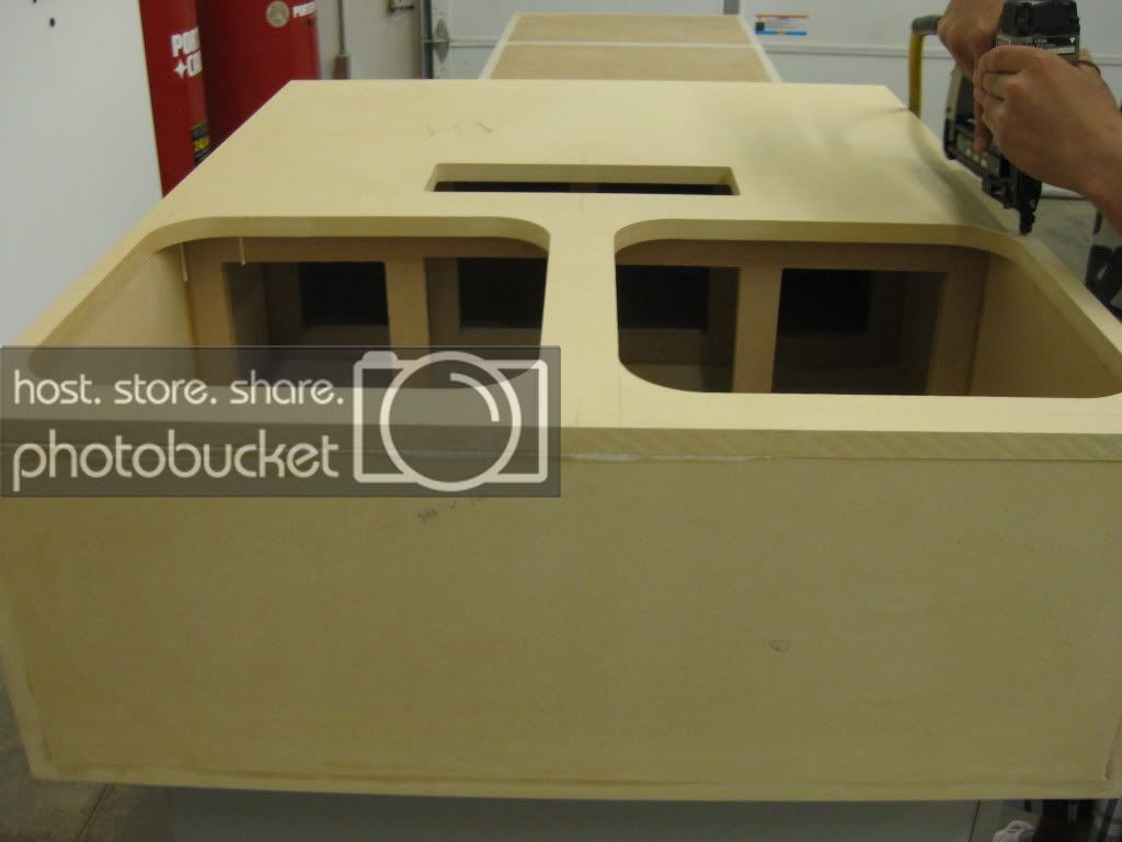

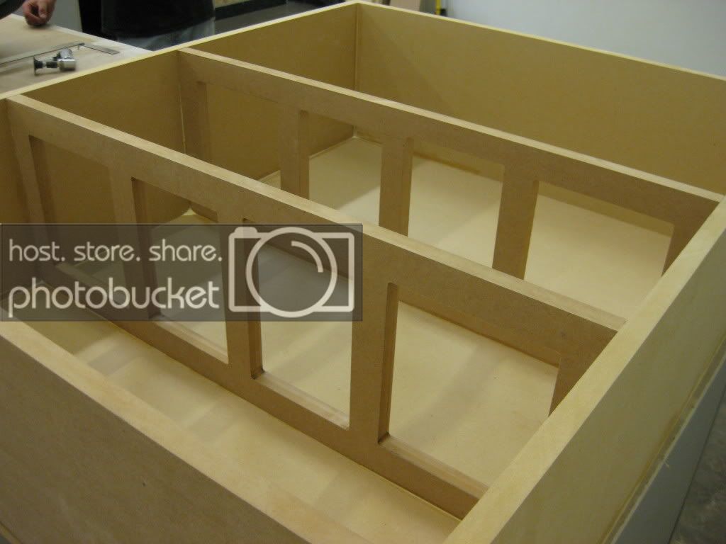

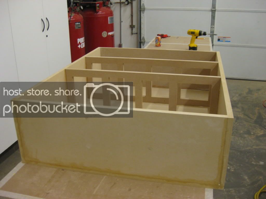

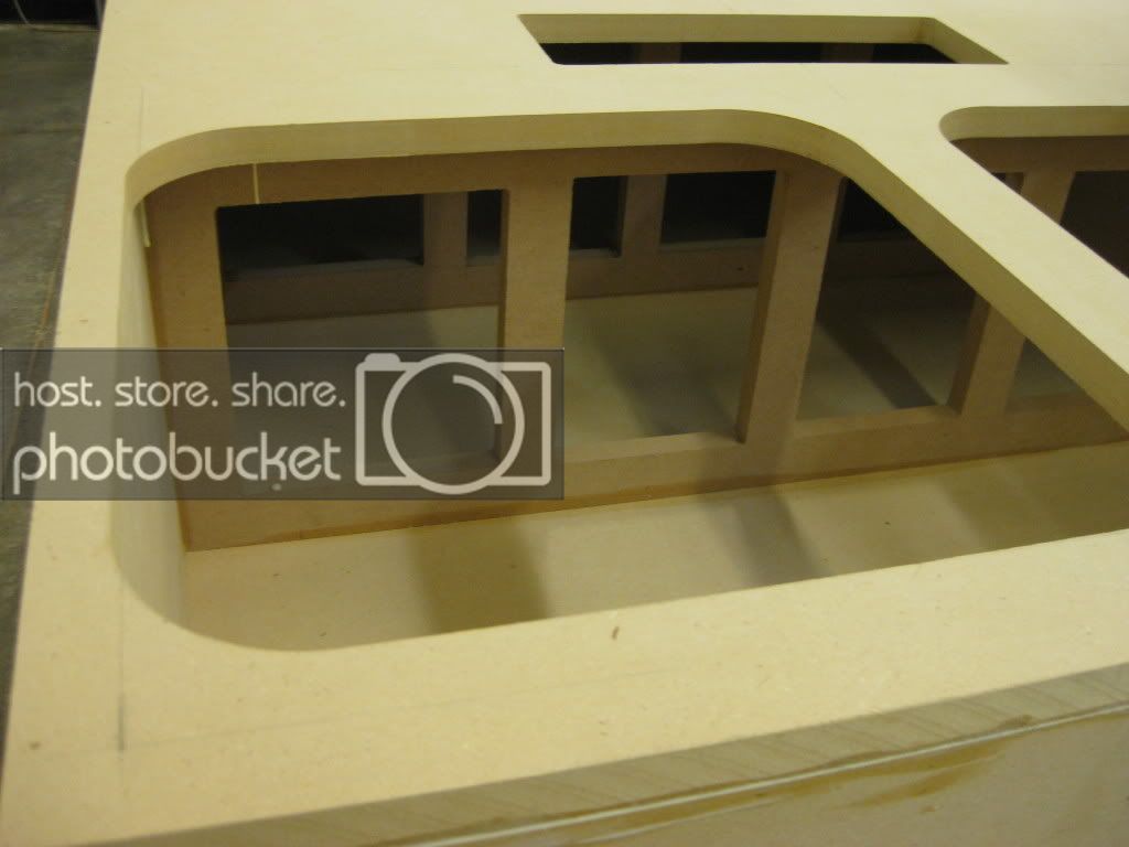

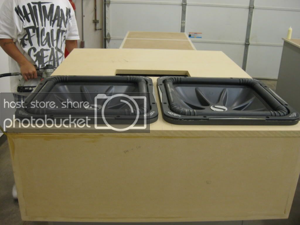

you can still use screw, but not as much as this previous build. like someone said, if glued and joined properly, there's no way in hell that back panel would come out that easily. the board will break before the glued joints will fail.
round two, this box is solid,
6 cubes, 48" of port area, 26-28 tuning, subs up port back

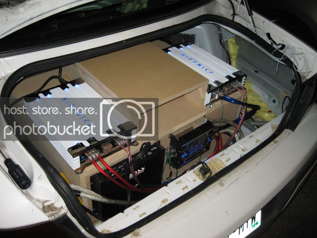

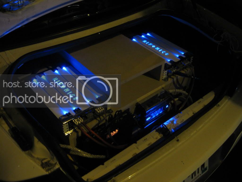

this is the first time ive ever mounted the amps to the box im changing it when i get home, and the wirings pretty bad, but i stayed up untill 5am doing it before graduating car audio school, i like it, its not loud, but its low, got to love the lows, she loves chopped and screwed blueberry yum yum, and late nite tip
i would fail you for this
you box it too small and so is the port. my 15" RE SE box has more port area. and the install it self sucks. you dont get L7s to get low, u get them to get loud. epic L7 fail
meh, i started at 2am, i was in a hotel parking lot and all i had was a screwdriver and a box of screws, not to many options, and yea its small, but i had a single sheet of mdf to work with, and ive had those subs in 12cuft box but i like this one better, and its got much better mechanical power handling and i went with a little less port area because i wanted to see how they sounded when they didnt have ginormis amounts of port area, theres no port noise and i like they way they hit, and if i want to get them loud il just hack off a lil bit of the external port, which im steadily doing untill i find another tuning freq that i like/end wimpy comeback
