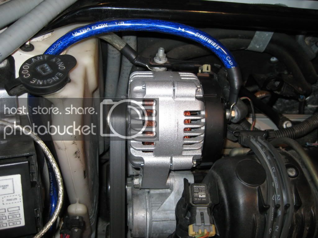

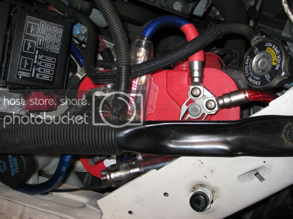

iraggi 220 amp alt
red top up front deka 9a31 in rear
big three in streetwires 1/0
run back of pos and neg in Knu Kollosus 1/0

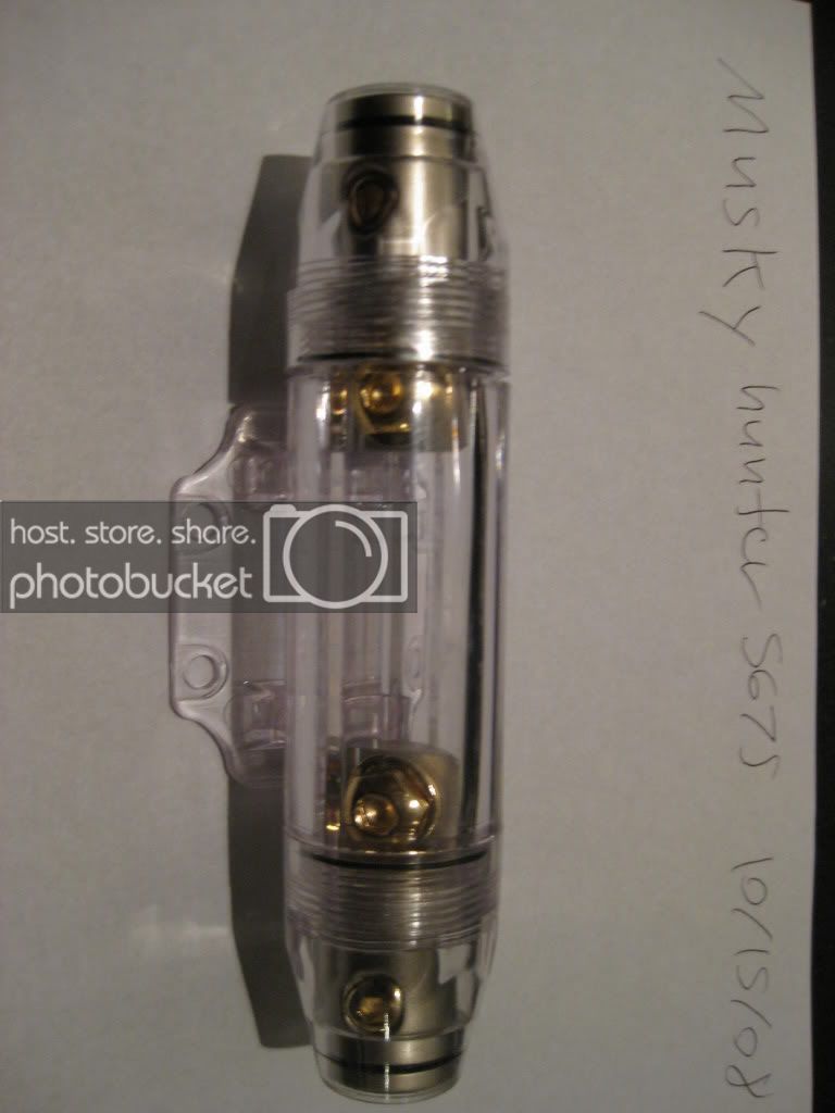

P3 1/0 gauge fuses,
fuses L.E.D. ed up

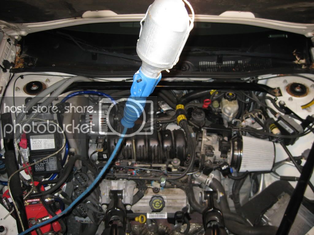

Sad stock motor, all ive got on it is a 220 iraggi alt, red top and generic air filter, other than that all i did was better plugs, wires, shes on castrol syntec and KnN oil filters every oil change
Iraggi 220 still have to get it tested to see what kind of numbers it does
red top, barley fits, but gets the job done

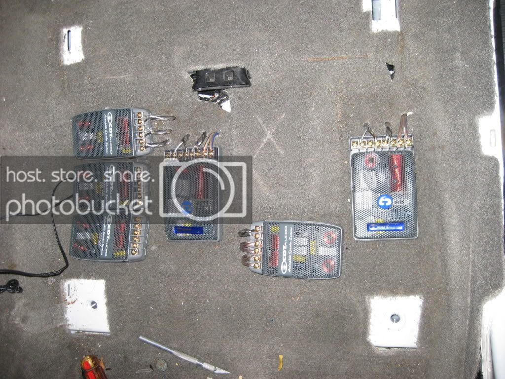

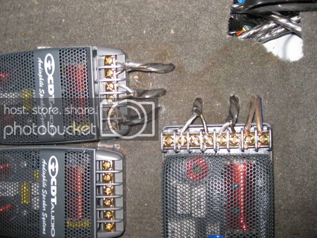

cross overs under passenger seat, 4 for the CDT 6.5 comps and two bigs ones for the CDT upstage tweeter kit
close up ran the wires under the carpet, i was stabbing it with a knife to make the holes and i did not realize that theres some airbag thing under there, oopps

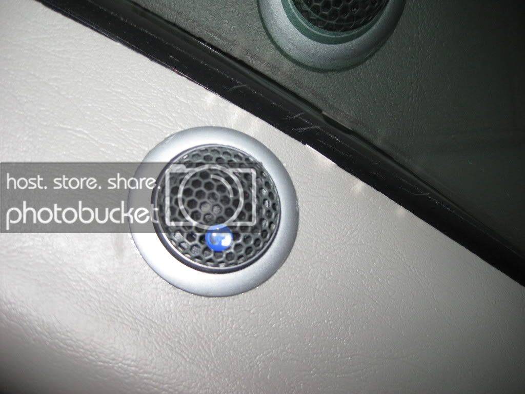

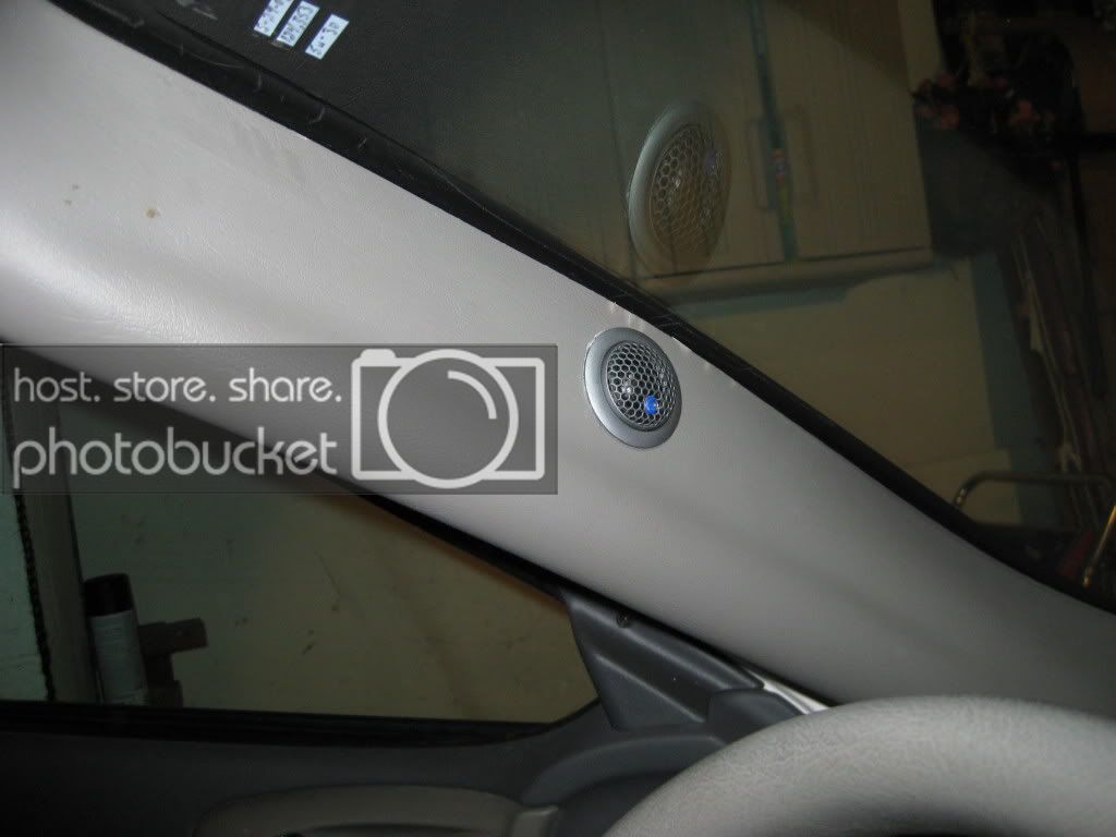

Front right upstage tweeter

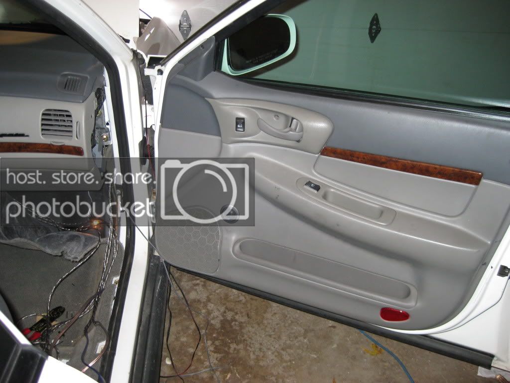

i made some white marks on the side from prying the foam out with a screw driver, the others sides better

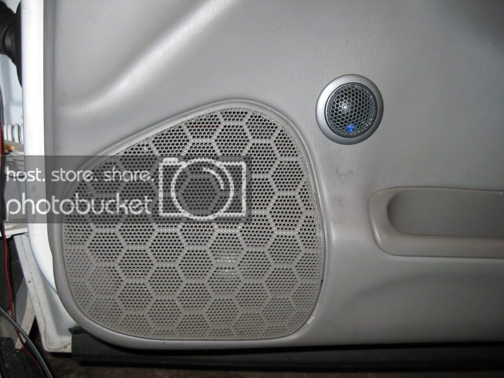

passenger door, i made a mdf bracket for the woofers and fit them behind stock grills and stuck the tweeter in there
close up, i like them because they look pretty stock

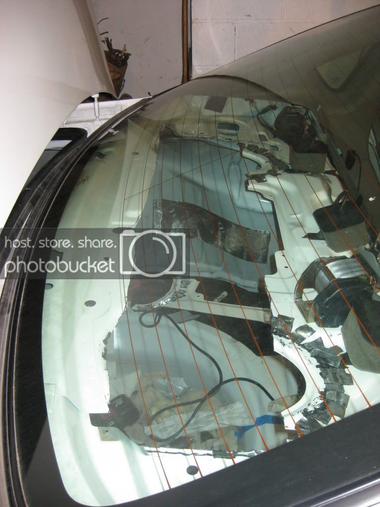

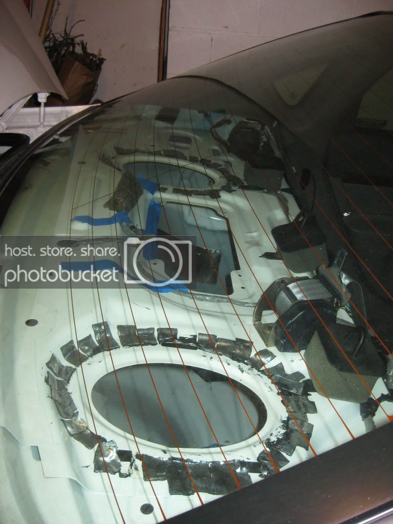

before
after, its for the port to come through the rear deck
how to make a cut really close to your rear windshield and not break it, really really good idea, //content.invisioncic.com/y282845/emoticons/crap.gif.7f4dd41e3e9b23fbd170a1ee6f65cecc.gif

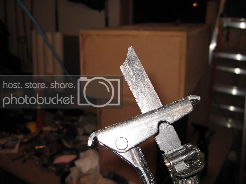

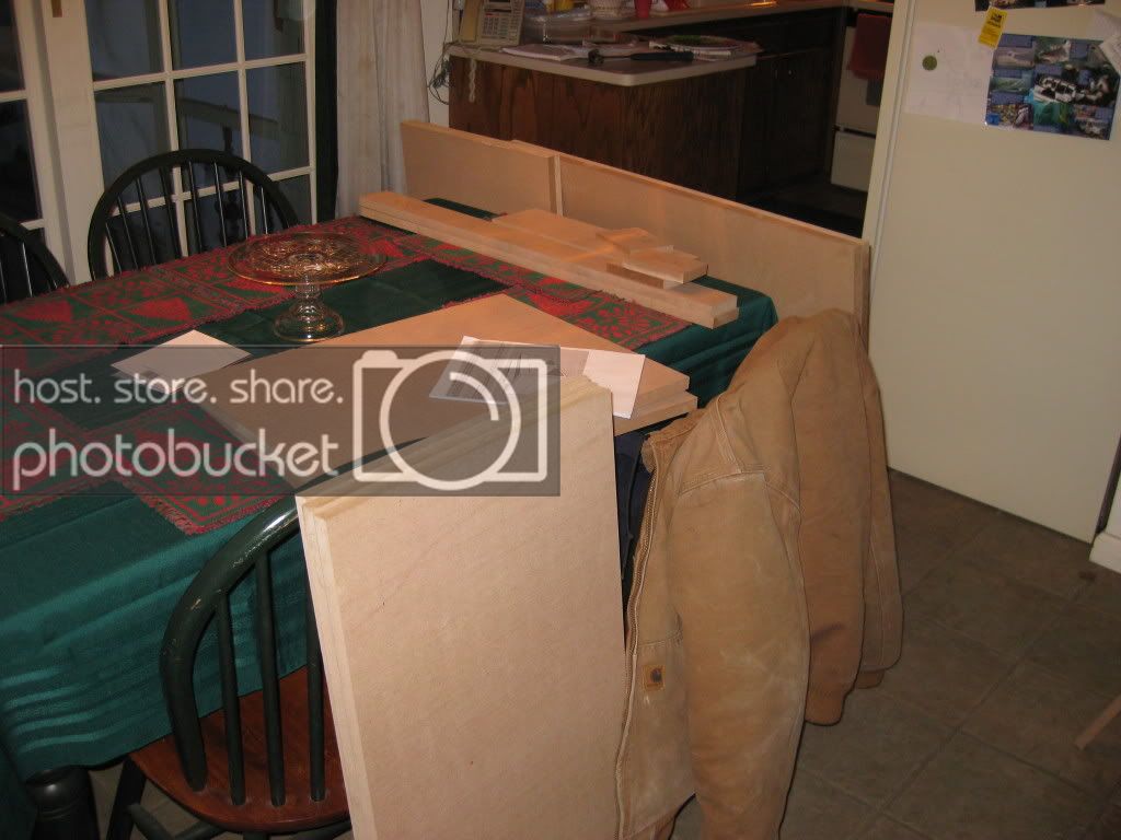

the box, its big

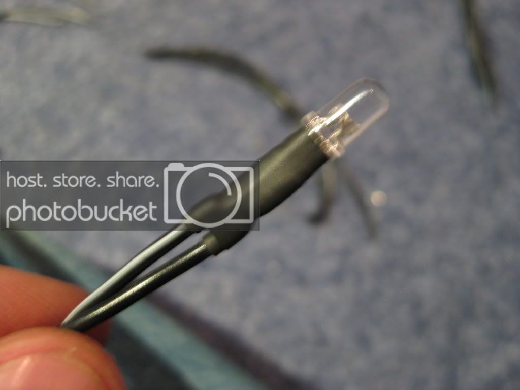

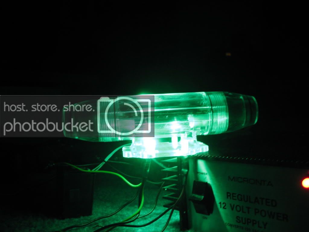

LEDs i made for really cheap

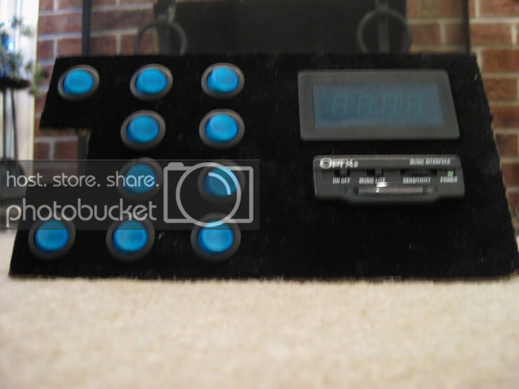

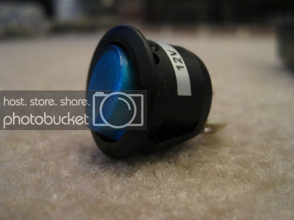

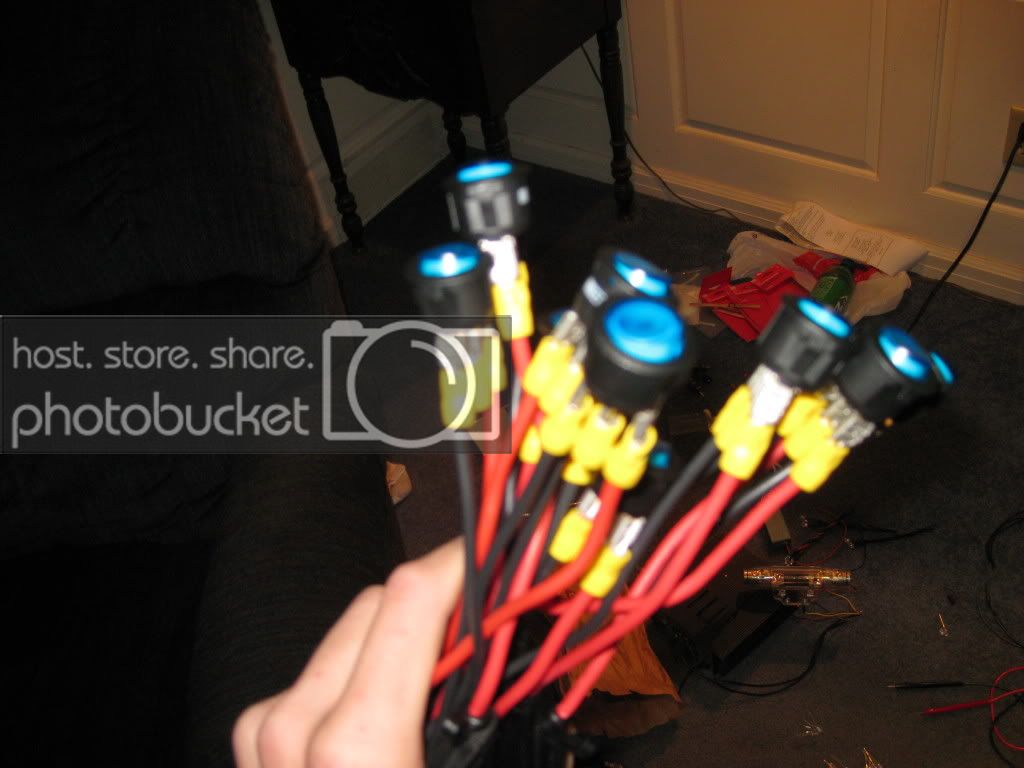

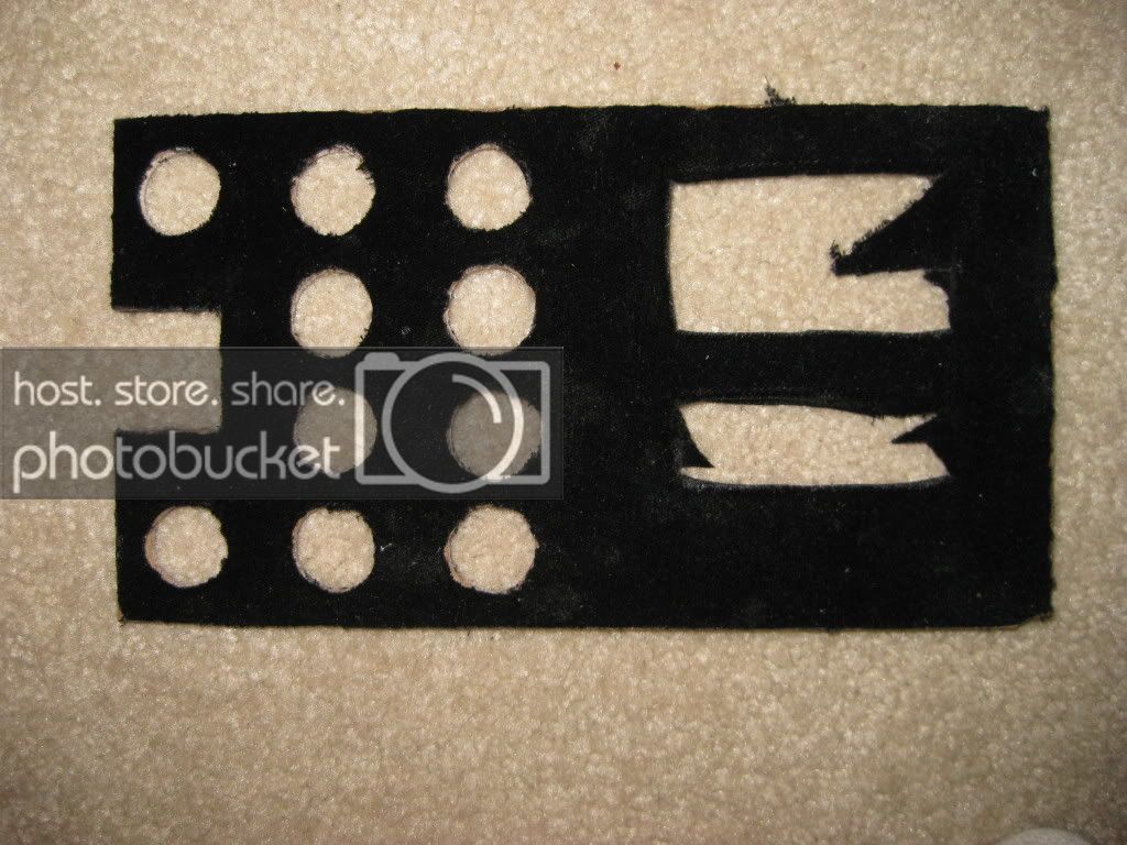

Switches for the COMMAND CENTER
command center cutout
switches
the whole deal with music interface and voltmeter
got the box cut out and i got it primed just got to paint it and start putting it in thats all for now

4 cdt classic 6.5 comps with t-24 tweets with the cdt upstage module upstage
tweets in the a-pillars

yea im going as slow as a snail but this thing should be good when its done, im dryfitting it together with L-brackets and then i can make sure all the sides are snug, and then i figure everything will be lined up and my port will be exact to specs, and then i just put it in my trunk, reline up all the l bracket holes and put em back in, bolt the crap out of it, and then fiberglass that puppy down really good, il get up pics in a few days,
do you get enough power out of the alternator with the loose belt? the tension gauge lines on the tensioner are out of line. You need a smaller belt or some washers under the back end.
