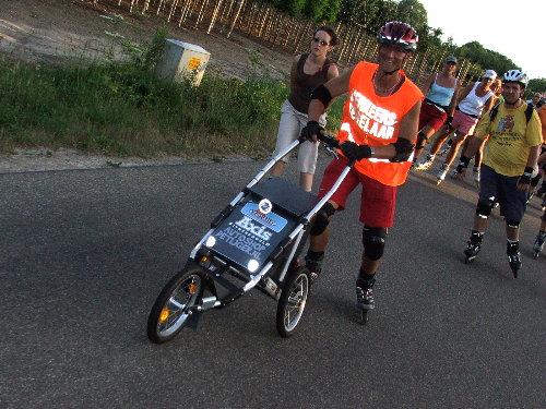

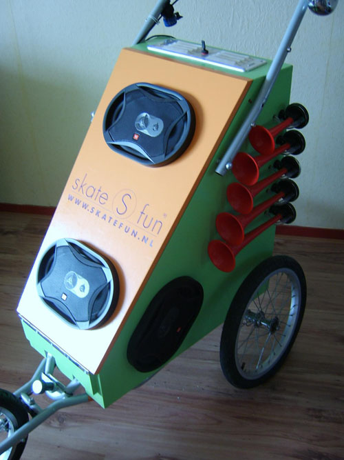

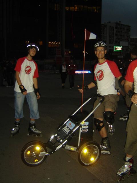

My inline-skating club is wanting to build a music stroller which is basically a battery powered mobile music system that you push around //content.invisioncic.com/y282845/emoticons/wink.gif.608e3ea05f1a9f98611af0861652f8fb.gif
Here's some examples I found online to give you an idea of what I'm talking about.
