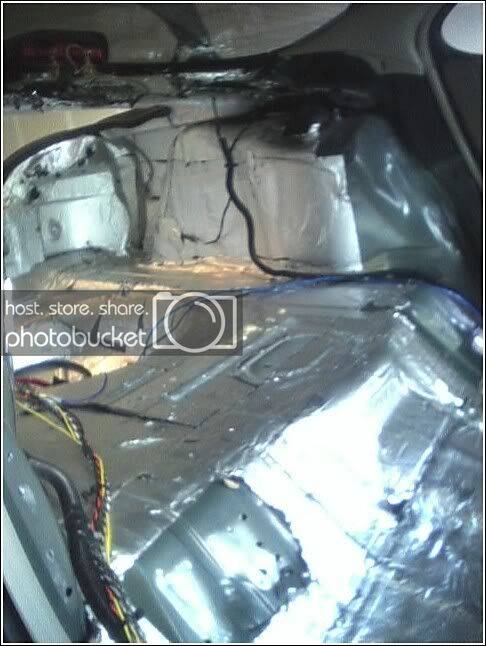

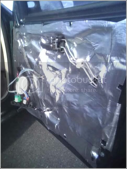

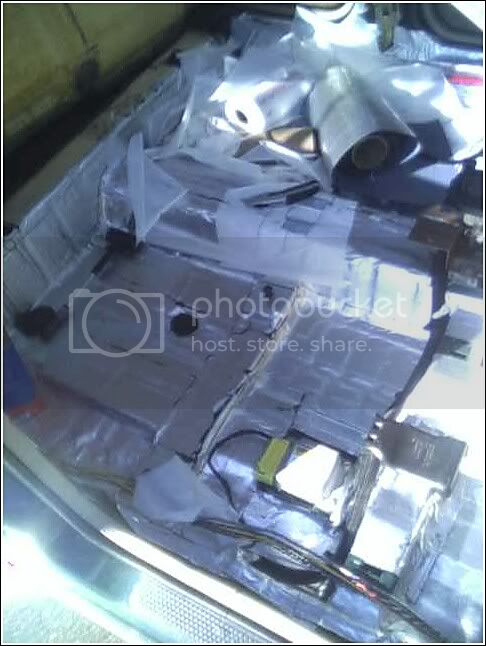

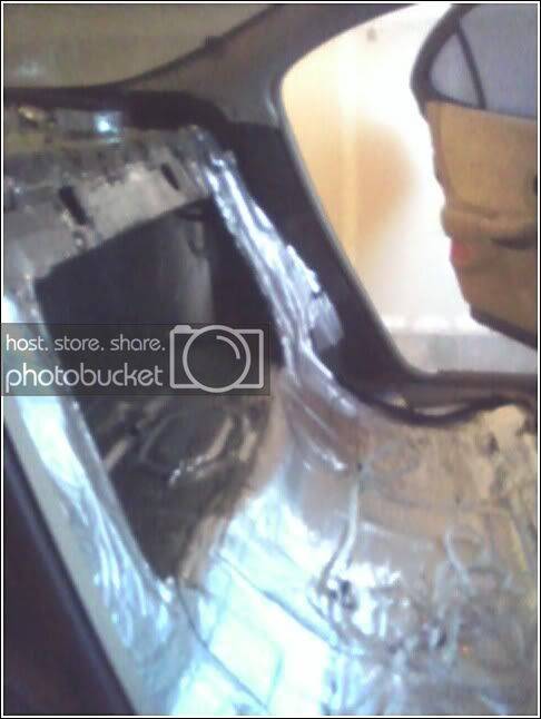

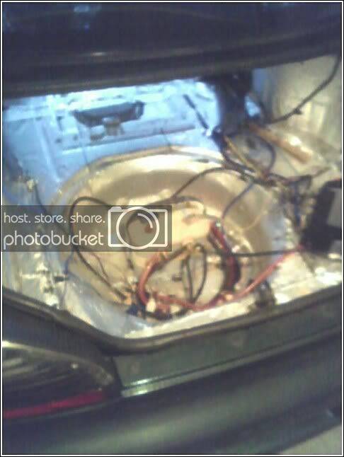

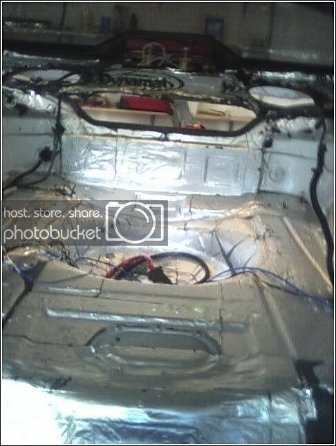

I used 250 sq ft in my car. Works and sticks great. Don't listen to people who hate on products they have no experience with. Just make sure to clean the surface with denatured alcohol first.
Also, it was 40 degrees outside when I did this and I had absolutely no problems getting it to stick.
Thats pretty much what mine will look like once i raise some more money. except mine will have a layer of black v3 over it. My car is black and it would look better. I dont think 75 sq ft will cover more than my door panels and my trunk.
How much quieter is it in there? how many layers?
