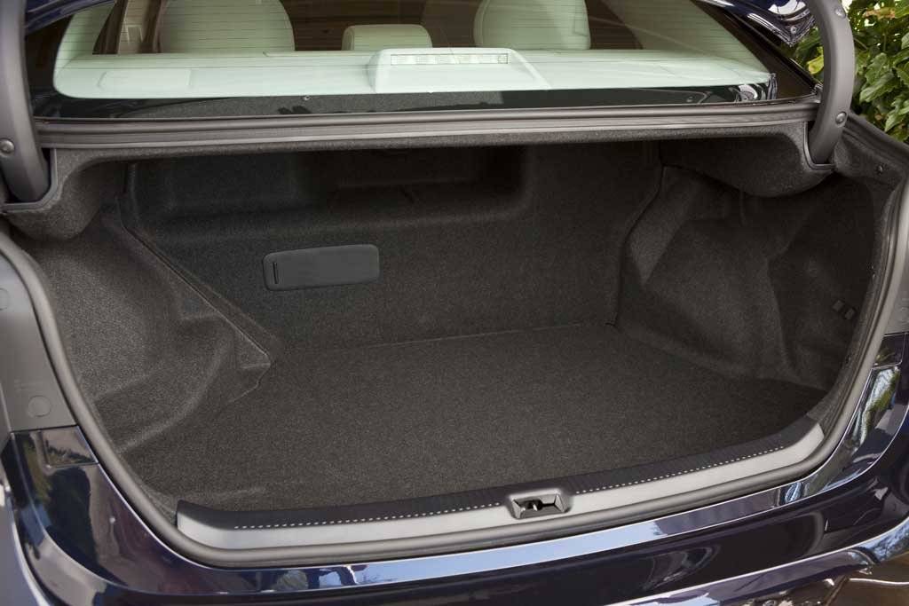

I have a factory 8in free air sub in my rear deck.
I was thinking about adding a after market sub. I can go the standard route and put a box in the trunk, or... I was wondering what it would be like if I switched out the factory sub for a aftermarket, added a better amp, and tried to mount a smaller, light enclosure to the bottom of the deck. I'm guessing alittle fabrication would be needed, but in the end I lose no trunk space and come up with a somewhat stealth install.

Alot of the trunk is lost due to the hybrid battery being being the seat. I think that 'cubby' is just below the factory 8, and just above the hybrid battery. In a perfect world the 8in enclosure would sit perfectly in there.
I'm new to this but my opinion would be to use 1/2 wood to keep as much enclosure volume. Plenty of shallow mount subs to choose from. If I had to guess you have about .5cu ft there after wood and sub displacement. Take off the rear deck cover and bolt the box to the bottom of the deck. You can put the driver deeper in the box with an extra piece of wood on the baffle, so sub will mount to the first piece than the second piece will act as a spacer and give enclosure more rigidity.good luck and post back pictures
