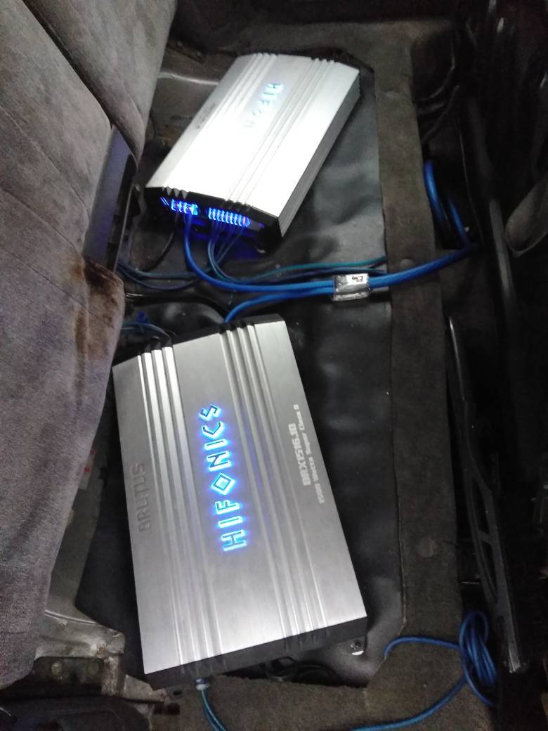

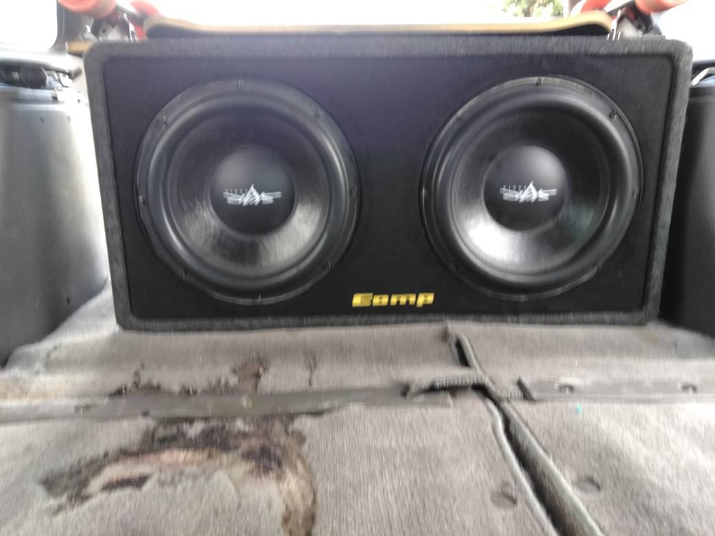

I'm trying to decide to just either seal both of the subs burn don't want to lose my output. So in wanted a ported box to be around 30-34hz but every box design I end up with is crap. They're running at 1000wrms together at 1ohm from a hifonics Brutus 1516. The box i have now is starting to fall apart and it's slowly sounding more and more like **** everyday. So opinions on just sealing the subs or can somebody help me out with a box design. Car, 1991 Subaru legacy Wagon and they'll be right behind the back seats, the seats are down and will stay down.

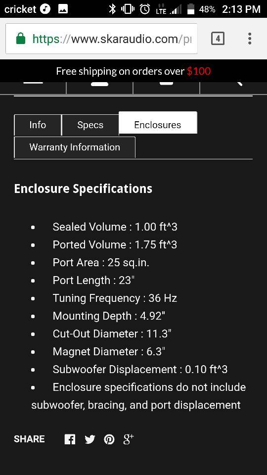

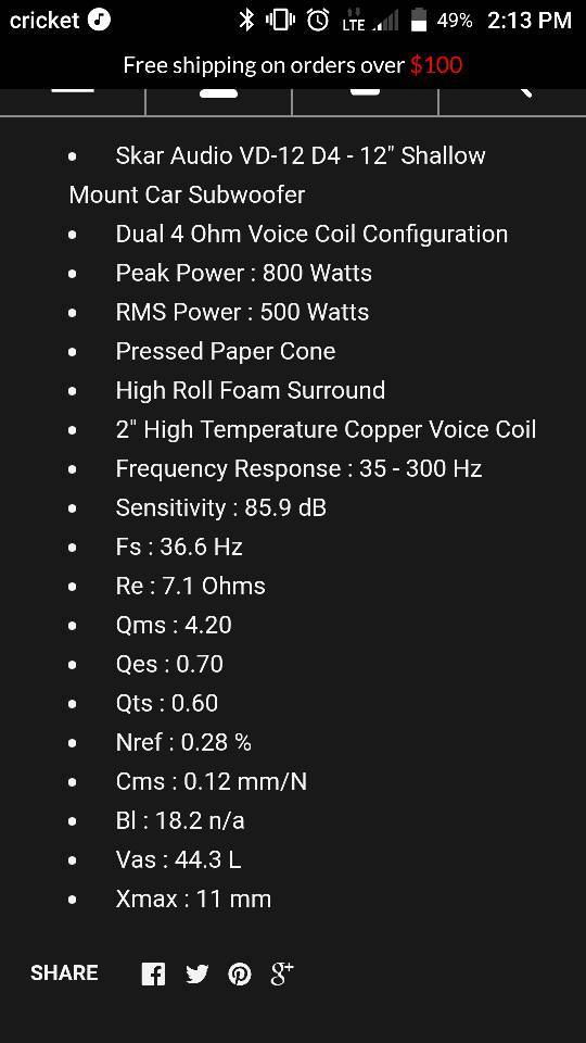

Each sub from the manu says it needs about 1.75cu ft per sub. So right around 4cu ft is great thanks! Can you can up a slot port design too? I wanna build it myself...
