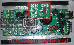

alright so i got a d2 sub that i wanna buy and would go down to d1ohm
so ima mod my 1501d amp
ill take pictures and hopefully you guys can help me do correctly
and also i can take pictures and document what you gotta do.
alright so heres my amp
heres it with the top off and where the chip is
you want to take off the Q chip not the D
Also, the compression circuit is a little white button next to the rca end of the amp. It needs to be pushed in the "out" position.
alright so some info from others
all from the man himself
"Modding it is pretty easy if you're familiar with removing circuits with a soldering iron. You have to remove resistor Q240 from the board and release the compression circuit."
"q 240 is located in the south west quadrant of the amp... you have to be careful to not remove d240 that is right beside it. Also, the compression circuit is a little white button next to the rca end of the amp. It needs to be pushed in the "out" position. "
"They dont do it from the factory because the chip you remove is the part of the protection circuitry that shuts the amp down if it see's a load below 2 ohms (ie dead short) so when modded you have to be careful not to touch the speaker leads together while the amp is on, or you will short it out. And yes, the mod will allow up to 18.5 dc volts and down as low as you feel comfortable on impedance... I wouldnt suggest any lower than .5 for daily. "

yea but nobody has any pictures to show. only found 1 from roei think it'd be easier with pictures so ima just document mine
