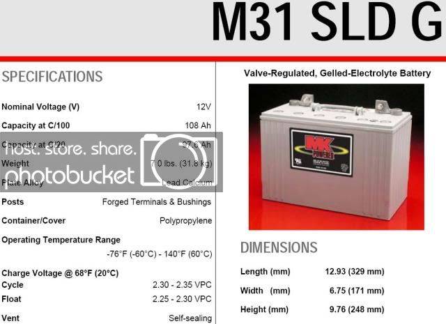

spl_robb 10+ year member Member 124 0 SD Jul 8, 2009 #1 are MK powered batteryes any good?? a electric shop around my place has one for 60dlls (used) specs Click to read more...

audiolife 5,000+ posts WhAt? 15,916 25 indiana Jul 8, 2009 #2 if its gelled and not AGM i would be worried. gel tends to be very slow on discharge
Horsemanwill 10+ year member CarAudio.com Veteran 3,000 16 Junction City, Kansas Jul 8, 2009 #3 looks like an SVR battery i think they are the same guys http://www.svrbatteries.com/ i've ran an old svr 28-12 for a few years now with no probs. if the batt is used make sure you have it tested with a load on it so that you know it works good.
OP spl_robb 10+ year member Member 124 0 SD Jul 9, 2009 Thread Starter #4 the guy tested and it rests at 12.64v and on his meter it showed good in the amp zone thanks guys.
