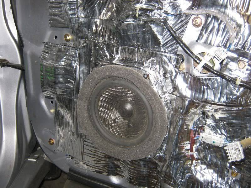

the issue here is not the speakers. it's extremely common.
the reason? seals.
no, not the kind that get eaten by sharks as narrated by Sigourney Weaver.
the kind of seals created with perfectly crafted mounts and foam weatherstripping.
what you need to do is recreate the factory seals. these exist in two main locations.
1. between the woofer and the metal.
2. between the woofer and teh plastic door panel grill opening.
#2 is usually missed.
the door panel acts as the front baffle of the enclosure since the door metal has huge holes in it. the rear wave from the speaker combines with the front - cancelling it out.
midbass/bass is all about seals and isolating front from rear.

Thank you for taking this to the next level of understanding....and this too falls on the installers for an improper install, if they did not replicate the OEM install using the aftermarket speakers.
OP, goto lowes/HD and pick up 10' of some nice 3/4" weatherstripping for like 4 bucks. Then head on over to audiotechnix.com and grab some 60 mil b-stock for like $58 shipped.
most installers won't go through the extra effort. it's $60/hr for custom work like sealing doors. if you go back and want additional seals, expect to pay for it.
your best bet is to DIY. this stuff is easy.
here is a thread i've added a lot of door speaker installation pics to
Installing door speakers and sound deadening and more - Honda Accord Forum - Honda Accord Enthusiast Forums
this is what i mean about seals and foam:
