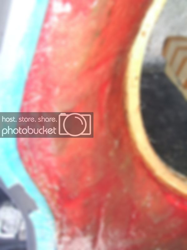

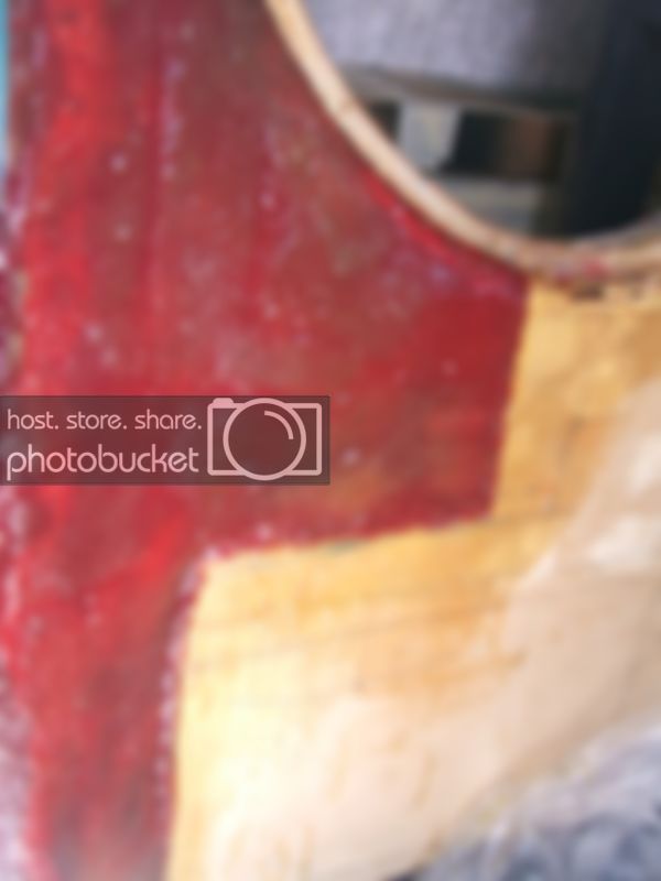

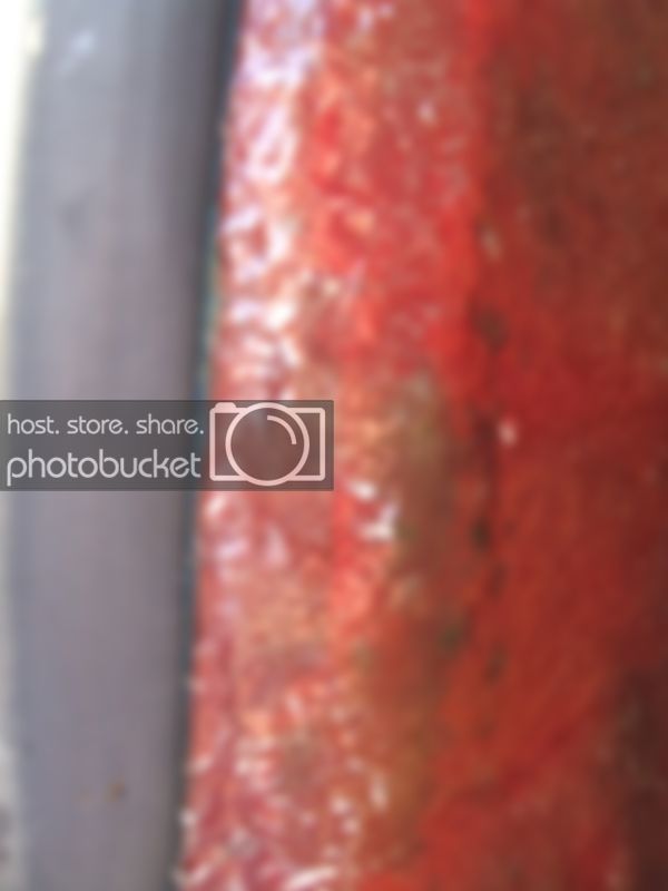

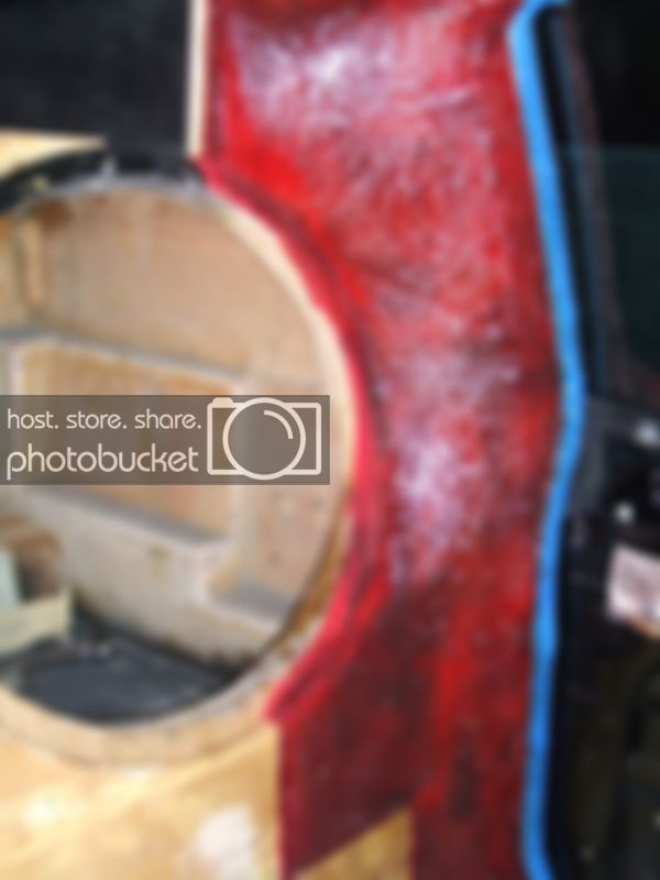

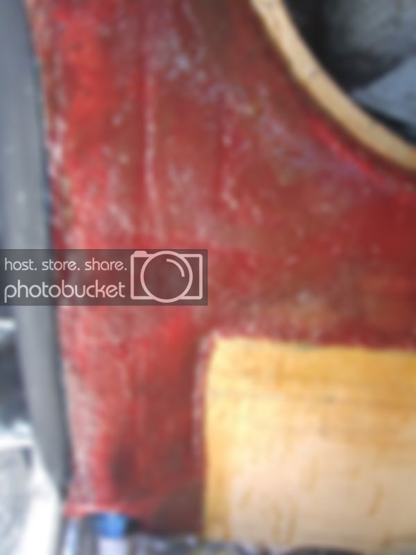

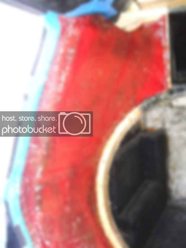

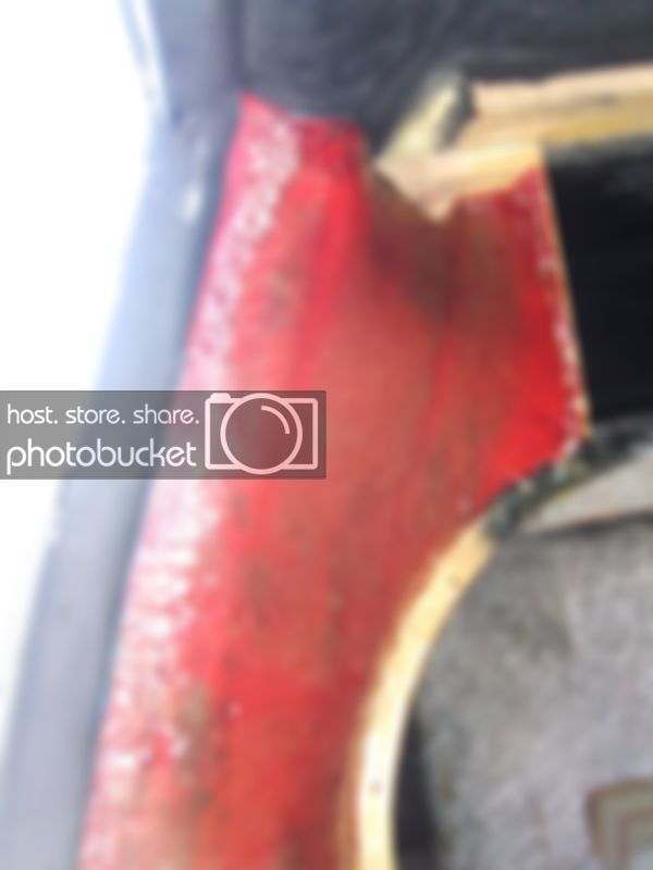

I applied resin to the side panels on the wall (that red fleece) and it came out pretty good. Still soft spots, need to put another layer or 2 of resin which ill do now when I get off before it gets too hot outside lol
Don't really wanna put mat down becuase then its gonna need more sanding etc rather than just the fleece + resin.
Pics later.
I bought some mat, ill add that tomorow
Thought about putting some expanding foam behind it, but it may buldge out and f everything up
it most likely will.
i used a little expanding foam for a cavity in my rear dash panel that is covered with a glassed top side panel. overnight the foam expanded more than i wanted and lifted a section of the glassed panel i had to cut out the foam and 2part epoxy the lifted area back in place. and this is with a glassed surface of 5 layers.
if you do want to add foam, glass it to where it's solid as hell. and add a little.
