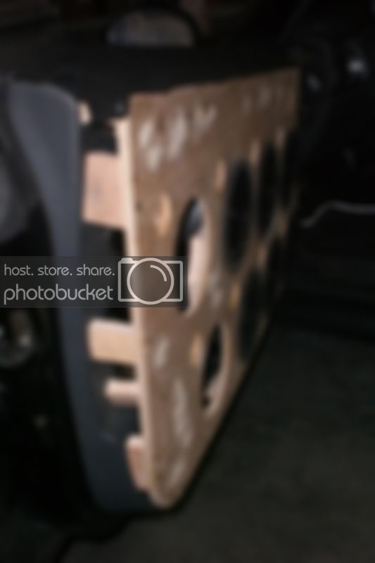

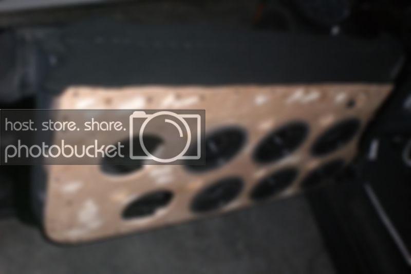

filled a few holes. ima take the speakers out and finish up this panel tomorow. then i just gotta do it again, for the passenger side.

started fleecing...robin, i will prally need your help. this is one thing im not good at. i hate fleecing and i hate glassing.
maybe thats why the inside of my box still isnt finished glassed.........

you are gonna have to wrap it around the back of the panel, otherwise it will just fall off
pull that shit off and try it again.
dont have to resin the front, but you should stretch fleece across the whole thing, and glass up to the edges of the wood panel
use hot glue to wrap it around the panel, otherwise it wont be tight enough
and those staples and all that bullshit you have going on, will show.\
a lot.
a lot.
Word. ^
Your gonna want to cover the whole thing for strength, definitely. Wrapping it around the edge will also keep from having any adhesion problems, since the resin doesnt like to stick to plastic.
I would wrap fleece around the whole thing, glue and staple where necessary. Then I would resin it down. Let it cure, do a sand, then do ~2 layers of mat/cloth (mainly around the edges). More sanding, then cover them how you want.
