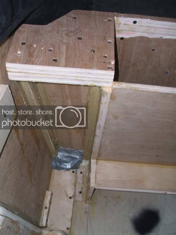

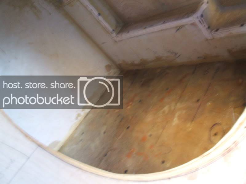

did a little bit today
tomorow im gonna glass the entire rest of the box, but i wanted to get it glassed up in the corners first, let it harden (which is hard as a rock now) then tomorow ill put a 2nd layer over that while i coat the rest of the box.

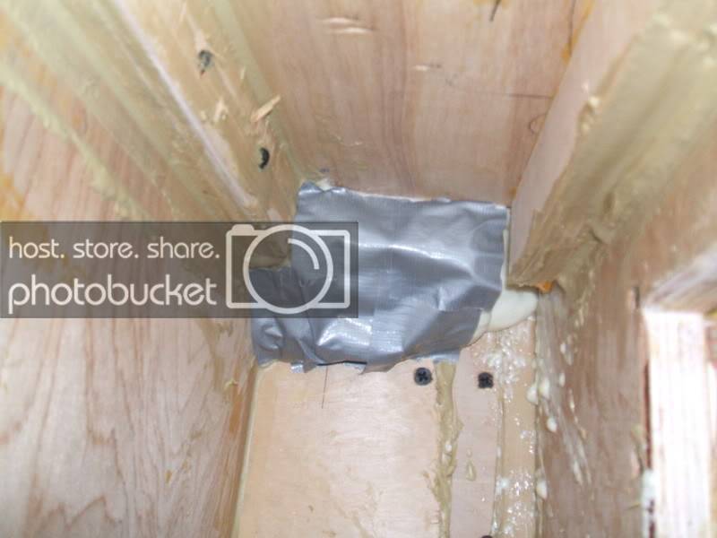

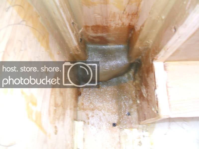

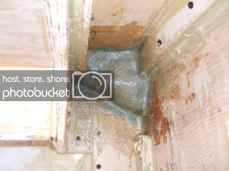

foamed it up first

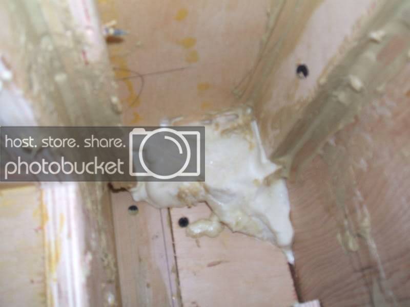

then taped it up. i used a special anti-Darrell solution. this is an inside joke between me and robin, about a fat dude that works at my job (robin used to work there)

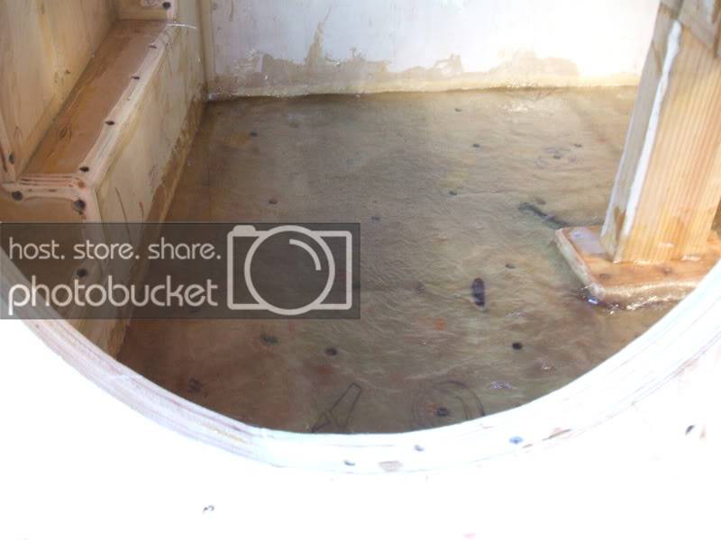

and finally, glassed

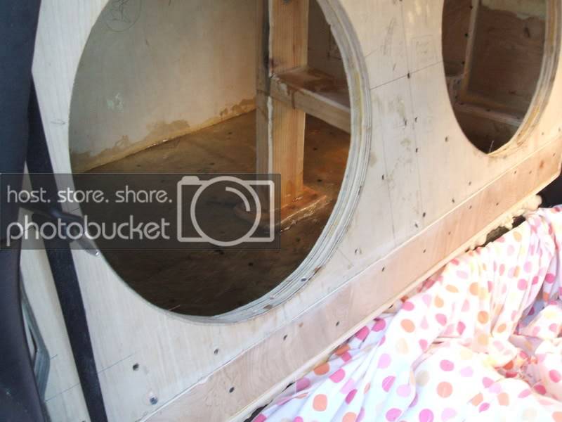

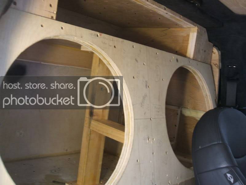

baffle = on for good.

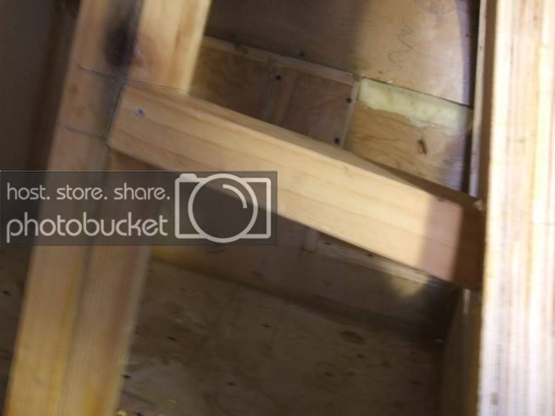

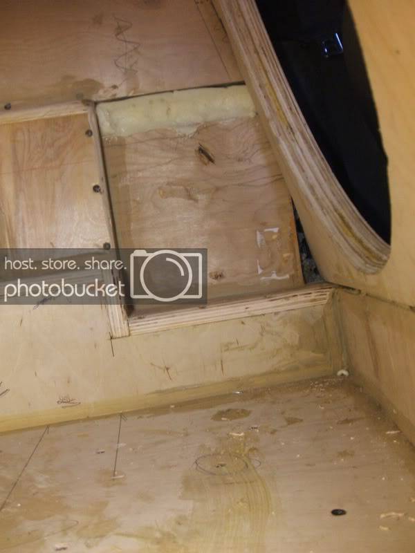

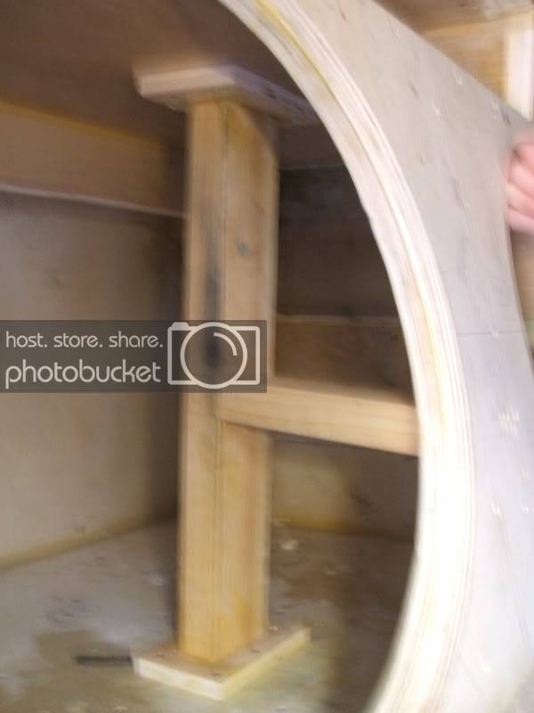

braced it, and the port. the 2x4 really helped the bottom of the port.

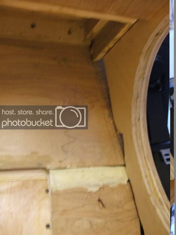

and the gaps that need to be sealed up with wood first, then glassed over.
