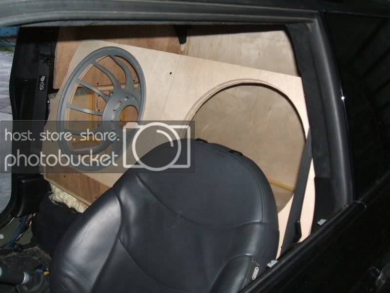

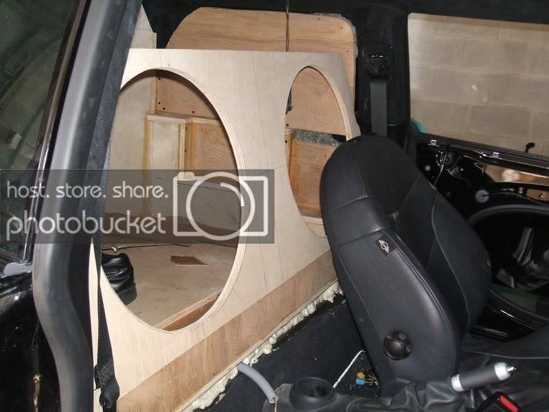

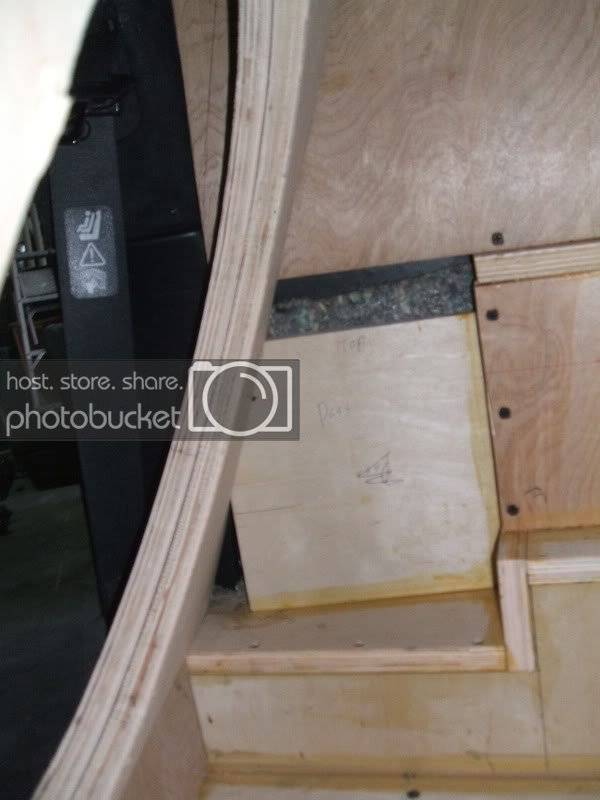

will be 2 layers thick, and a 3rd layer on the outside, which will be the flush panel/trim panel, and have a brace in the center of the 2 subs, from that point, to the floor.

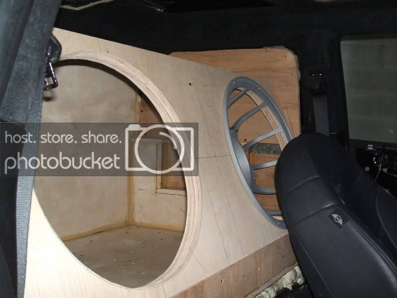

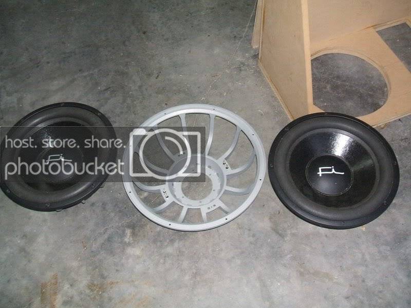

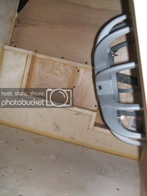

cut out the 2nd baffle. and test fit of the basket for the 18

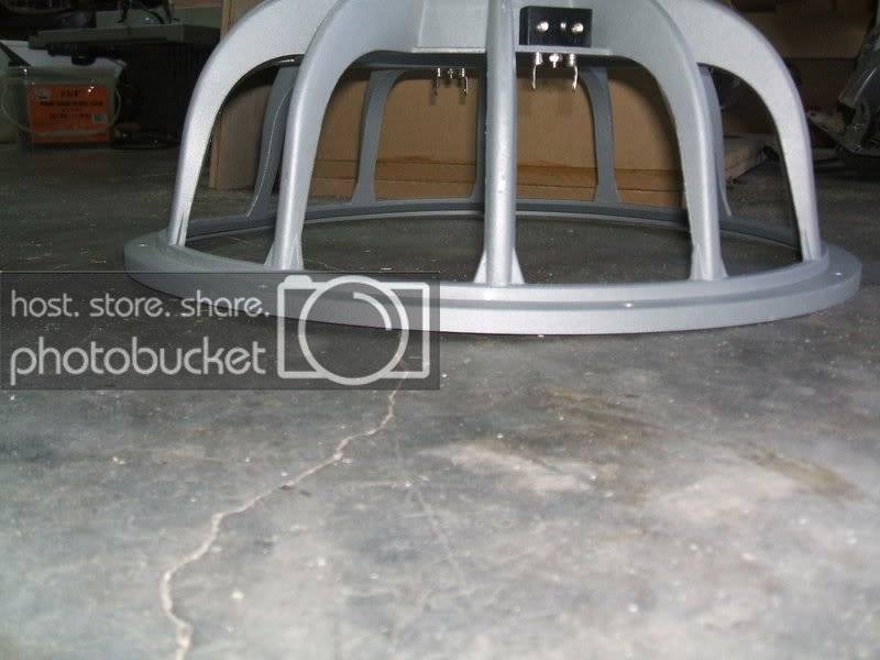

btw, its bent from the factory, so i gotta call up RE and see whats up...someone failed in china, LOL

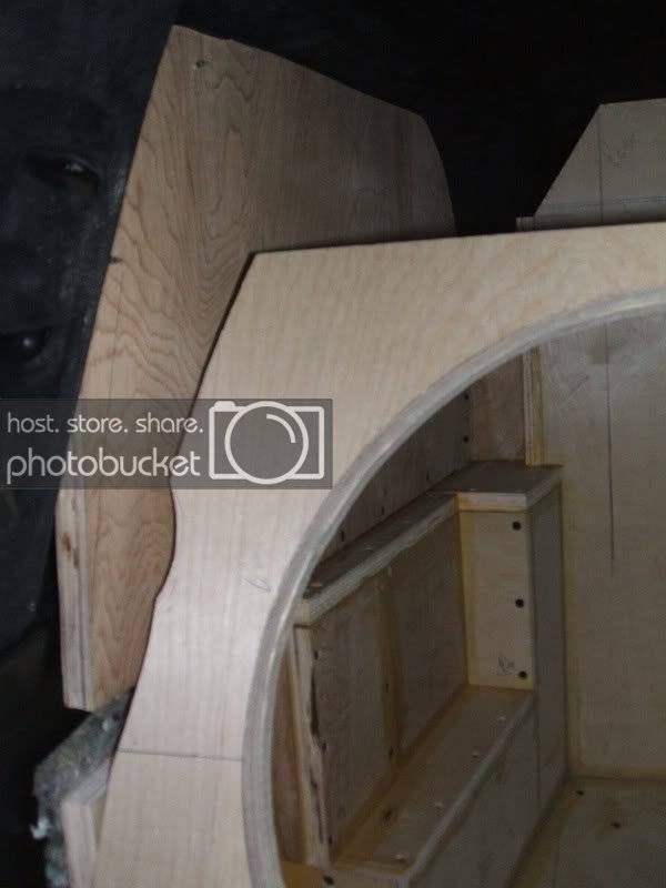

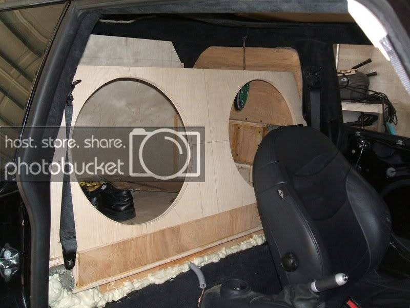

the money shot!

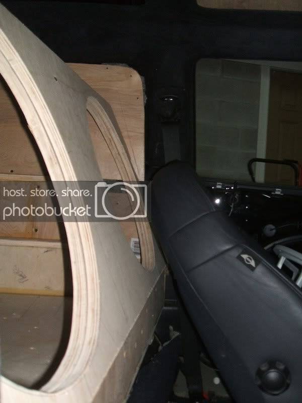

angle = 70 degrees

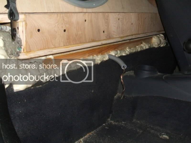

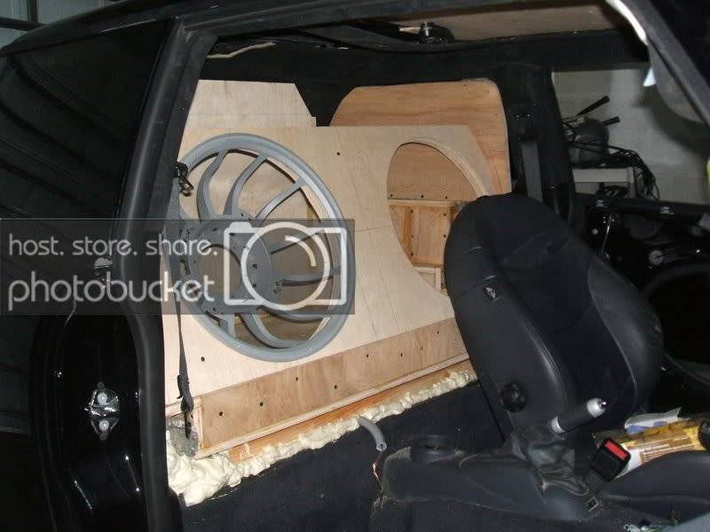

foamed up

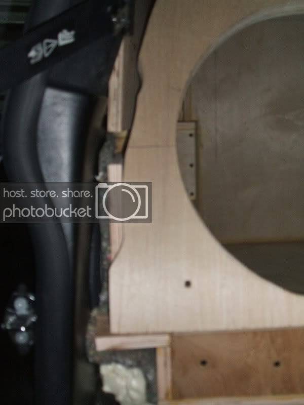

little gaps that need filling. no big deal,
had to cut it all funky looking, due to the B pillars being only about 45" wide from side to side, and the box is like 47"
trim panel will cover this
I cant lie, I didnt think that it was a good idea to put all this in a relative new car like the mini cooper.
But, seeing all the work going into it, I am seriously impressed. That is going to be extremely loud in that lil car. Nice job, and looking foward to the results!

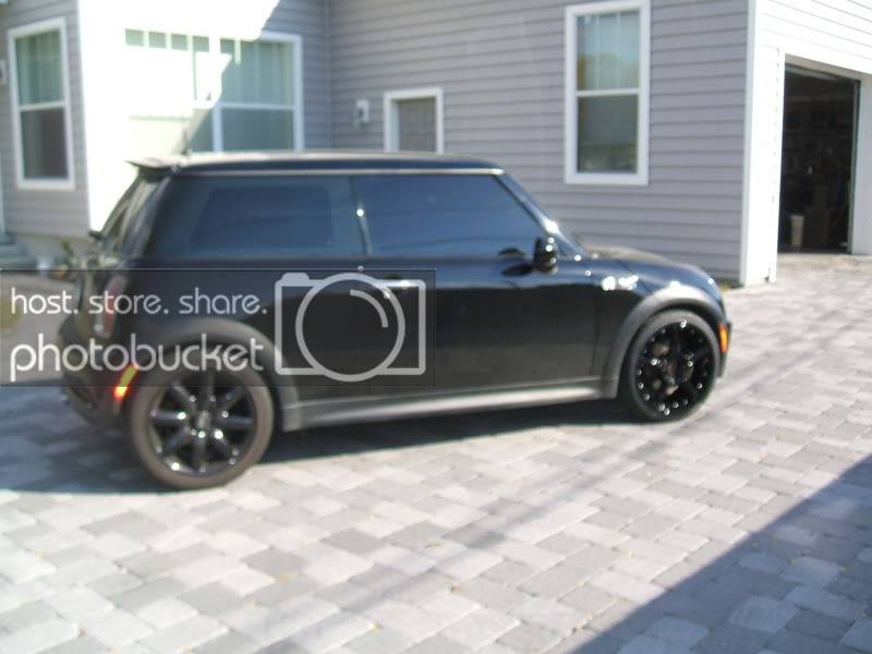

stock rims i had painted black
tint

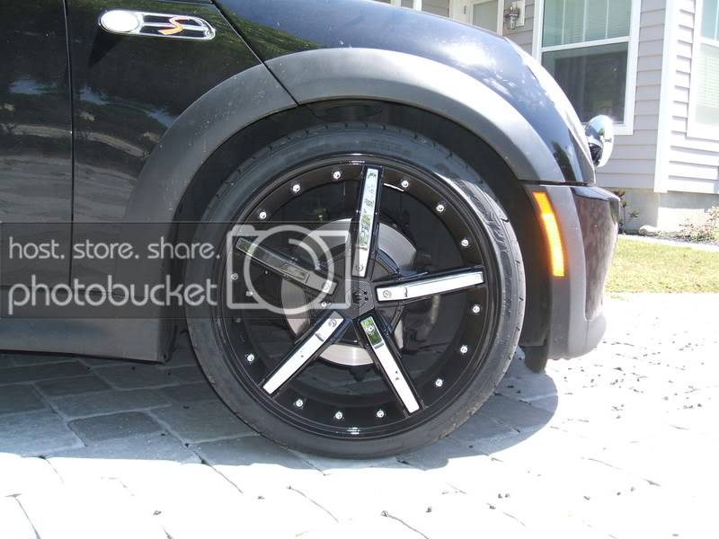

comparison, new 18s vs stock 17s, the 17s were VERY dirty, they look very good when they were clean, its just they were starting to chip (painted)
