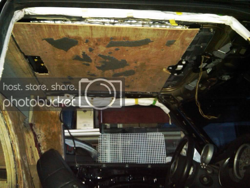

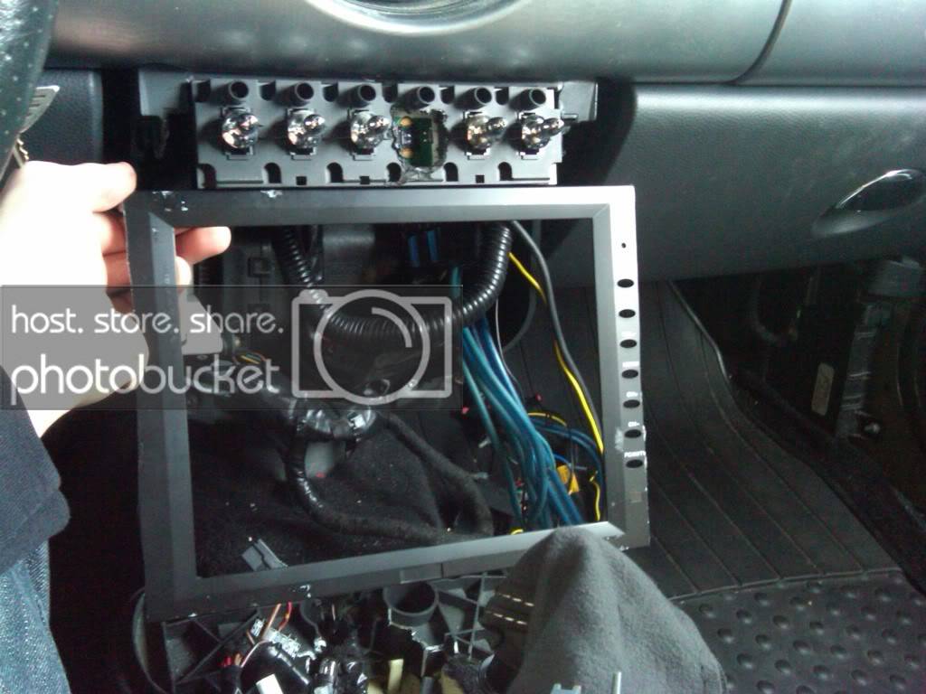

im taking the headliner out, and fiberglassing it, got a few things im gonna add to it, one thing being the a/c controls glassed in, and a 7" screen where the rear view mirror was, dont know what else, maybe some speakers lol

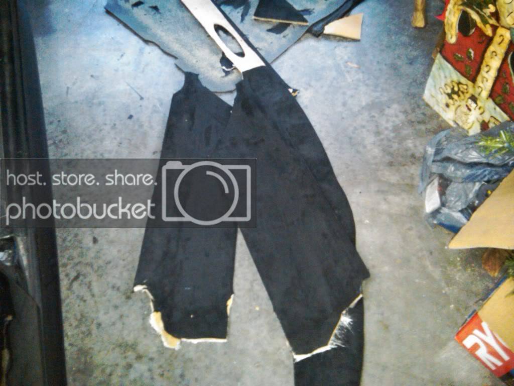

tore out the headliner
cut up the headliner

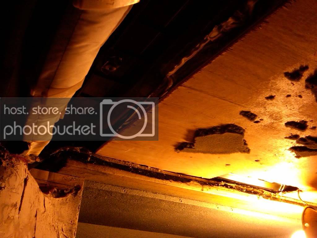

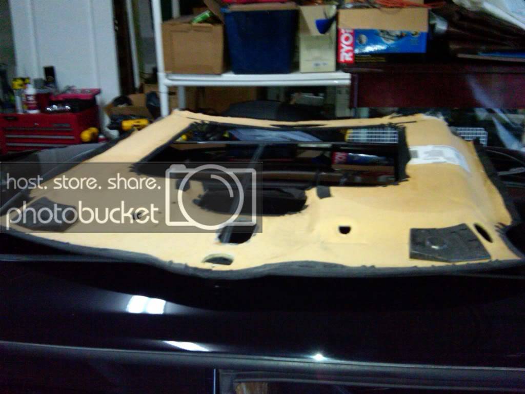

removed old suede and factory fabric, this is the bare fiberglass headliner

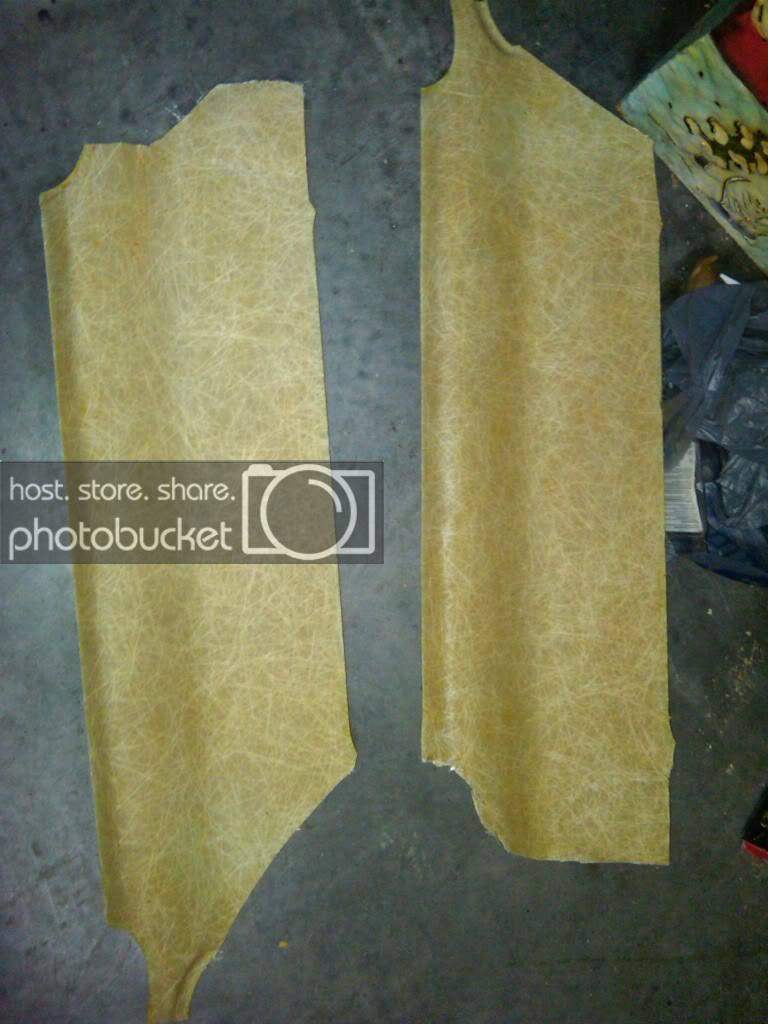

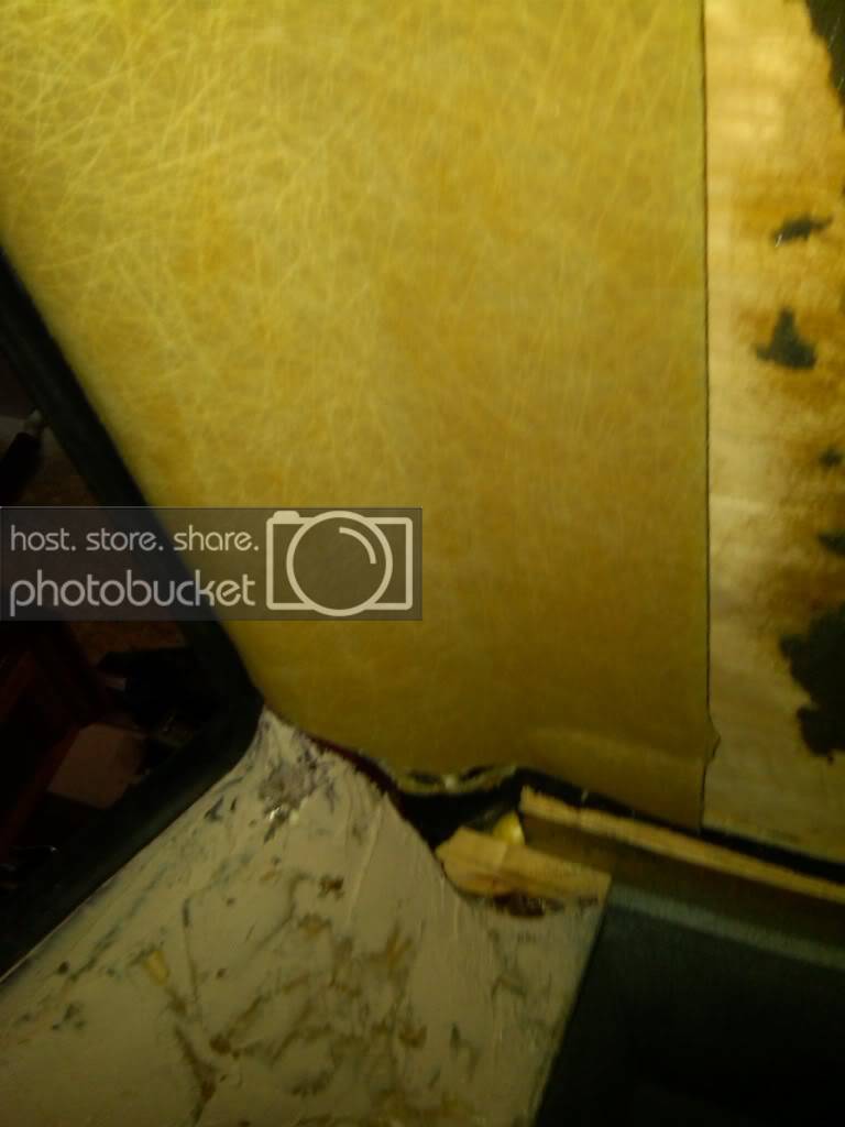

cut the sides like i did, so i can put them back in place, so it still has a nice factory edge where it meets the weatherstripping, and ill glass off of it from there.
the gap in between the headliner and my glassed side panels in this pic will be flushed together as one piece. i didnt like how it was so thats what prompted this idea to make a custom headliner. itll also house a 7" monitor for a backup cam, my a/c controls, and the factory interior dome light relocated to the front though. maybe a few other things, not sure yet. ideas are welcome.

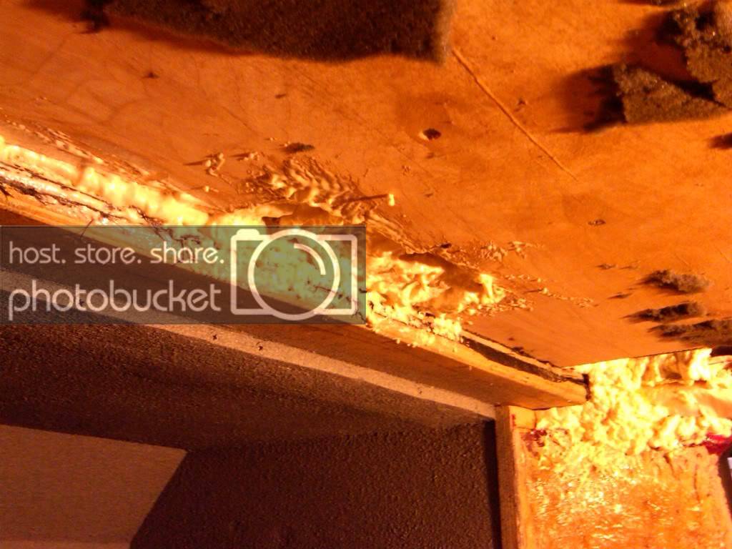

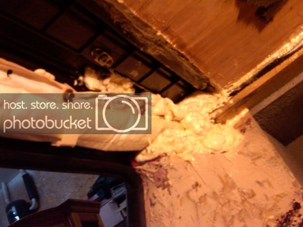

foaming up some gaps, gonna try and brace the roof the best i can before glassing the headliner in permanently, to avoid as much flex as possible. not TOO much can be done becuase of the sunroof (which isnt getting removed, im not going that far to have it welded shut etc..)

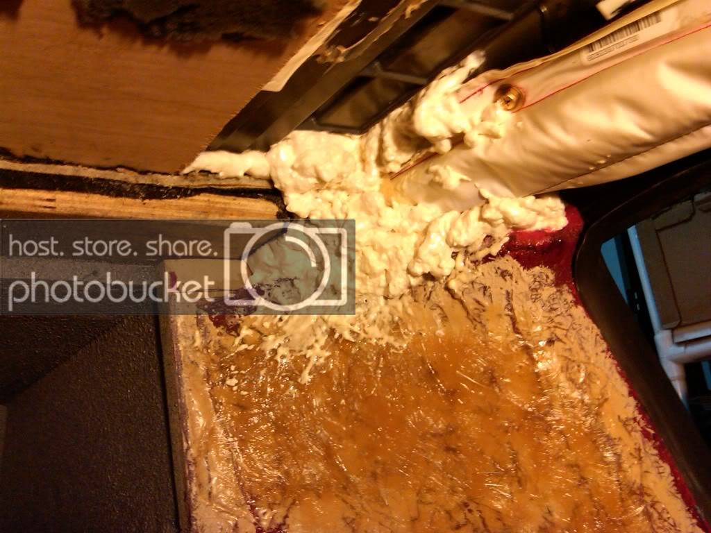

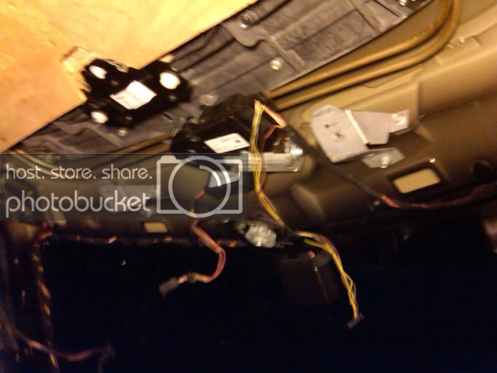

the white thing is the airbag, which should be disabled...if it ever goes off though all my work will go to poo //content.invisioncic.com/y282845/emoticons/frown.gif.a3531fa0534503350665a1e957861287.gif
alot of open space up front, gonna foam what i can and try and make that more solid as well

This might be the stupidest, most deadly idea Ive ever seen.
Not only will the air bag not deploy or function properly, but that mass of shit you loaded over it will now be coming at your body @ 200mph
You sir, fuked up
Disable that airbag
