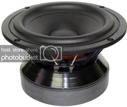

i also have the pro 60's.. midbass SUCKS.. almost non-existent as far as im concerned.. I have the doors all sound deadened, and have the speaker in a mini pod inside the door... love the midrange-vocals they give out... but the midbass blows
i tried to bridge em on my amp... they didnt even get louder, but yet they started to cut out...............??????????
If you really want some midbass output, run a lower power 8-10" shallow sub/woofer in you doors. They generally have less mms, so are more efficient, have better transient respoonse, and therefore have an easier time reproducing midbass than normal subs. They'll also be fairly efficient as well...at least more than a bigger coiled, higher xmax woofer.
here are couple to think about
Dayton RS225-4 , if you can make the room for a 8inch
Dayton RS180-4 again if you can make the room for a 7 inch
or
Peerless SLS 6.5
or
Morel CAW638 6
