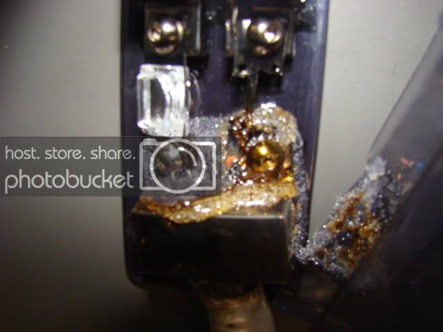

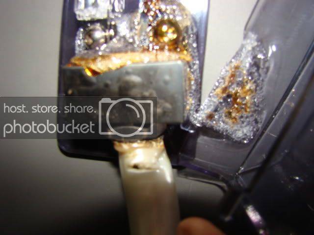

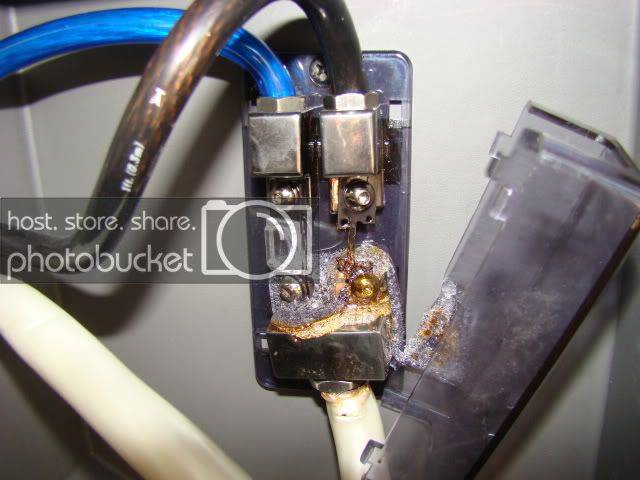

so ive got a bit of a problem here. Something went wrong with my KunKonceptz fused distribution block. its like the plastic liquified and bubbled over, the metal has some bubbles too, and the 1/0 closest to the kompression fittings is a little brown. though the fuses didnt blow, one of the plastic coverings melted as well, but did not blow.
does anyone know what could have happened? i guess it would be a good idea to replace the distribution block? should i call knuKonceptz, maybe get a replacement?
problem was a loose connection and it was arching and got hot. those compression fittings ****! when ever using 0g only use ring terminals and crimp and solder.
when ever you need 0g there is a need for alot of power so you have min 1 rear battery. go off the rear battery with ring terminals with a seperate anl holder with post type connections so you can use ring terminals, never a problem this way...
You probably passed the ratings of the fuses. Say a fuse is rated for 150a. Just because it sees 150.1a for a split second doesnt mean it will blow. Even if a good bit more passes through it for a bit it wont necessarily blow. They probably just got hot enough long enough to melt the actual fuse block without blowing the fuse.
Seen it happen a ton of times.
