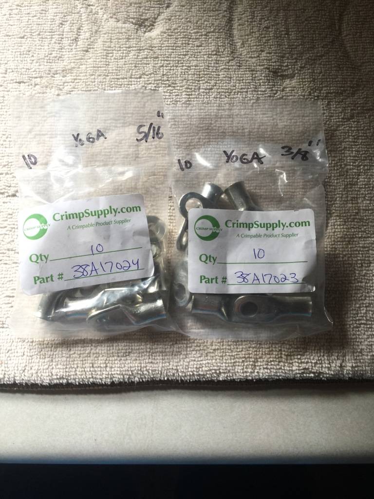

So I was hunting for copper lugs yesterday without much luck... The studs on my alt are 5/16 power and ground... The studs on my fuze block to battery are also 5/16 bolt studs... I can't find 1/0 5/16 lugs anywhere but the internet... Napa was still sold out of 1/0 lugs from the first time I big3'd my trucks so this is what I'm looking at
Copper Lugs, Heavy Duty Copper Lugs
I'm thinking about ordering their tinned copper lugs dubbed corrosion resistant... Only concern is will it have the same resistance/ transfer electrical energy just as well as plain solid copper lugs??
Anyone have any experience with these?

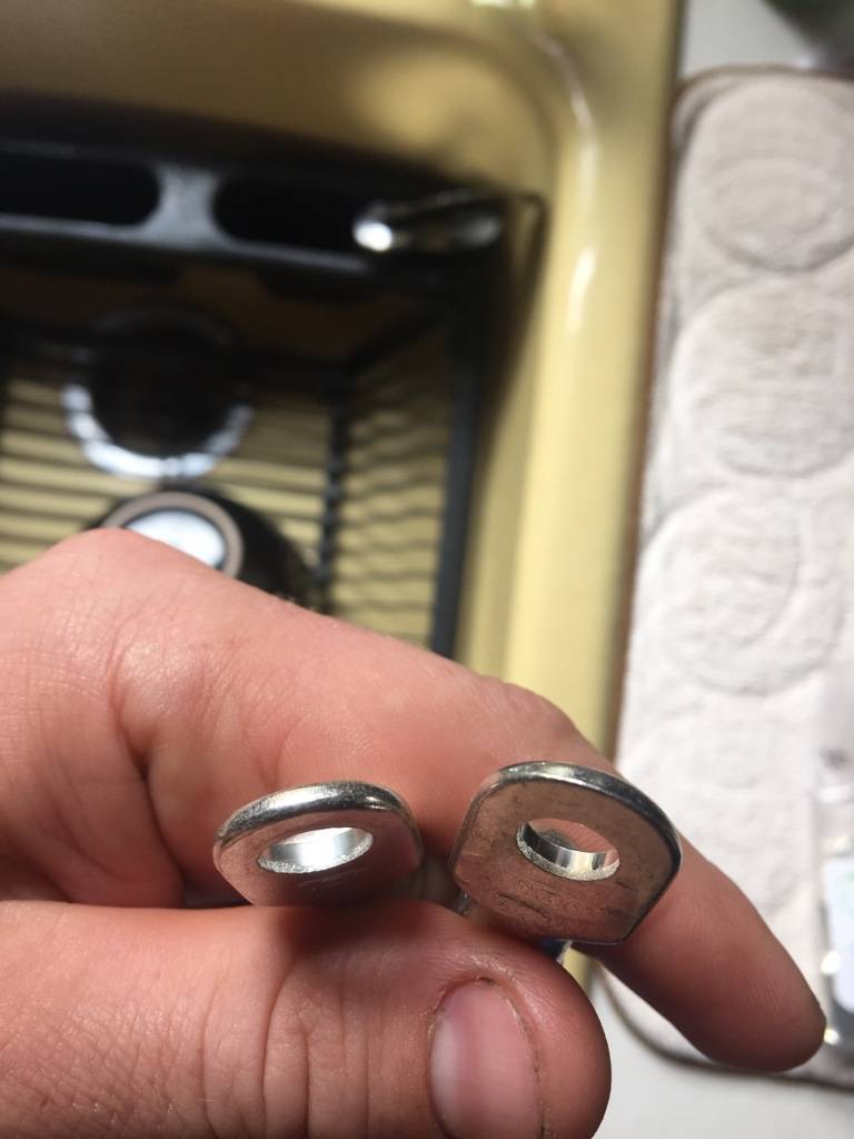

if the studs are too small just drill them out, ive had to do that for almost all my lugs.
The problem is that all lugs I were able to find had a 3/8 stud hole and was too big I want my lugs snug on all connections
my bad that makes more sense. i have some lugs that are larger than the hole and they're not lose but im pretty persistent about keeping terminals tight
Yea I just feel with my 370a alt the more surface area making connection/ the tighter the lug fits on the stud the better electrical transfer I will get... I could be wrong but whatever lol I ordered from crimp supply. Company based out of Michigan... They should be here Friday
