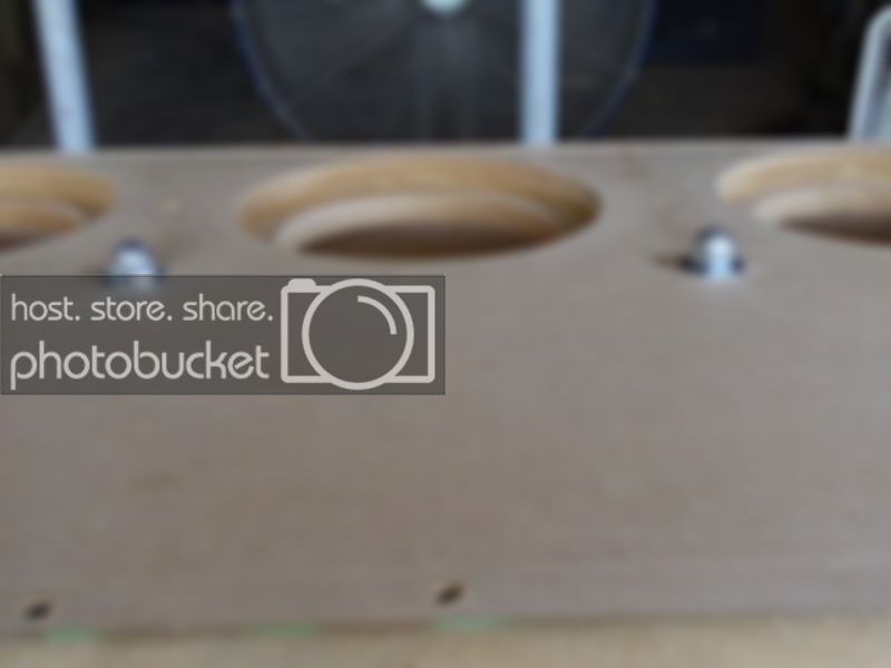

Box is done. Here are some more pics.

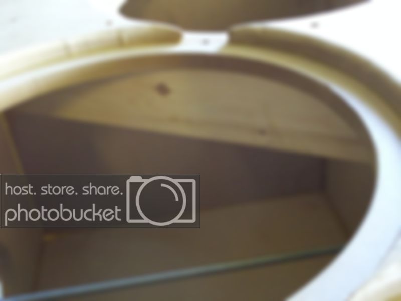

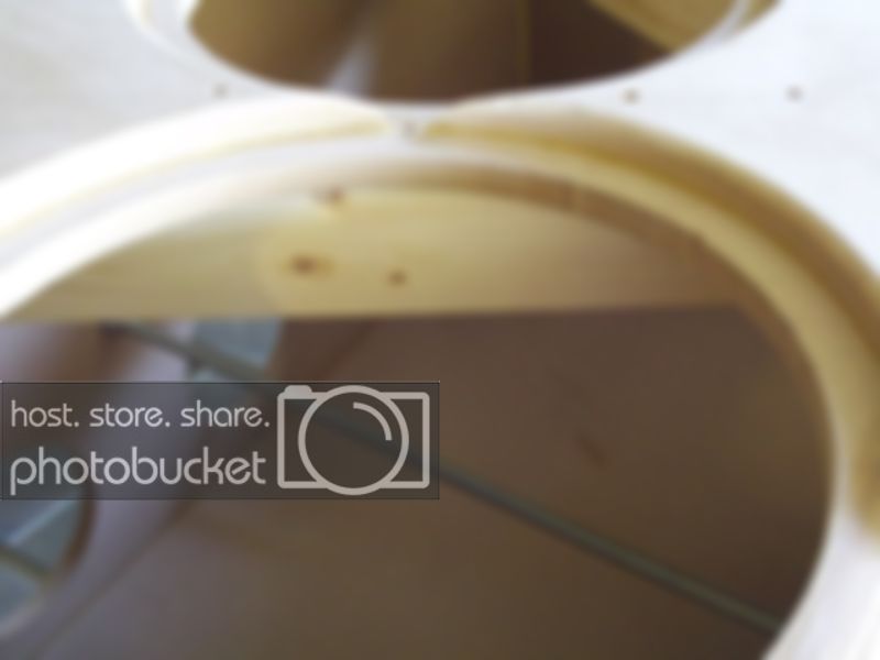

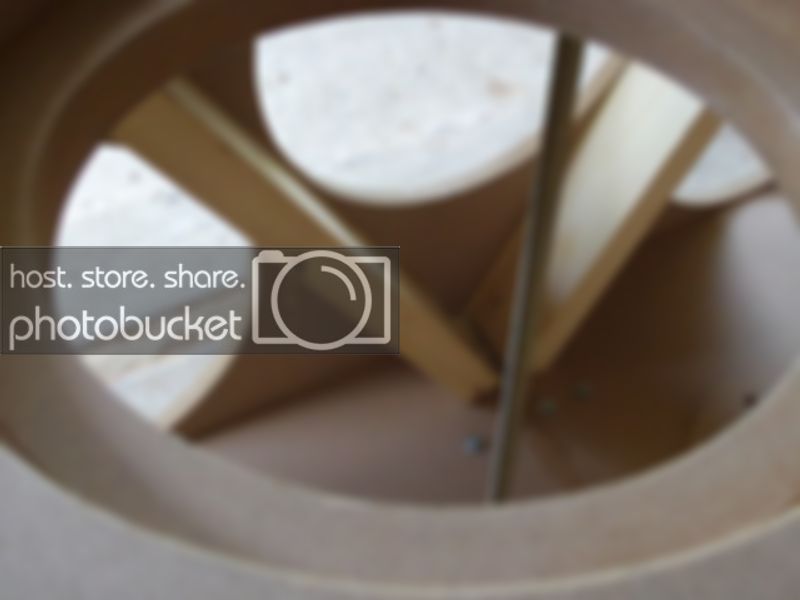

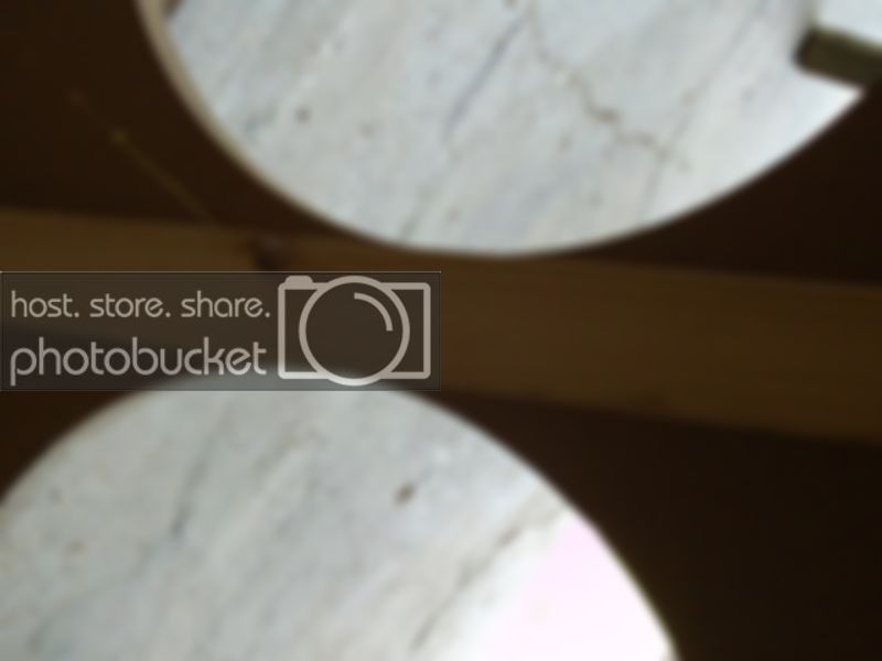

I wanted to use threaded rod vertically as well but didn't like the tight clearance between the ports & subs so a couple 2x4s went in under the baffle.

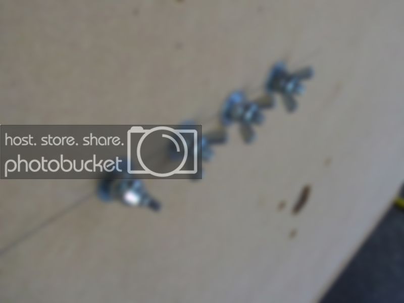

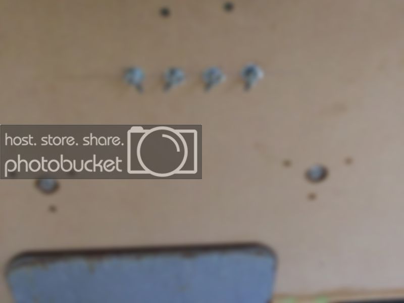

Bolted speaker terminals with wing nuts for easy hookup.

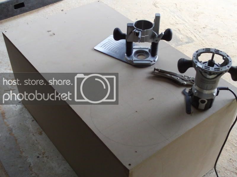

what tool did he use to cut the holes? router?

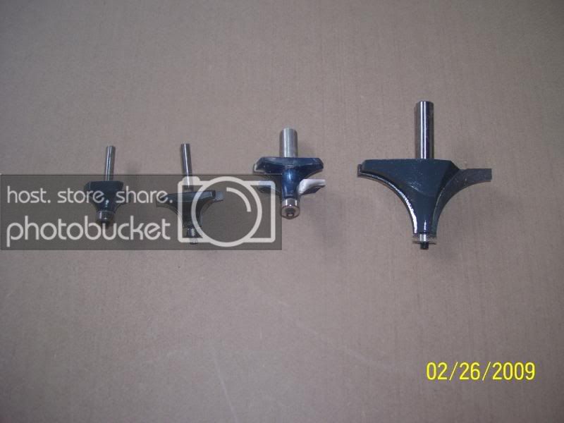

Also how did he get the edges smoothed out? using the router again or what? sorry I am a noob when it comes to building boxes
In this pic you can see the plunge base on the left with the Jasper Jig attached. Install an upsiral bit & That's what I use to cut perfect holes. On the right is the router with a fixed base and a flush bit installed. That bit is good for flushing edges and ports & such.
Roundover bits are what you use to smooth/roll the edges. Here's a pic.
From left to right; 1/2", 5/8", 3/4", 1.5"

My brother got the 1.5" from an online wood working place. Can't remember the exact name. No I didn't use it on this box. With a box being only single layered it takes away too much wood in the corners reducing structural integrity. I used a 3/4" on this box. With a single layered box the 3/4" bit leaves exactly 3/4" of wood in the corner. The 1.5" only leaves like 1/4" thickness in the corner.
