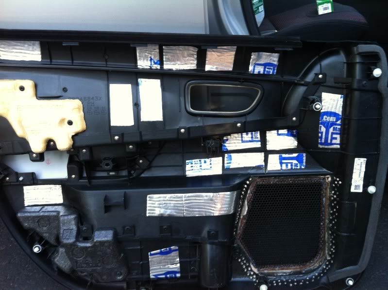

How is that deadener holding up for you?
I see that alot with Fatmat' date=' but havent had any issues with it. It's certainly not the thickest or best product to use, but I had about 40sq ft or so of it left over from a previous build so I figured it was better than using nothing. I always use a heatgun when applying it so that I get very good adhesion.

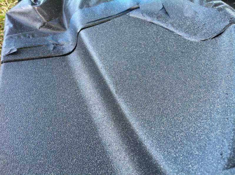

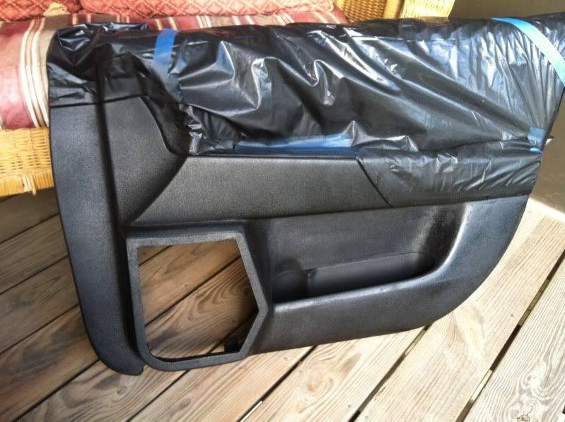

love that paint,thats all i use whenever i decide to paint the enclosure i build. Hides blemishes well and looks good once it dries.
Its definitely good at hiding the surface blemishes and has an overall even and consistent texture. Decent stuff.

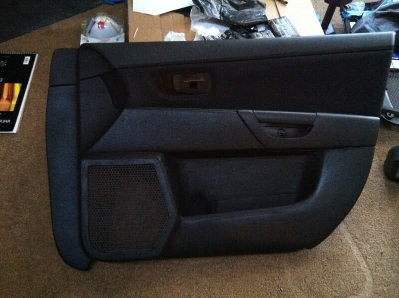

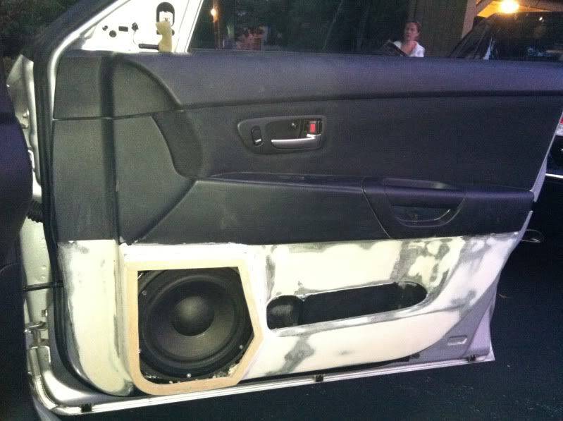

Incredible build! I feel like everyone is good at glassing, but me. What 8s are those? HAT L8?
Thanks //content.invisioncic.com/y282845/emoticons/smile.gif.1ebc41e1811405b213edfc4622c41e27.gif
Hah, I thought the same thing and I've gotta say, the level of work that DIY'ers are doing these days is pretty amazing. Like everything else, the more you do it, the better you'll get at it. Things can look rough at the start, but filler and plenty of sanding can get a project looking really good.
Yep, those are HAT L8's in the doors.

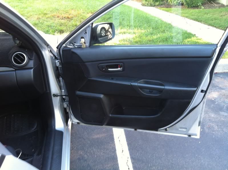

You are a talented craftsmen. I would like to hear how it sounds.
Did you play with the aiming before you installed the tweets? It seems like it would be a little bright but I guess there's to many variables to tell.
There are no tweeters installed currently. 8" midbasses in the doors and 3" wideband drivers in the a-pillars. Because they are aimed on-axis to the drivers seat, I dont experience the drastic roll off of upper frequencies like I would if they were aimed toward the center of the car, or cross-firing. Both of those scenarios would absolutely require a tweetr to be used in addition. As they are, with some EQ added in, they can sound pretty darn good. I did play with aiming and also did so extensively in my last car as well. This setup is not what I will be running in another few months though as I have some other plans for the front stage of this vehicle. //content.invisioncic.com/y282845/emoticons/smile.gif.1ebc41e1811405b213edfc4622c41e27.gif
