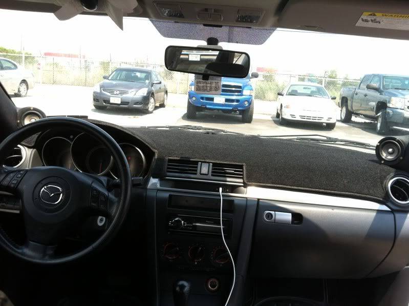

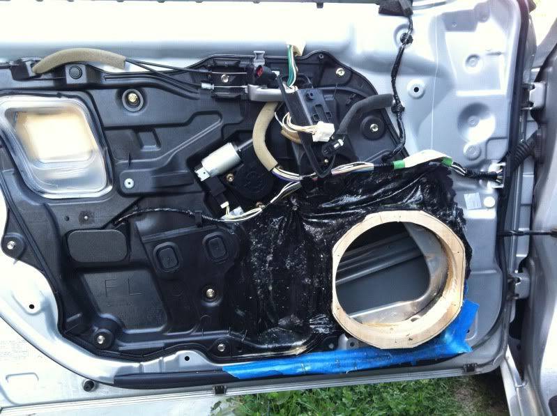

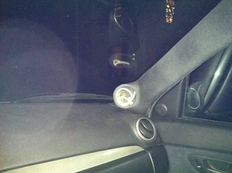

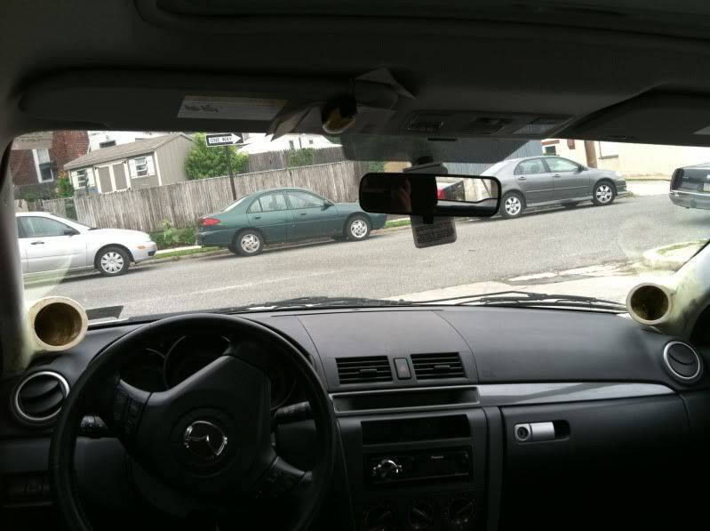

I decided to do A-Pillar pods, midbasses in the doors and sub in the hatch/spare tire well. Here are the pictures and a few notes... I have tons of pictures to upload as it's still in progress so I'll keep adding them a little at a time. Thanks for viewing and for any comments.

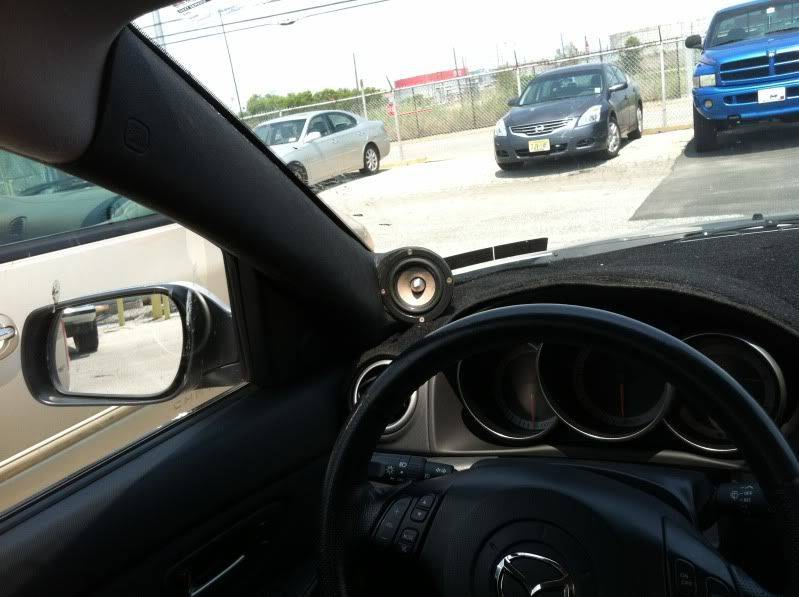

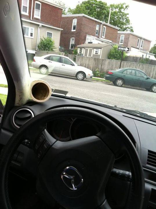

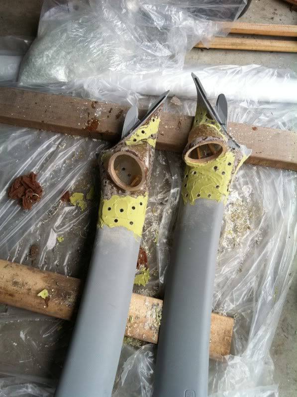

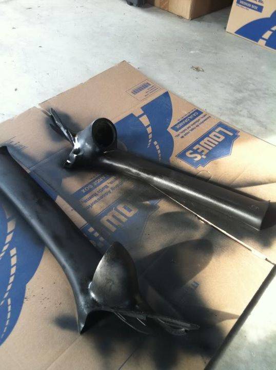

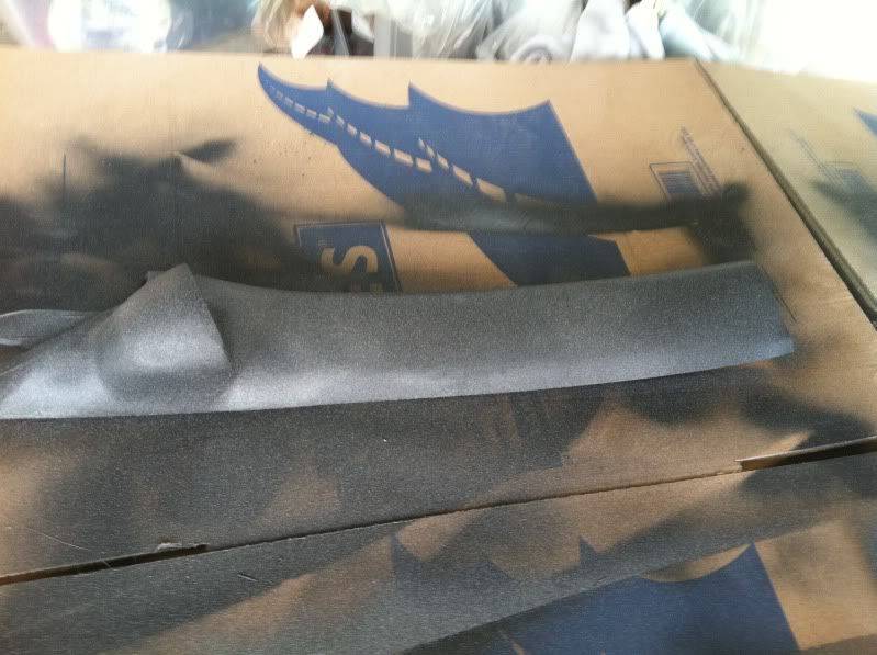

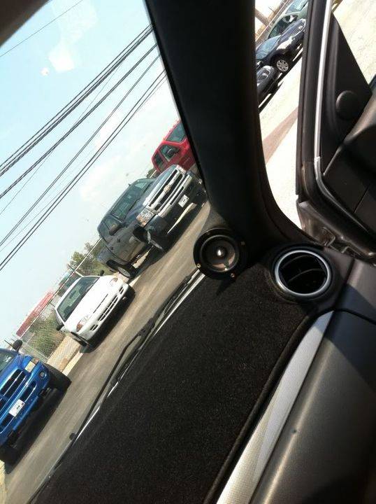

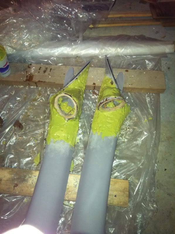

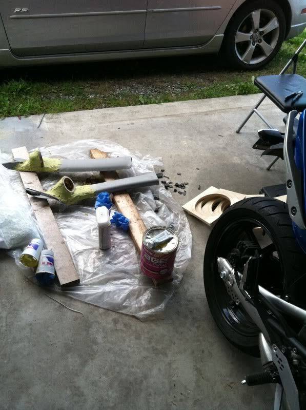

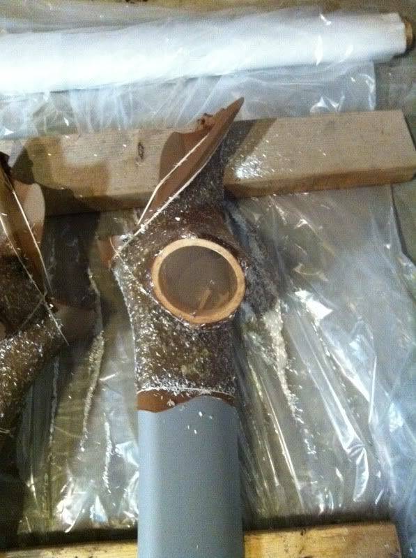

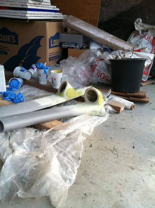

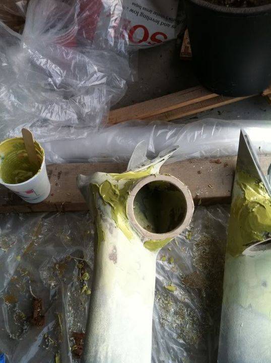

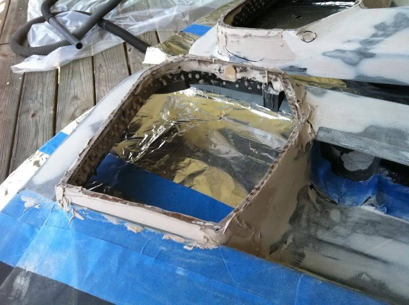

A-Pillars

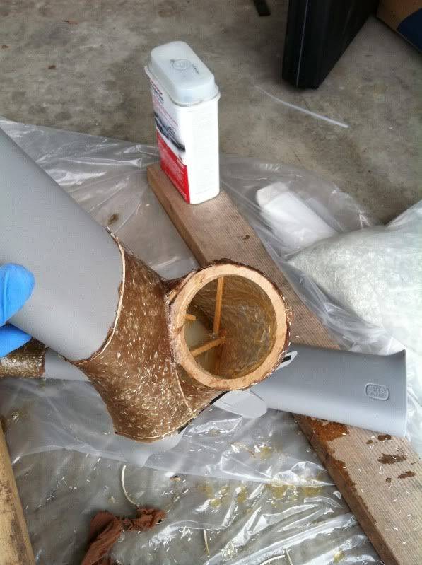

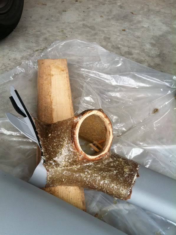

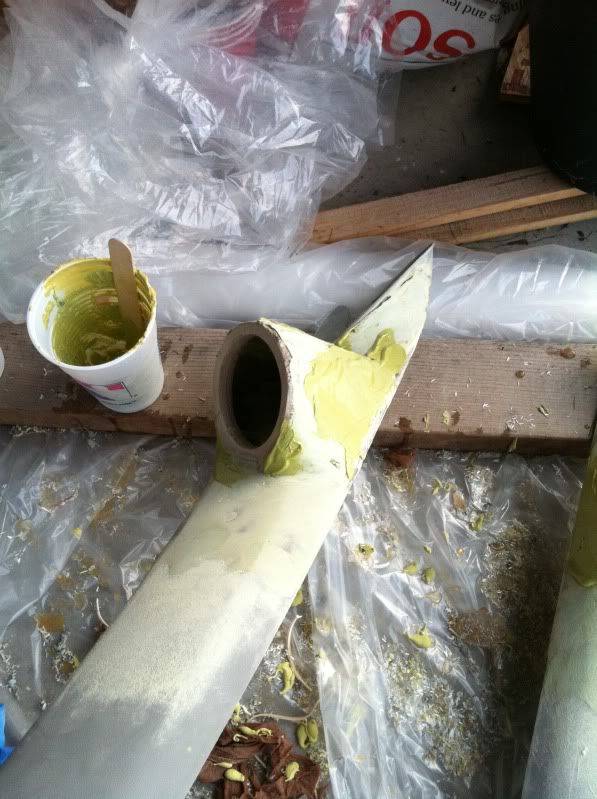

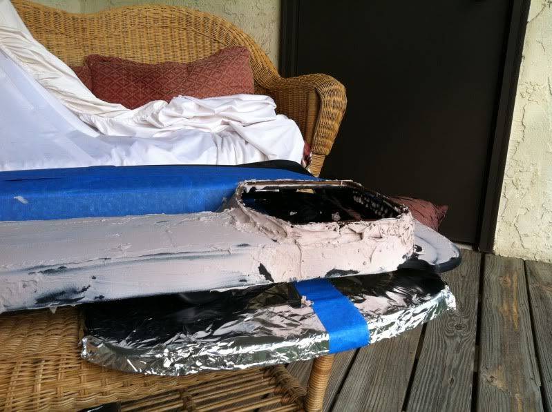

Ahhh, the smell of fiberglass in the morning.
Smells as terrible as it does any other time of the day!

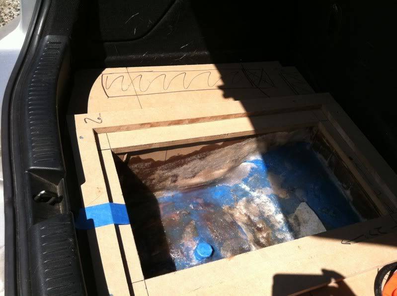

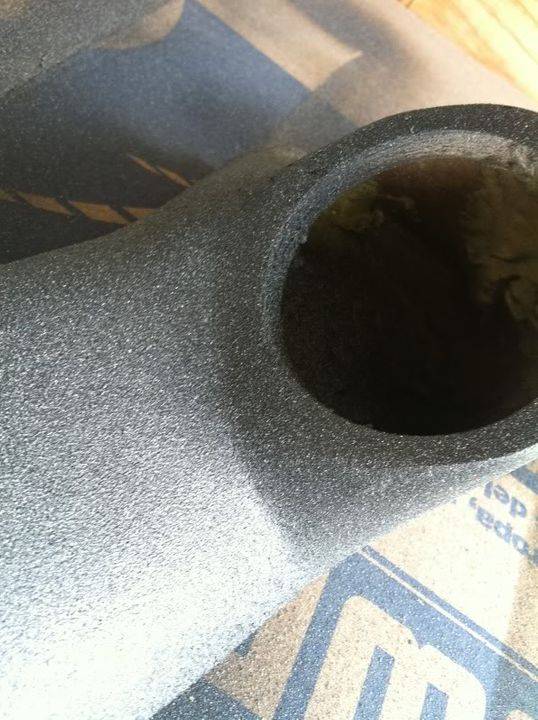

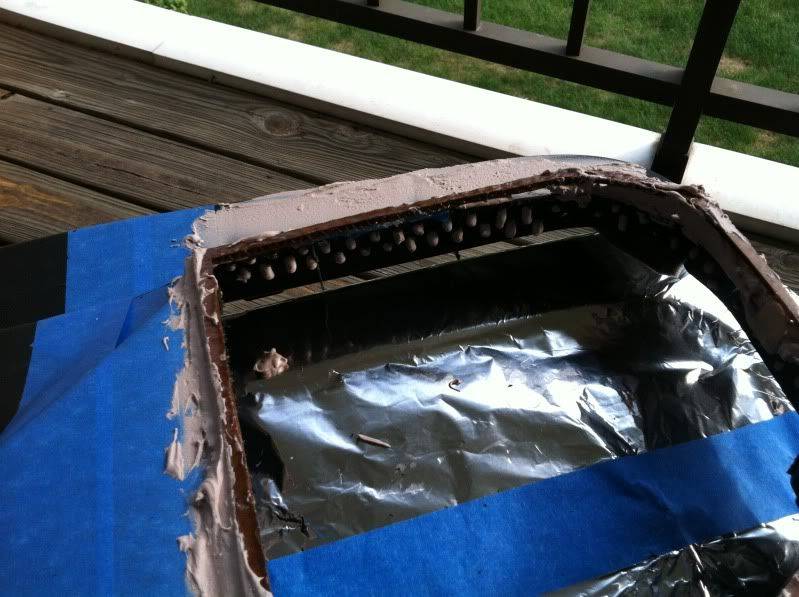

And the milshake on top for even more coating...

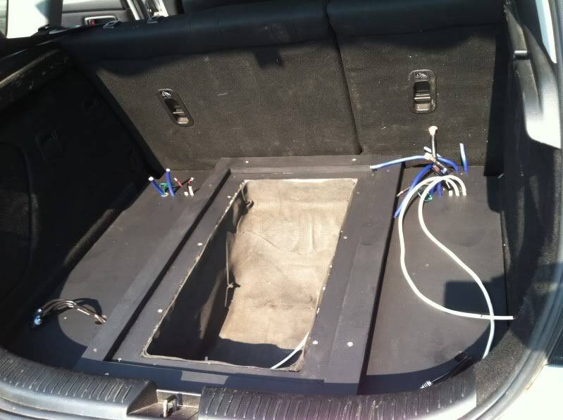

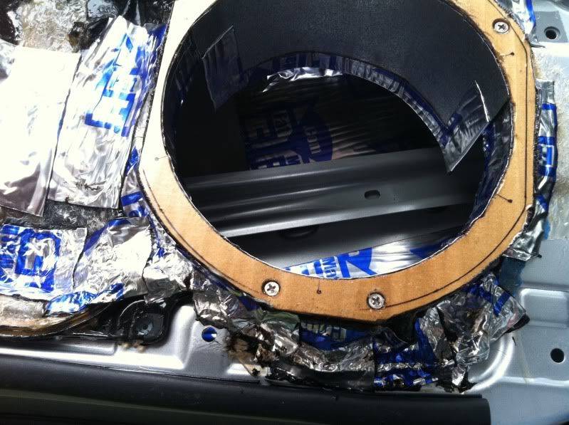

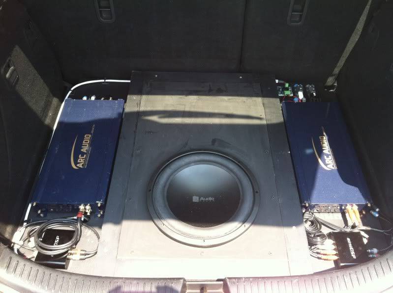

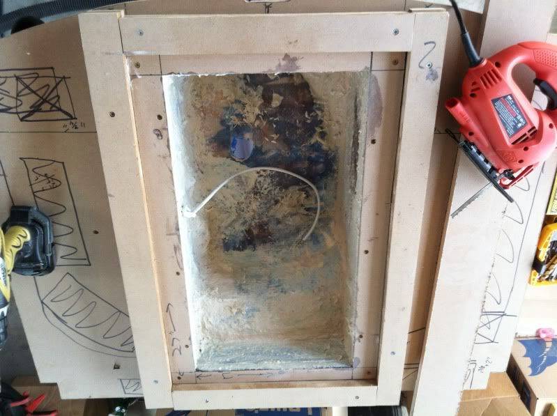

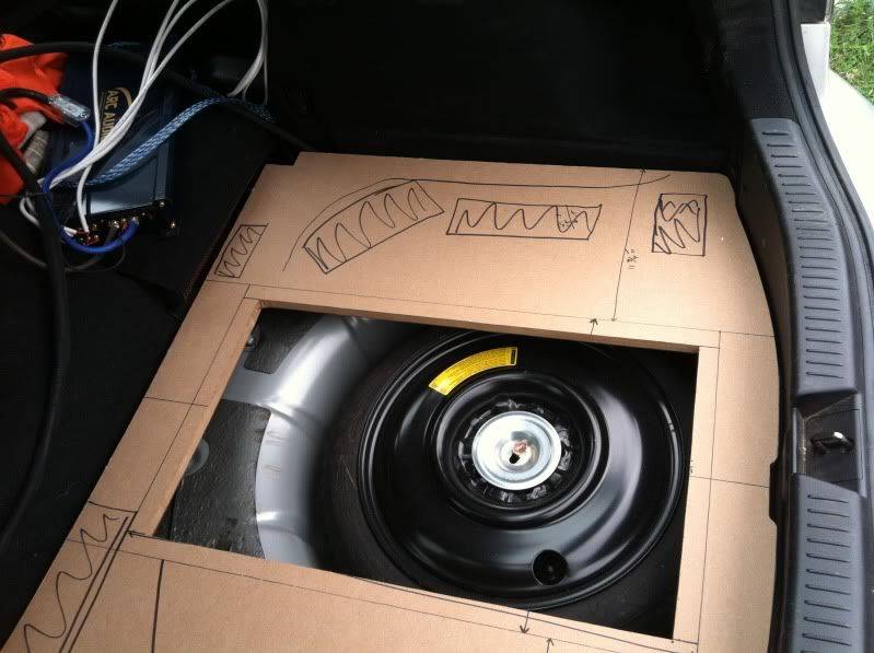

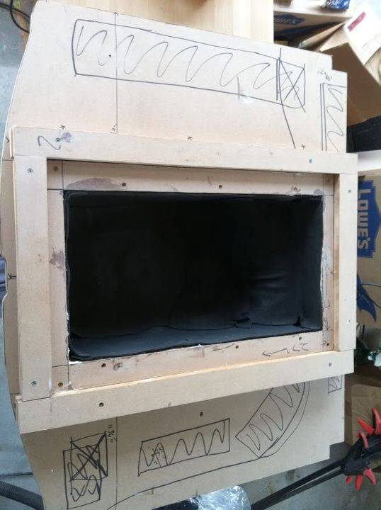

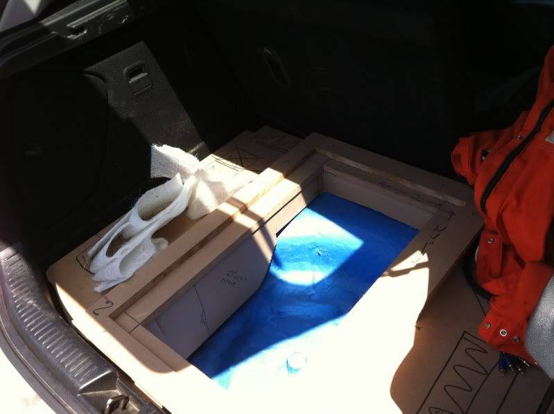

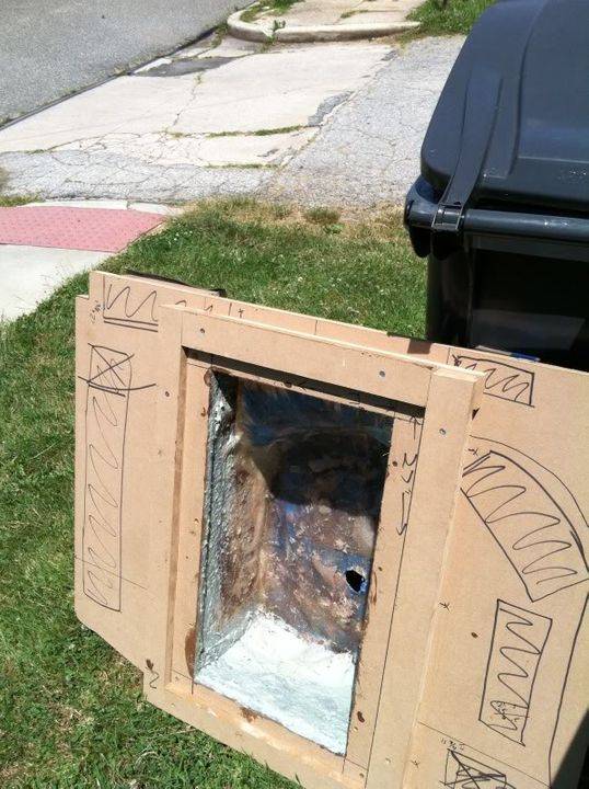

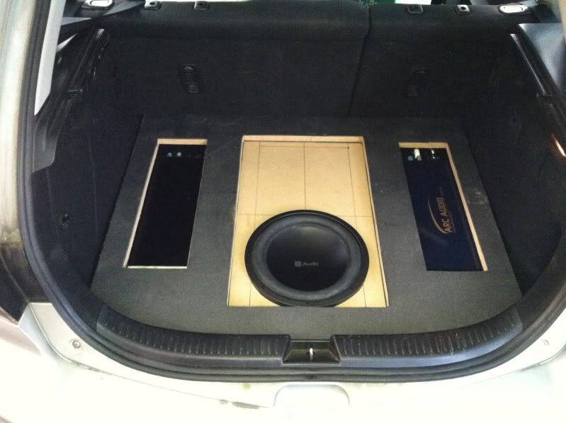

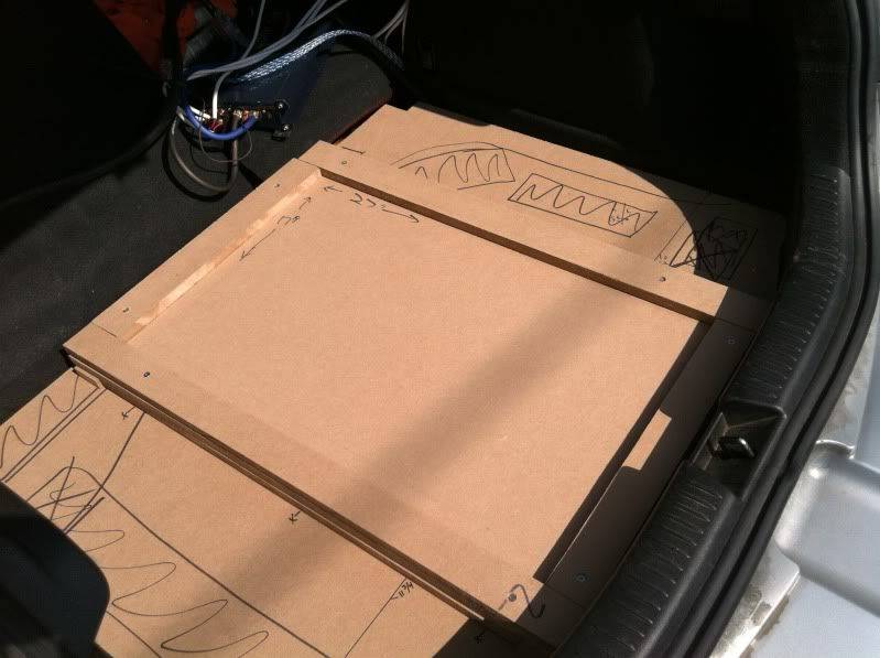

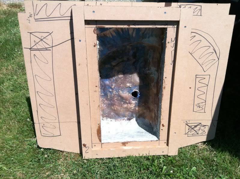

Lined the interior with some spare foam

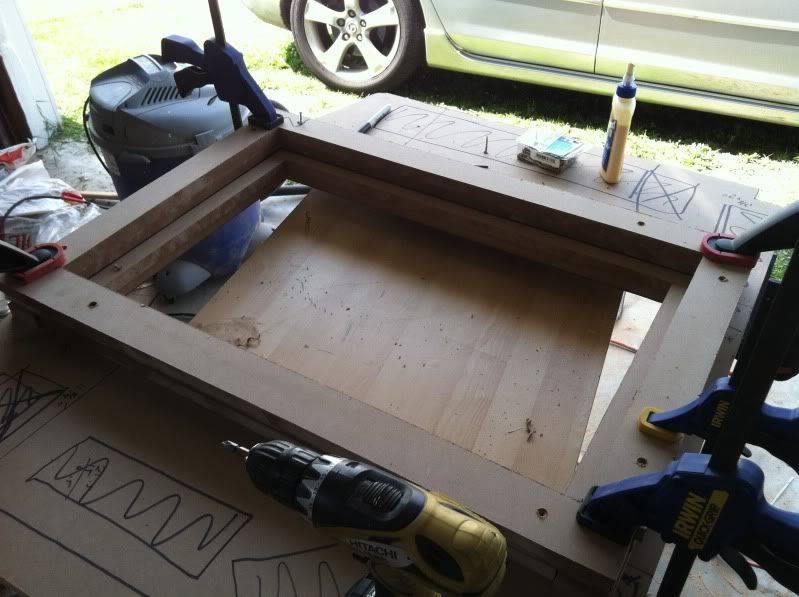

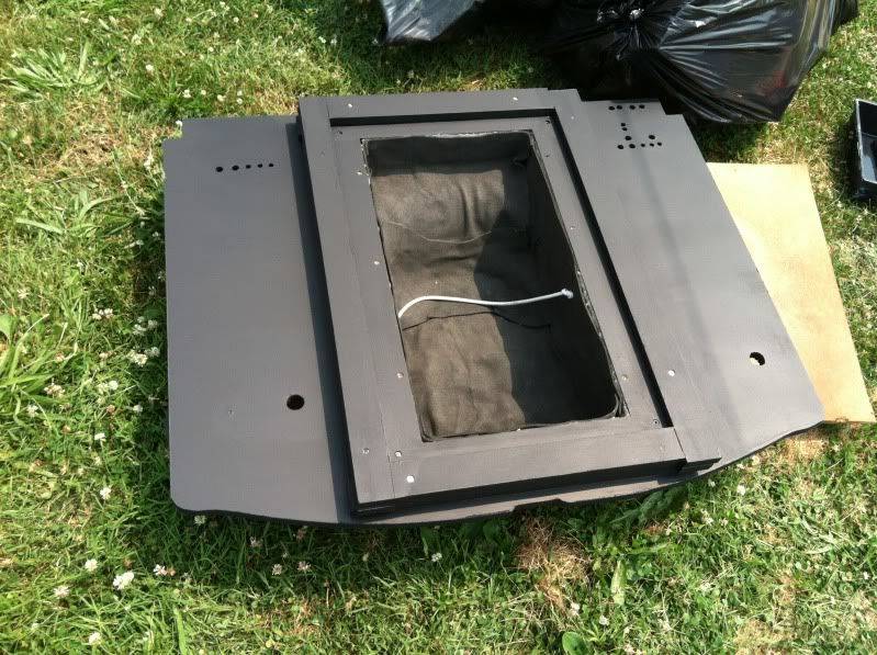

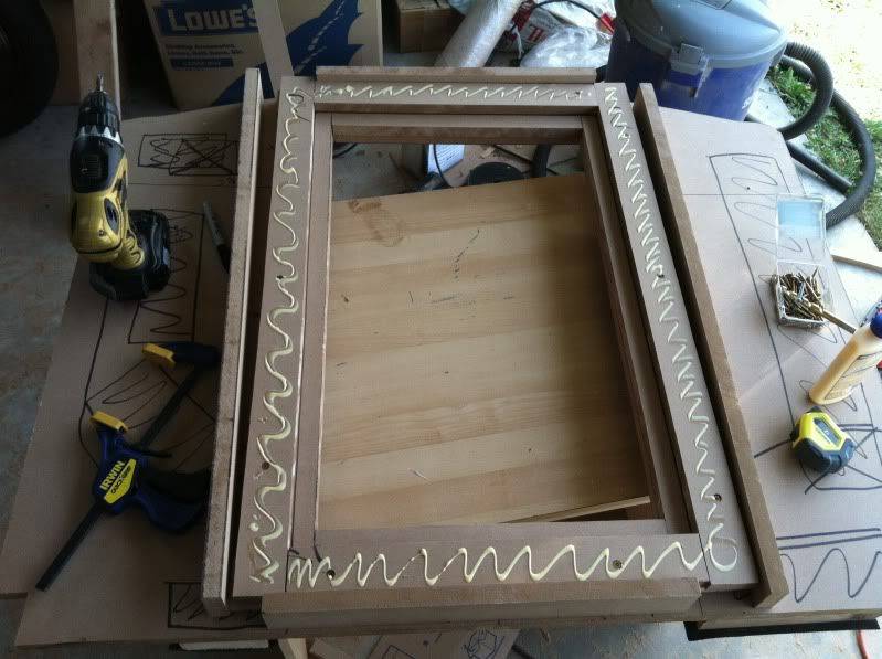

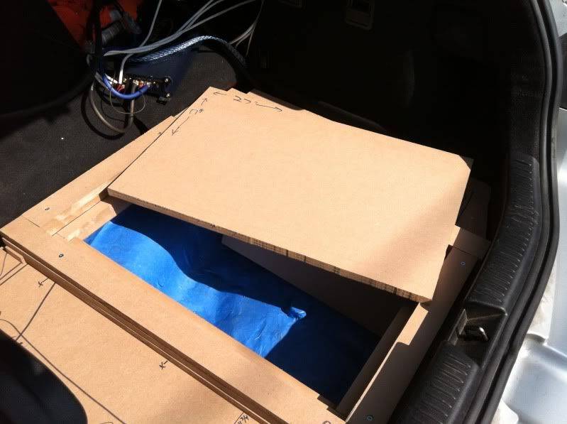

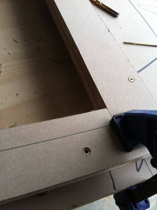

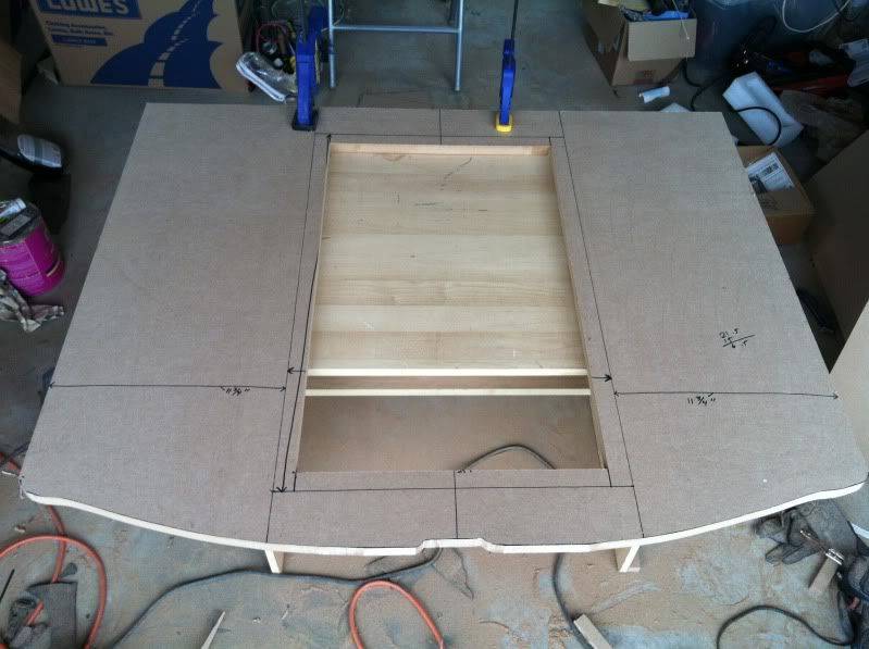

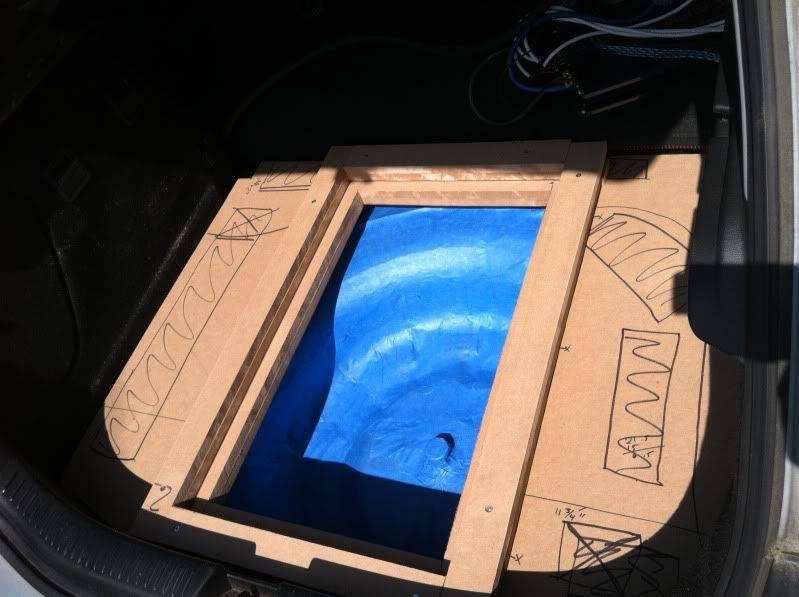

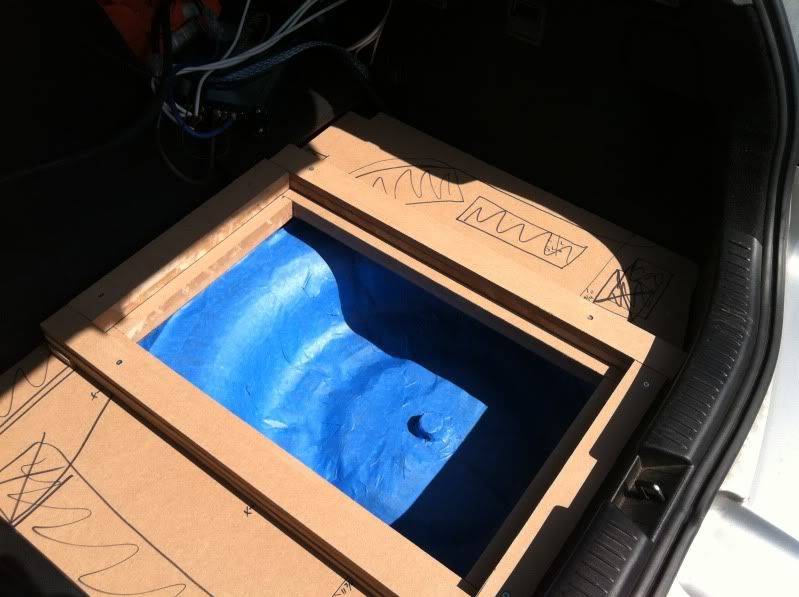

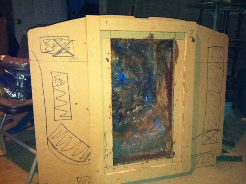

For those wondering, I built the sub enclosure modularly like that so that I can swap out the tub and/or the top baffle to accomodate changes in subs back there //content.invisioncic.com/y282845/emoticons/wink.gif.608e3ea05f1a9f98611af0861652f8fb.gif

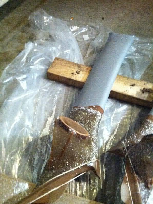

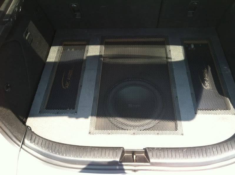

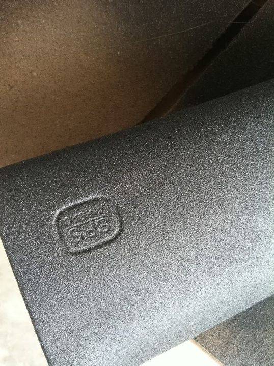

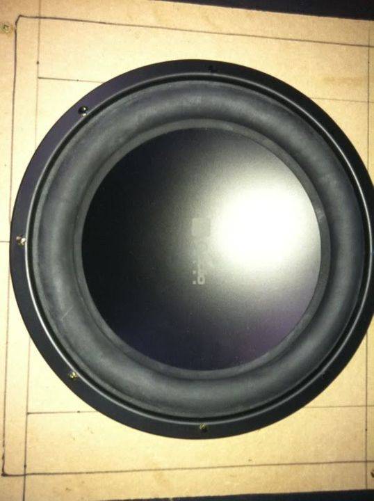

Painted the sub baffle black to match.

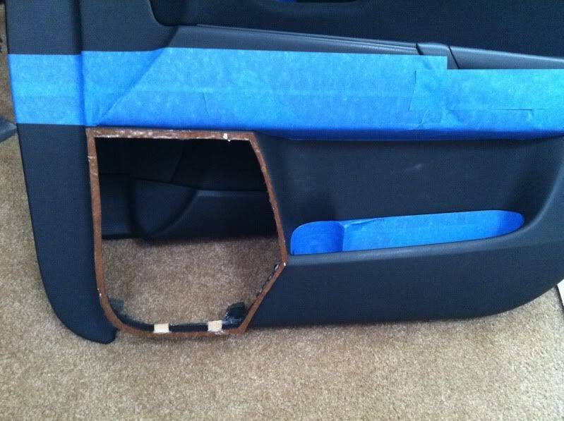

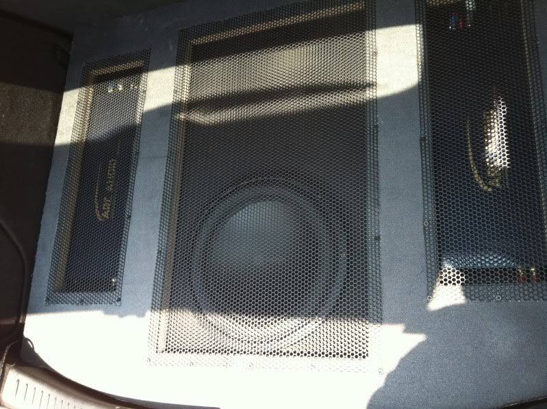

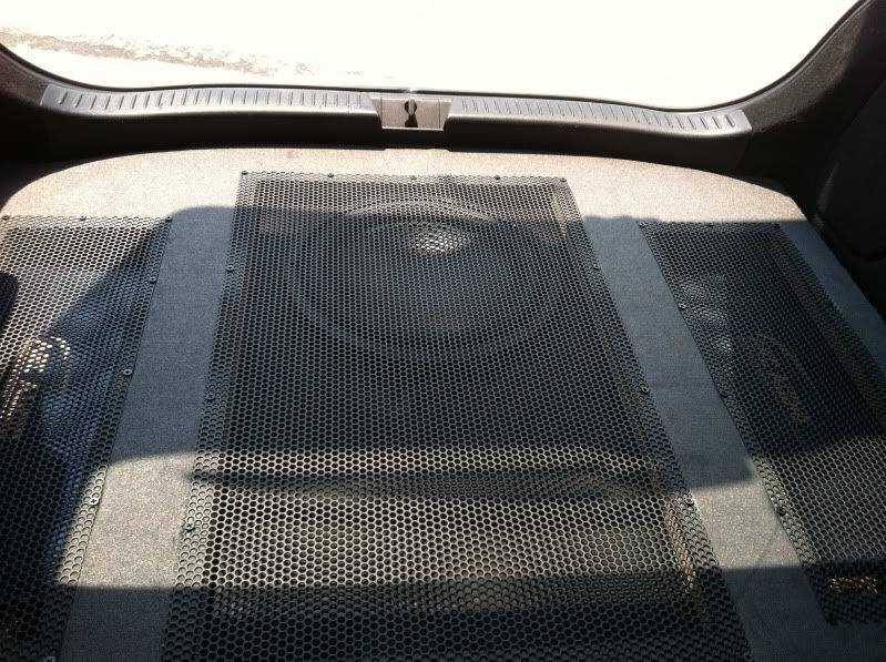

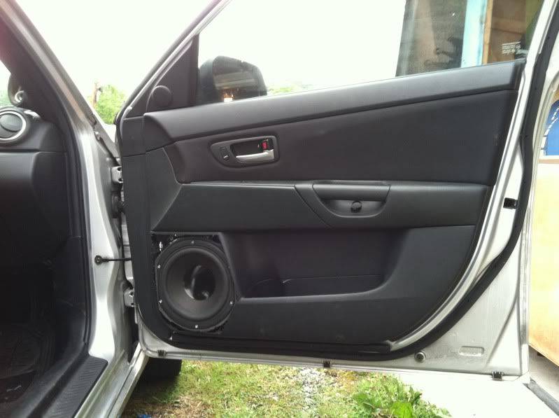

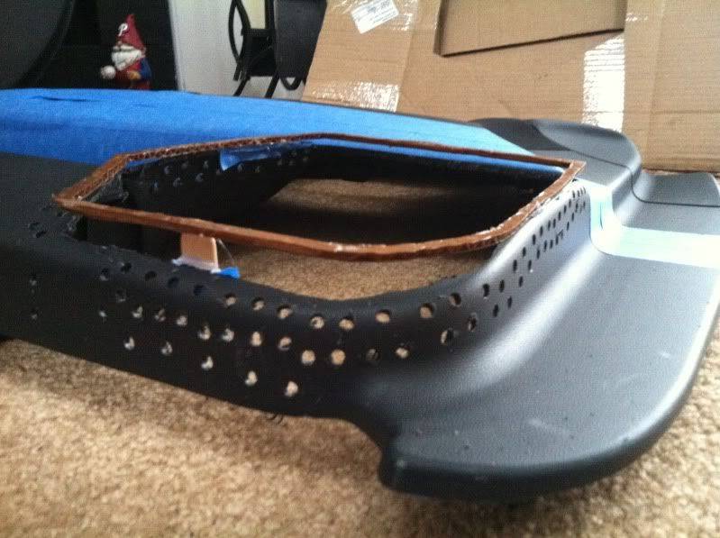

Cut out steel grille for the panels and mounted up
