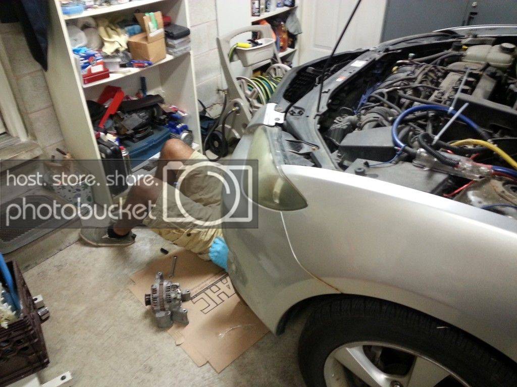

JS Ultimate Alts 220 amp alternator
Big three upgrade with KNU flex OFC 0 gauge

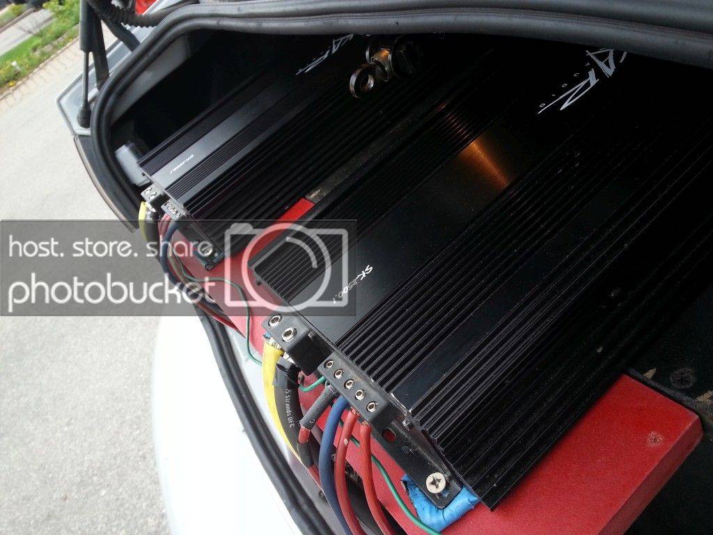

Old Bass amps:
Two Clarion DPX11500 at 0.33 ohms
New Bass amps:
Two Skar Audio 2500.1s at 0.33 ohms each

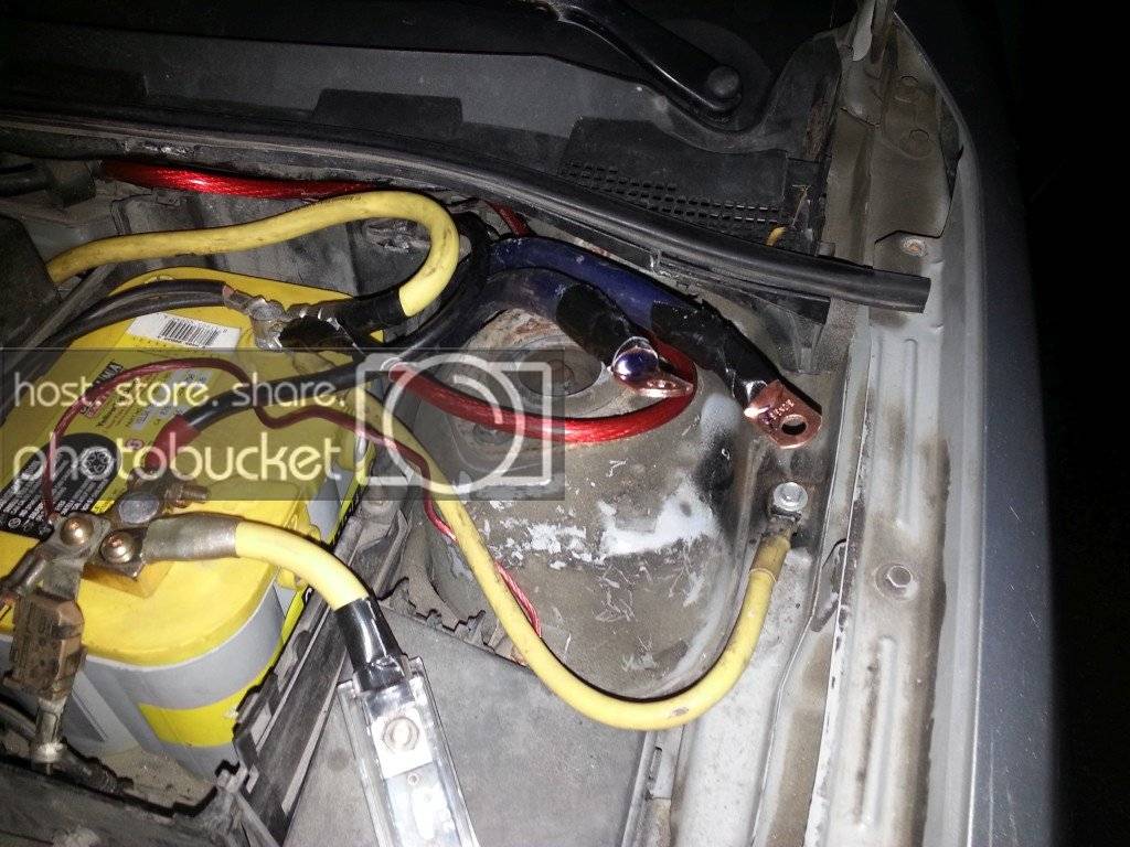

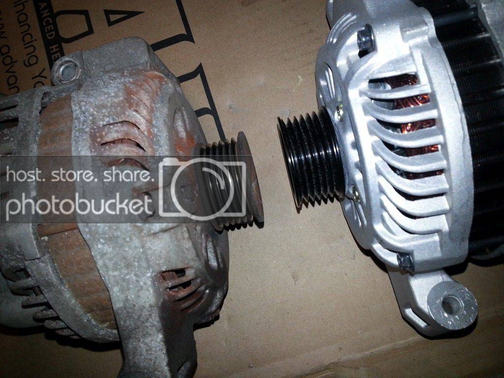

Out with the old, in with the new (a smaller pulley was installed a couple weeks after). Always great to have a good buddy that's happy to help.

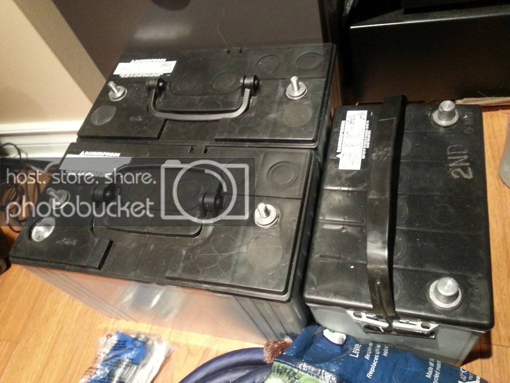

Time to swap out some batteries. Brand new blemished Deka AGMs, two group 31s and one group 34.

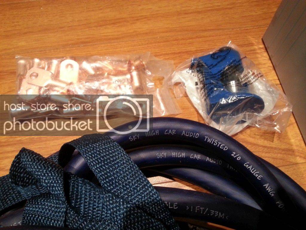

Got a great deal on 50ft of used Skyhigh oversized 2/0 CCA. Would have gotten 0 gauge OFC instead but the price was just too good. And some copper lugs and hammer crimper to go with it.

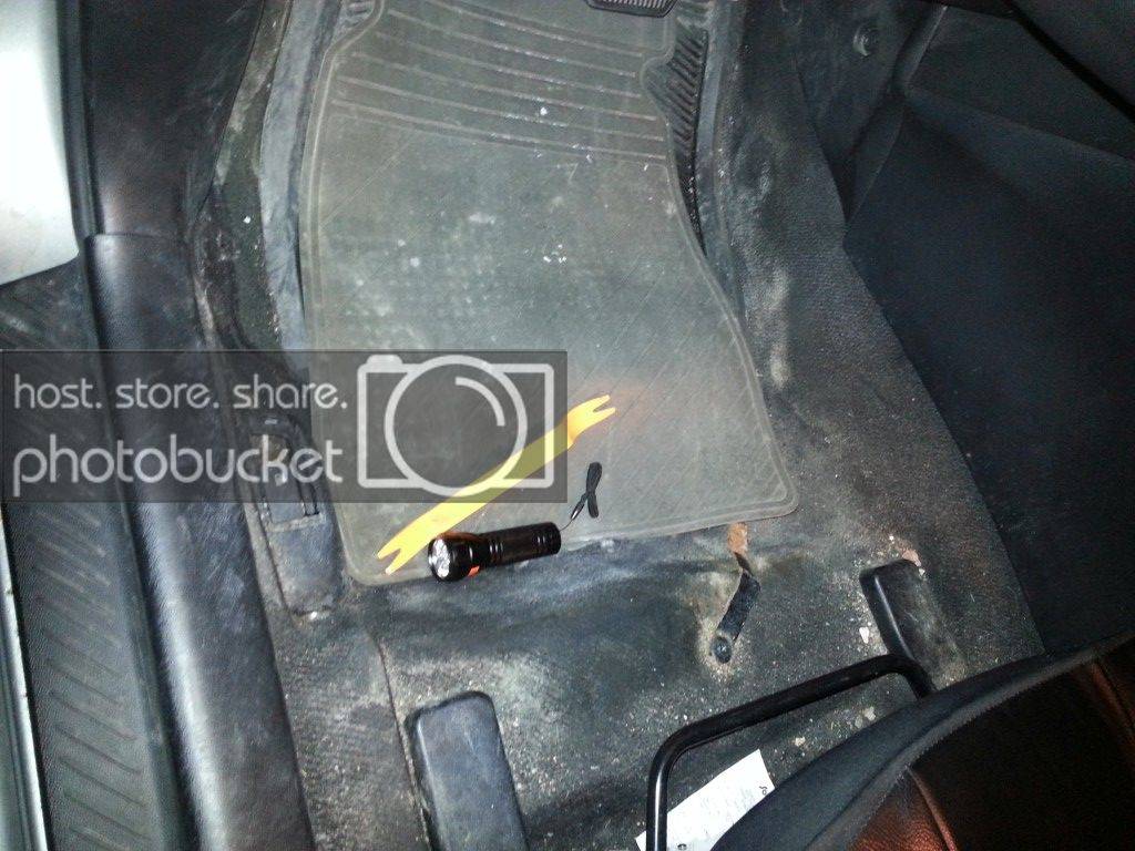

Running some wire in minus 20 degree weather. The Yellow top is an old one I was using for the winter.

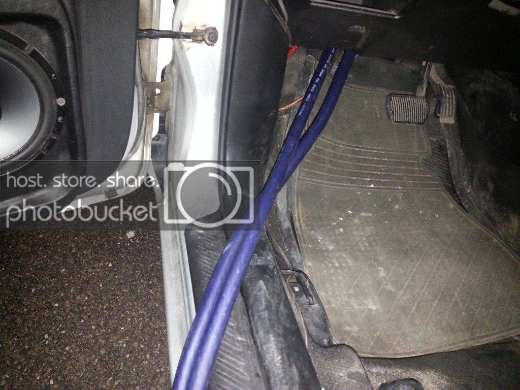

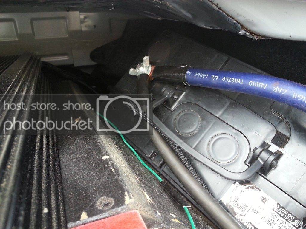

The two huge runs fit better then I expected! One ran on the left as usual, the other under the center console.

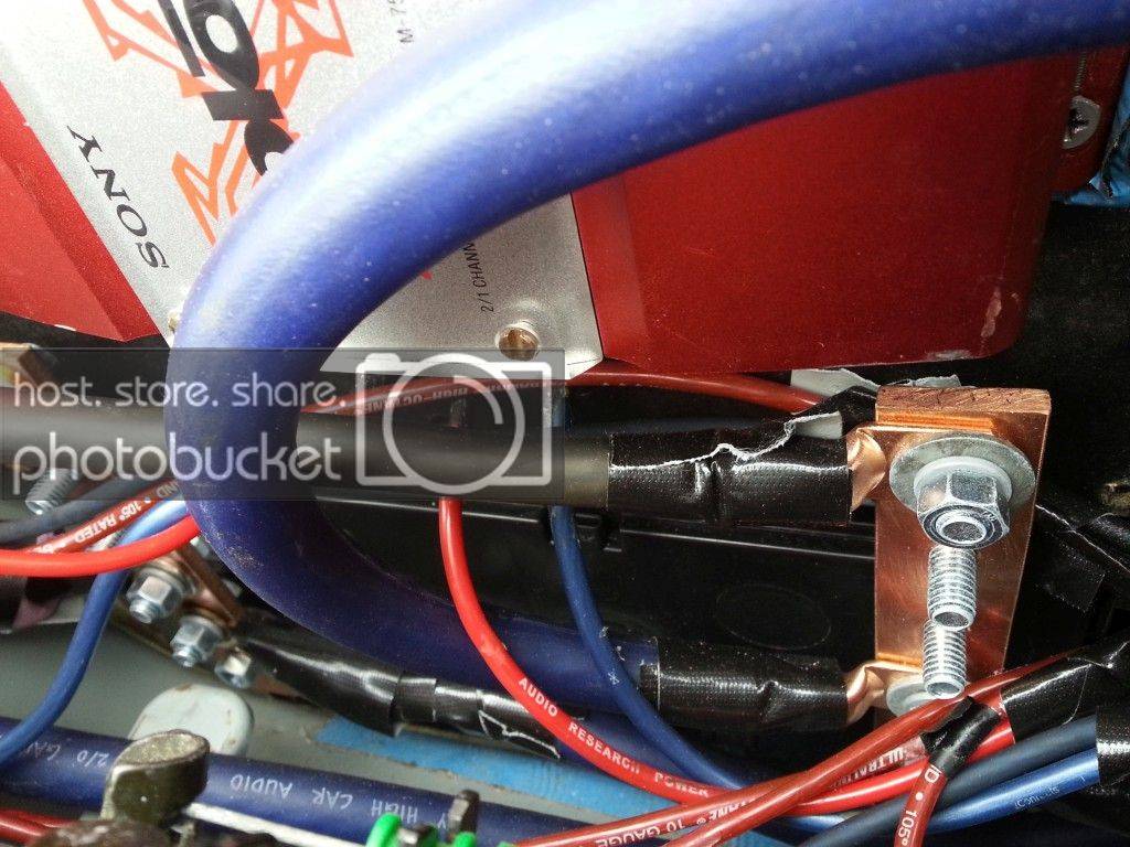

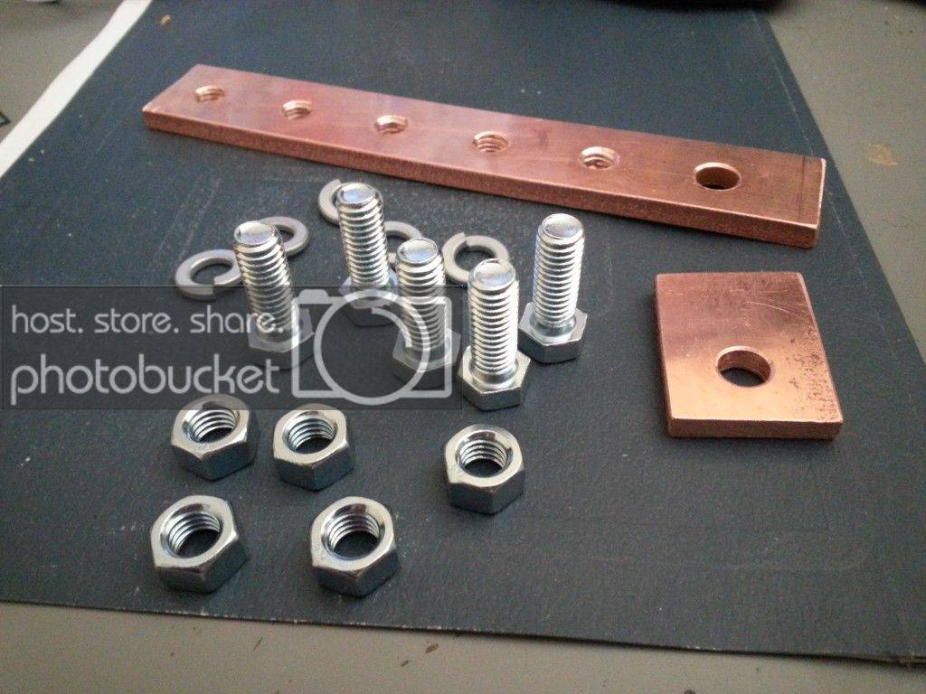

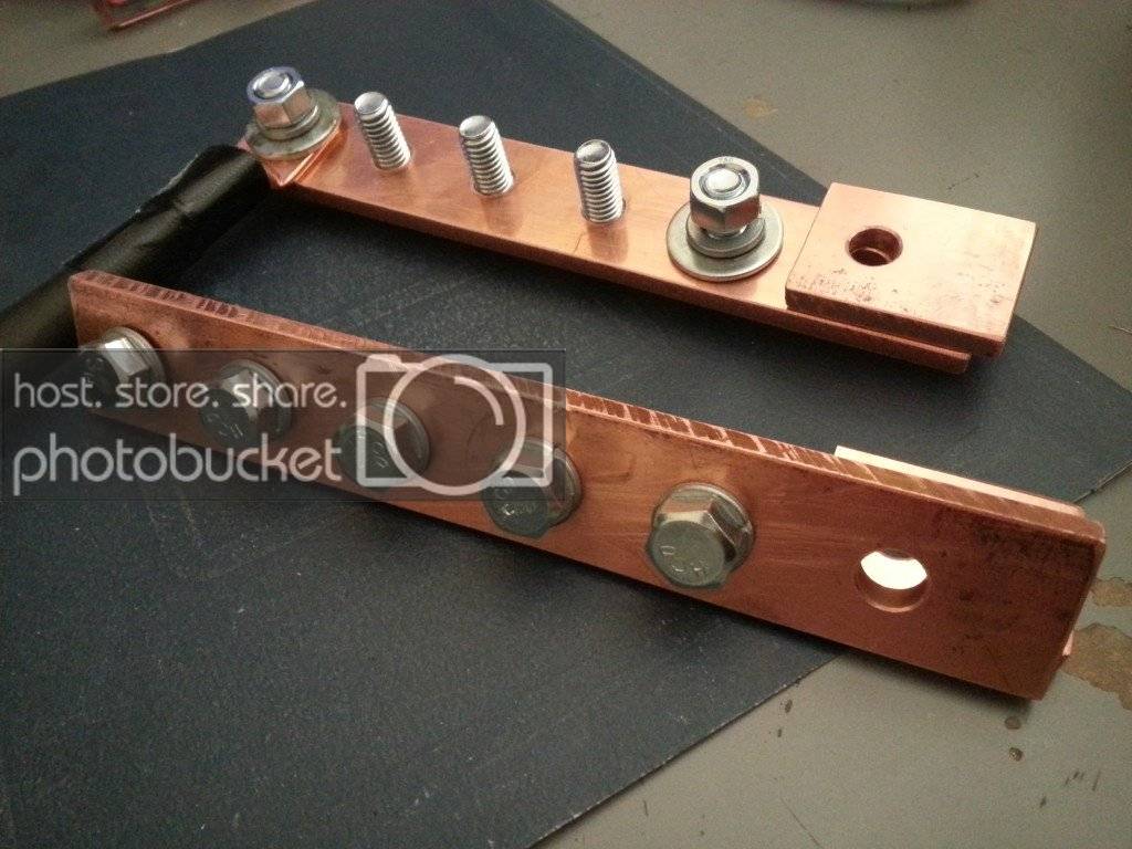

Lets add some copper bars to the spare tire well battery for easier access (yeah wiring is still a mess at the moment).

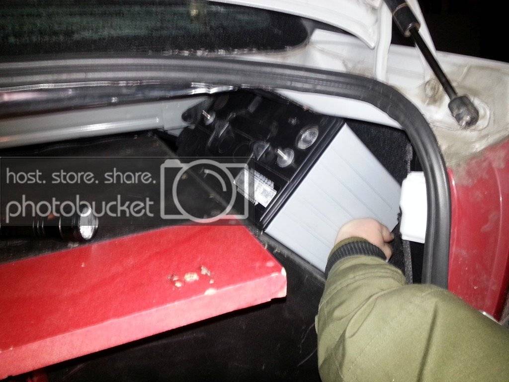

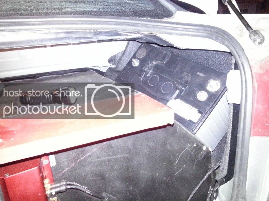

Who knew I could stuff another big Group 31 battery in to that trunk? I originally intended to put it inside the cabin behind the center console. Yes I was doing most of this during a nice cozy Canadian winter.
Add a couple Skar 2500 amplifiers...

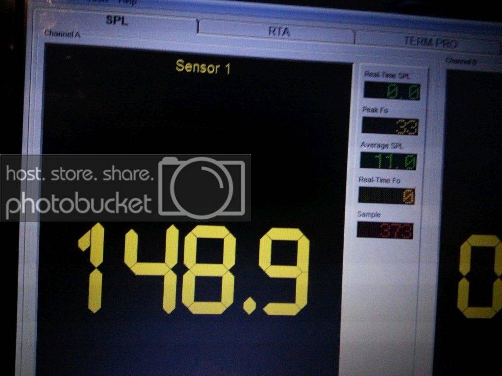

And throw the car on the meter for the first time ever. Sealed up, on the dash of course. 148.9 at 33hz is better then I expected on the first run.

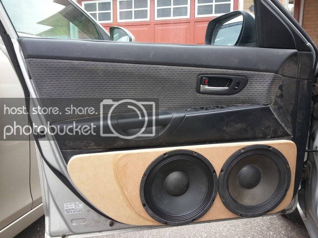

UP NEXT in a couple weeks - front stage overhaul. Here's a sneak peek:

Kicker 46CSS654 CS Series 6-1/2" component speaker system chose these for the front chanel Kicker 46CSC654 CS Series 6-1/2" 2-way car speakers...
