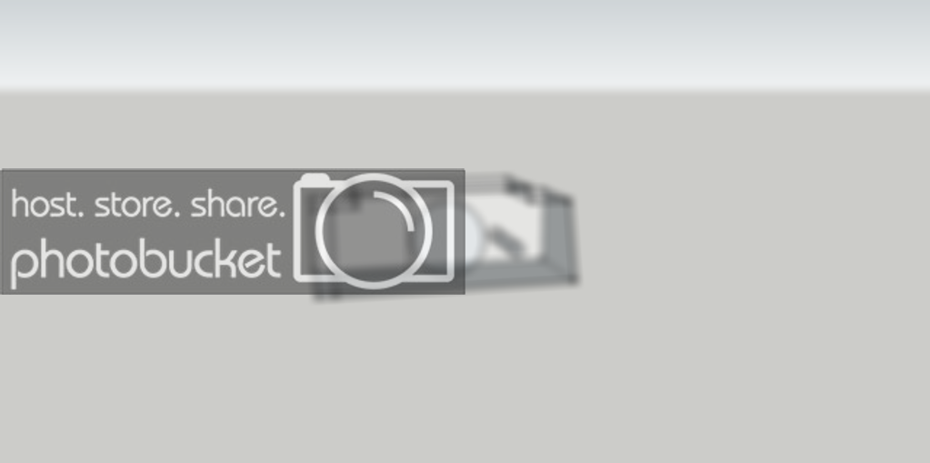

I am building an enclosure for a friend of mine and would like some inquiry on the situation. His vehicle is an 05 maxima 4 door and his equipment is a 12w7 paired with a Jl 1000/1. I finished the design yesterday and presented it to him. I originally told him that due to the height of his trunk it might be best to fire subs and port forward and semi seal it from the trunk. Well his original idea was to have the port and sub firing into the trunk sealed off from the front but I told him that was a bad idea.
Well another friend of ours was their when I was showing him the design and he was like "that's stupid its louder if you fire it into the trunk". So I proceeded to tell him why I designed the box the way I did but he was like oh I know more than you because I'm older and have had more systems than you blah blah blah... Anyway the owner of the car is leaning more towards his sealing everything off from the front idea so it will "look good".
I talked to him about putting a window on the back to see the ars of the sub and a nice amp rack so I will be showing him pictures of that. I also want to get personal experience from people with this vehicle and what they did.
The design I came up with is 2 cuft @ 32hz
If you have any questions on the design let me know
don't really understand the humps on the side but from working with my altima which is an 98 17 tall is a high as i can go on my boxes an about 40 inces wide. with that said they can't be 17 tall an 40 wide or even 36 wide caouse it won't fit in my trunk but his car it may.
i would say build him a box that is 2.5 to 3cubes tune it to about 38 or 42hz an throw it in his trunk.
sounds to me he wants his tag to rattle so he can seem louder an inside the car if the subs an port ar back it is louder than subs an port into cabin. thats from my testin.
i say 25x14x16 an tuned to 40hz should do him good on music. but thats just me man i run 15's now but but that is the size of my 12 box i have in storage.

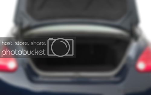

In this gen maxima the trunk is pretty shitty and only has a total height of a little over 14" without taking stuff out. The humps are for two "bars" that come down. Here is a picture of what I'm dealing with:

that trunk still hasn't changed i see still big *** gap at the top an small opening at the bottom making it the hardest trunk to put a big box in anyway. well if he wants the subs firing into the trunk yes port that thing through the deck lid.

Well the box isn't for me, its for a "customer". He's not looking to get full potential out of his setup but to just get the most he can while still looking "cool". I know 2.5 - 3 cubes isnt that big but for a single 12 I would think 3 cubes would be to big. From what I could find people seem to like 2-2.25 tuned around 32 for the 12w7. With that being said I think he would be more than happy with 2 cubes @ 32 and give the sub around 750-800rms.
The only issue is his contradicting wants. He wants to seal it off from the cab but have it still "beat the block down" and sound good...which I don't see happening. If worsts comes to worst it looks like I'm going to have to seal the sub off from the cab and port through the rear deck.
