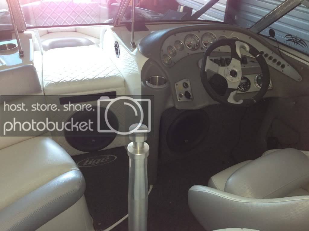

Sundown sd-3 in some fiberglassed(inside and out) marine grade wood enclosure.
Should just about do you.
The issue with open bow is there is no real good place for a sub.
That might give you some ideas.

I like your sub locations, I don't think putting a box in the aisle way to bow would work so well for me with kids being 1&3. I have thought about putting them in the footwells in front of captians chairs and passenger. Did you build a box for them on the back side?
Why would you do the polk dp over the mm series?
Seems like a decent amp as far as output. Havent heard of them before.
Because ive heard the polk. PPI=Precision Power. They've been around forever, most their amps are junk but the phantom series is good.
Not my boat actually but yes, you would have a fully enclosed box essentially firing into your seat. Ideally in a closed bow boat, you'd fire it into the bow and get a horn effect but thats why open bows are so tricky.
