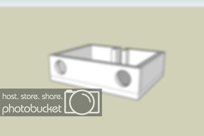

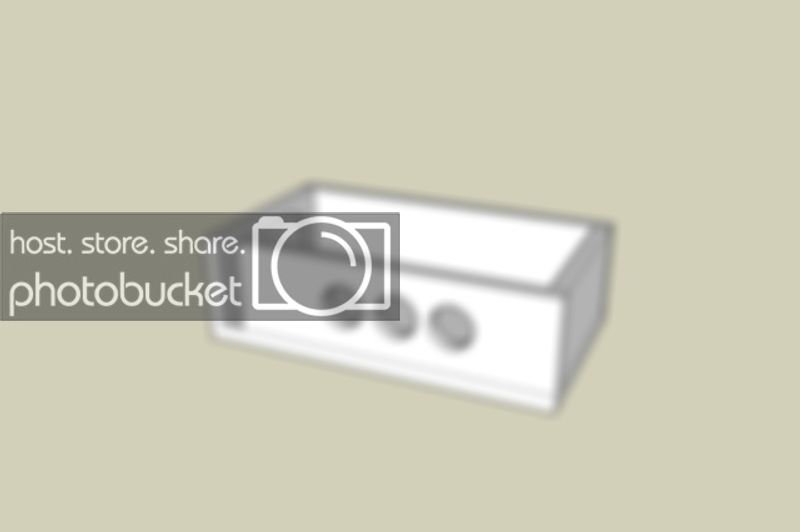

My HT is needing a center speaker, so i need some opinions about how id go about doing this.
First is the enclosure, im not buying one, and i have tons of spare wood laying around. I just learned how to design sub enclosures, so i have no idea what to tune to or what cubic feet. Here is a quick design i drew up. I just got the dimensions as to what would fit under my TV. According to me it should be around .18 cubes before displacements tuned to 150 htz. I had no idea what to tune to, so this is just a general number. Is it even worth porting these or should i just seal them up?
Second is the drivers, i dont want to mess around with anything except full range drivers, becuase if i get anything else ill have to cross them over and whatnot. I have these two picked out. Also, being these are 8 ohm, i could do 4 ohms (which my reciever is stable to), and risk overpowering them, or 16 ohms. Would this be underpowering them. I would like to have strong midbass for guitars and drums with mellow highs. These will mostly be used for music, which consists of mostly rap, and some heavy metal (atreyu, korn, disturbed etc.) Sometimes for movies, but not as often as music.
http://www.partsexpress.com/pe/showdetl.cfm?&Partnumber=297-428
I want to spend around 40.00 shipped for them, this is a budget project.

Horizontal placement creates lobing problems between the two drivers at high frequencies. The further apart you place the drivers the lower the frequencies will be before lobing starts to become an issue. You will get off-axis interference/cancellation of certain frequencies if you aren't listening directly perpendicular to the radiating axis of the drivers. It would therefore be best to use only a single full range driver, or use 4 or 5 placed very close together to try to minimize comb-filtering, or at least place them in a vertical configuration with close driver spacing.
As far as tuning is concerned, you want to tune to driver specs to achieve a flat response curve. You don't want to just pick an arbitrary frequency. Usually the Fs of the driver gives a close approximation but the best way to predict the tuning and enclosure volume would be to model the driver in a program such as Unibox or WinISD.

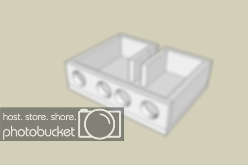

Would maybe 4 of the drivers i selected work better? I put in all the T/S params PE had for the drivers into WiniSD and it had them at 29 htz at 3 cubes, so i started over with my design. Airspace is the same, but its tuned to 80 htz. (Fs:77htz)

Yeah I'd go with 4 or 5 drivers (really, the more the better but it does get expensive), spaced as close as physically possible. Also I'd probably find a way to put the port on the front. Maybe two circular ports on the left and right of the drivers. I would try about 0.1 cf per driver tuned around 80hz.
