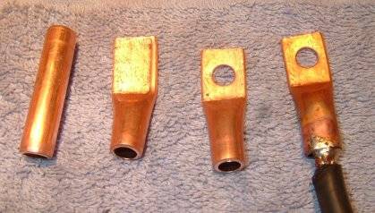

Lets see some of these homemade terminals. Im interested
I dont have any pics but from just imagination. Id assume you get small copper tubing. cut say 2 inches of it off. Smash half of it. Then drill a hole through the flat part. That gaves you the tongue and then you solder/crimp in the wire into the tube part of the copper and you essentially have a copper ring terminal

Lowes has 1/2in x 10ft Pipe.. That will easily make 60 lugs. That's about 18 cents each. I think I can make them pretty easy and look nice. I'm going to give it a shot I think.
