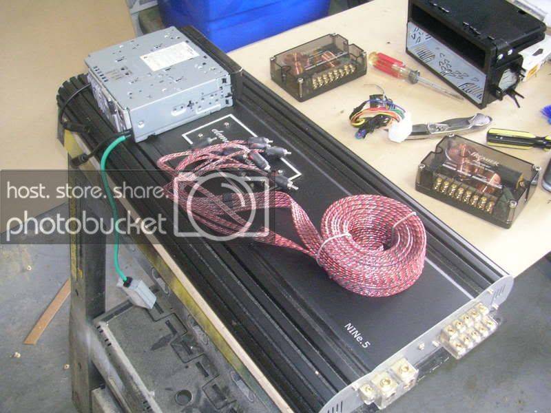

Finally, I went active. I couldn't have done it without Parag, Jordan, or Alex. Thanks for being so patient and willing to explain everything to me guys.
So here is the equipment...
eD NINe.5
9855
720PRS Mids
Blaupunkt VC100 tweets
Stinger/Kicker/Knu wiring

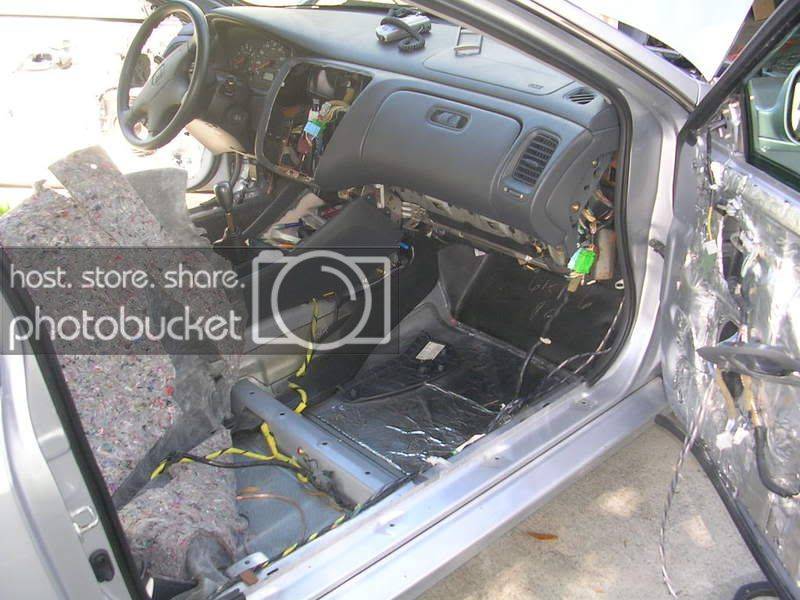

Doors deadened with Damplifier/Pro, floor/trunk is deadened with R-Blox and Damplifier/Pro.

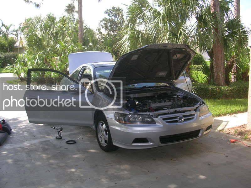

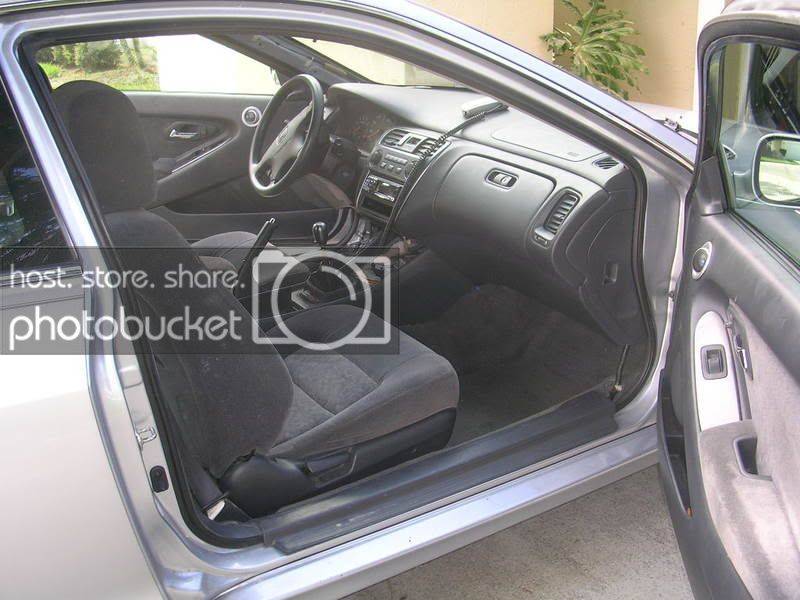

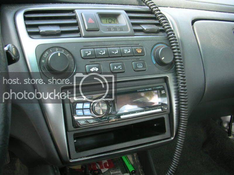

It sounds......amazing. I have the mids crossed at 63hz with an 18db slope, and they are pure secks. People weren't kidding when they said the PRS mids came alive when ran active. Here are some pics for you guys to enjoy.

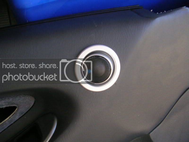

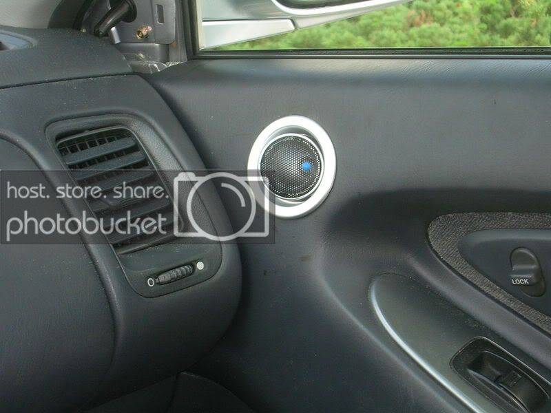

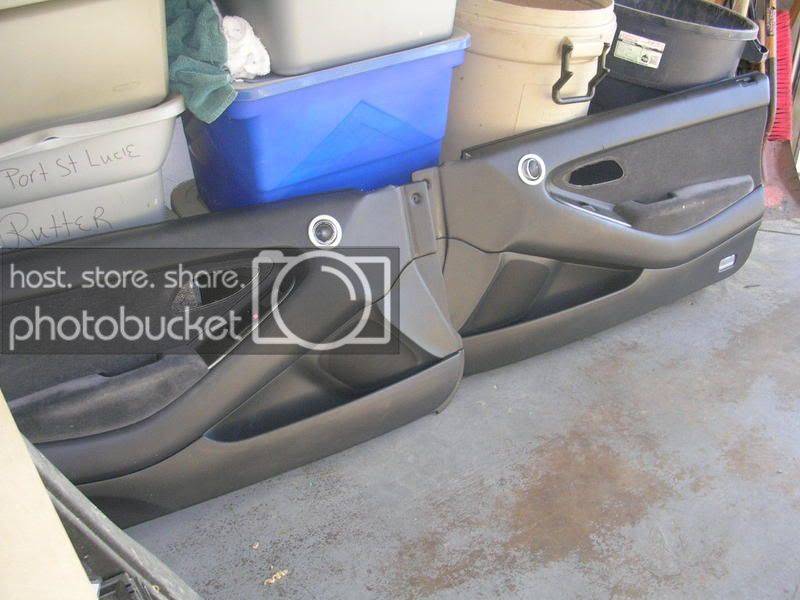

wow man, great job. I like those tweeters! Mounting looks delicious //content.invisioncic.com/y282845/emoticons/biggrin.gif.d71a5d36fcbab170f2364c9f2e3946cb.gif
Thanks, not bad for $20 huh? //content.invisioncic.com/y282845/emoticons/eek.gif.771b7a90cf45cabdc554ff1121c21c4a.gif
Any chance you could explain how the **** to install those tweeters? haha
I have them, love them but I don't understand their installation methods..
Doesn't get much easier than these tweets. Make a cutout for the moutning cup, pressure fit it in, mount the tweet to the cup, done.
I'll have to take another look at the cups., but hopfully that will help me visualize it //content.invisioncic.com/y282845/emoticons/smile.gif.1ebc41e1811405b213edfc4622c41e27.gif
