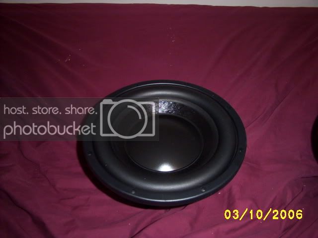

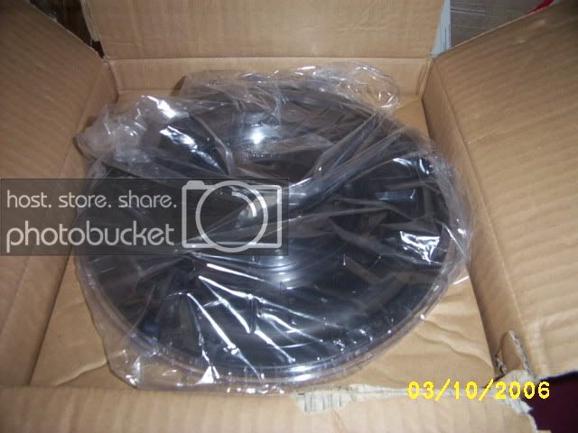

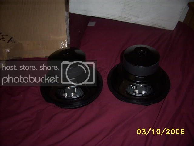

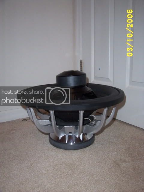

Assasins are for the girl... here is what went into my truck today...

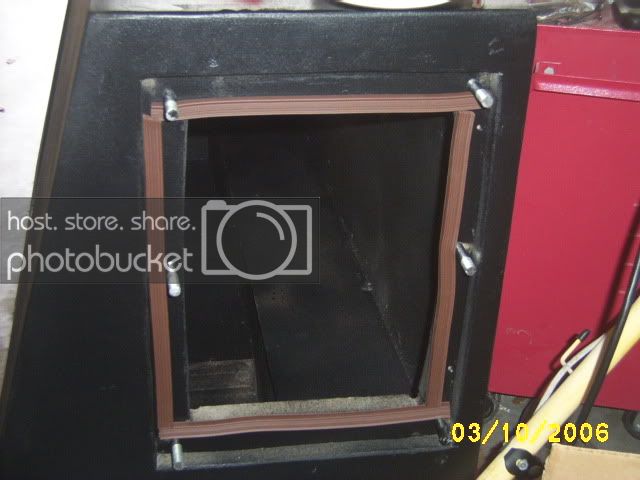

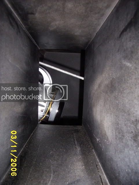

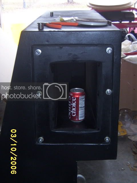

IPS System...lol

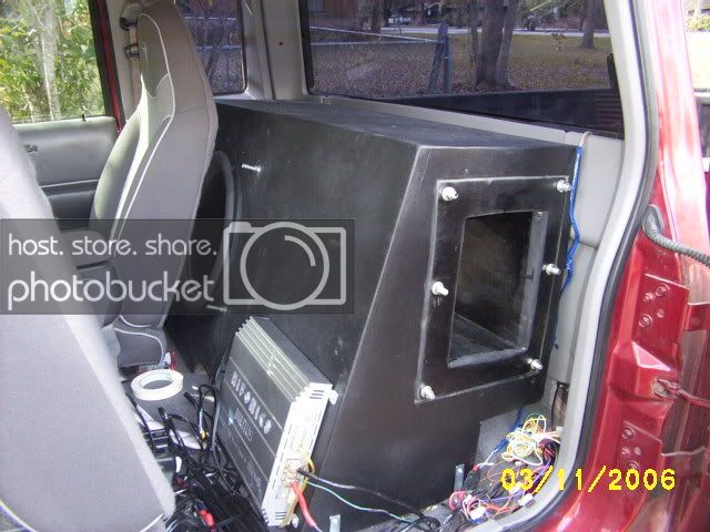

daily Port @ 28Hz

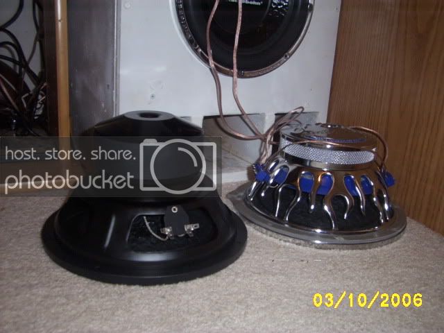

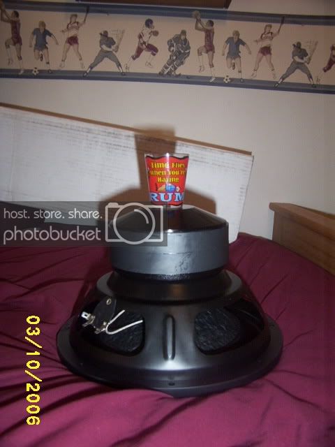

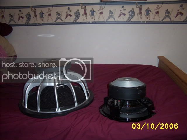

some comparison pics while the Ava was out of the old enclosure
Granpa eats granson

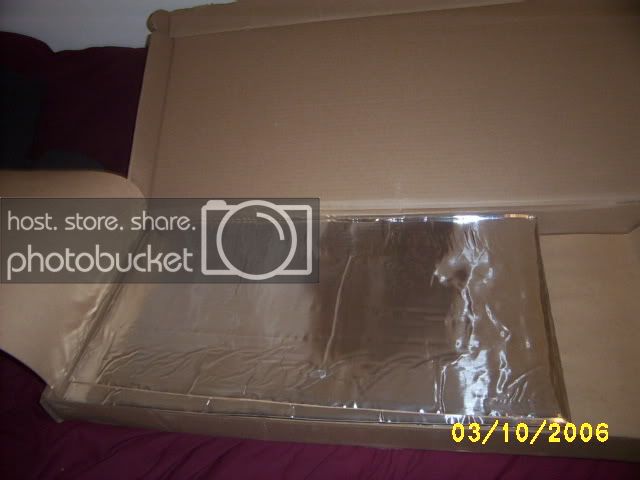

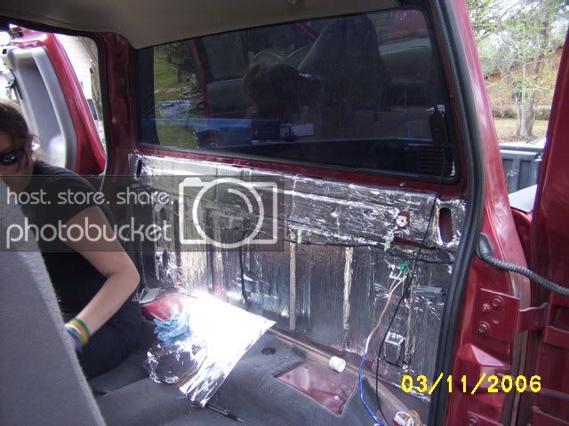

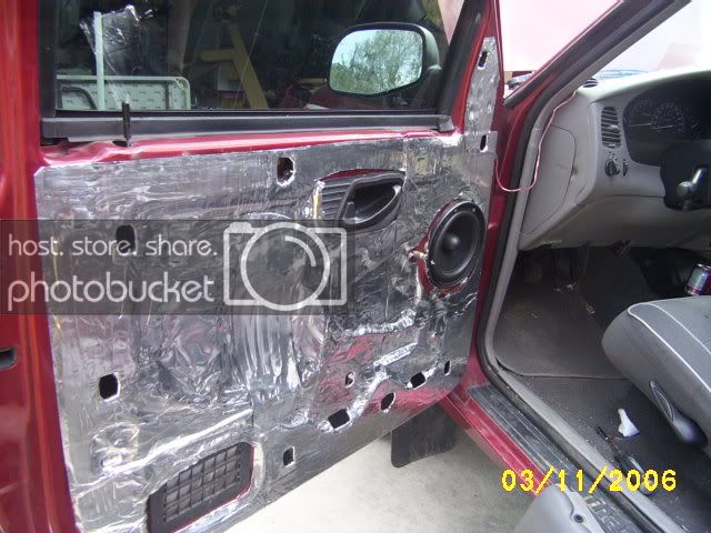

Amanda had to earn her assasins...heh, more like she was bored so i taught her how to apply sound deadener.
need t to vacume and clean someof the wires up but..yeah.
Second skin is great stuff. Couldnt peal it off if i wanted to after proper application, and now when everything is sealed up you can barely hear anybass outside... door rattleing agianst the jam is louder than the bass.
Back glass got 3-4 layres right below it so it nolonger moves 1" or so...still moves quite a bit though. 2 layres of damplifier all over and overkill in the doors. still have a few sheets and a bunch of overkill left over but that wil be saved for later. //content.invisioncic.com/y282845/emoticons/naughty.gif.94359f346c0f1259df8038d60b41863e.gif
Why'd you poke the holes open n00bx? You should leave them sealed off with the deadener. //content.invisioncic.com/y282845/emoticons/wink.gif.608e3ea05f1a9f98611af0861652f8fb.gif
Also, like I said... this will greatly raise your RF. For the competition port...I'd tune to around 50-54hz and burp around 56-60hz...

door panel has to go back on n00bx...all the other window acess holes where sealed up.
I need to reset my gains but sadly my multimeter died and uses some asian mini 12v battery so i need to go to radioshack and get a new one.
after i set my gains im gonna go down to Audiowaves (local shop) and get metered on Audio Controll. If i get near 150 with my daily and over with an SPL port (i have a bunch of scrap wood im gonna build 2 today) im gonna go ahead and compeate (for shits ang giggles only) in Street C agianst kickenaudio from SSA in Fernindina. Gonna have my arse whipped, but oh well.
The lil wire, that is for the tweeter which is mounted on the dash, im too lazy to run it though the boot. lol. When in install my IS2080 im gonna have to take the boot off anyway to run new wires into the door so ill relocate then.
