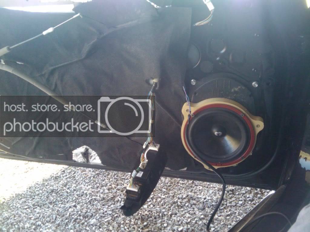

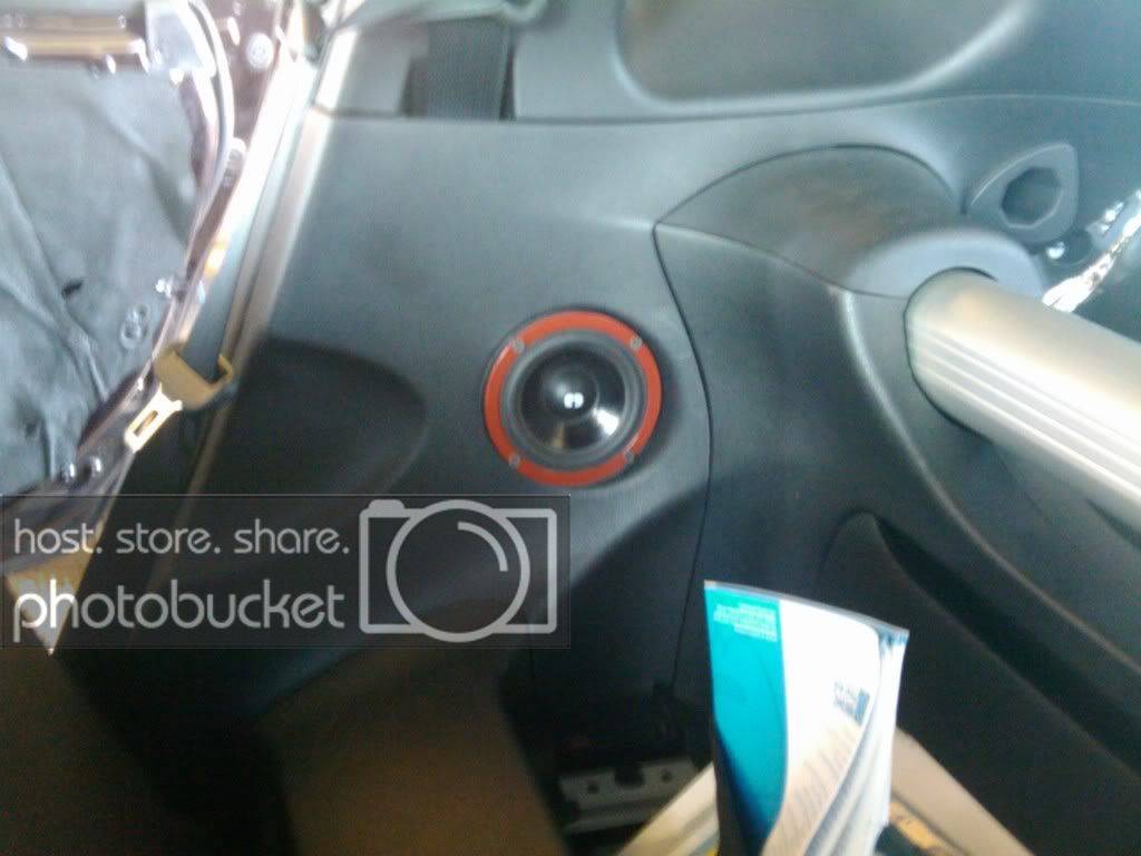

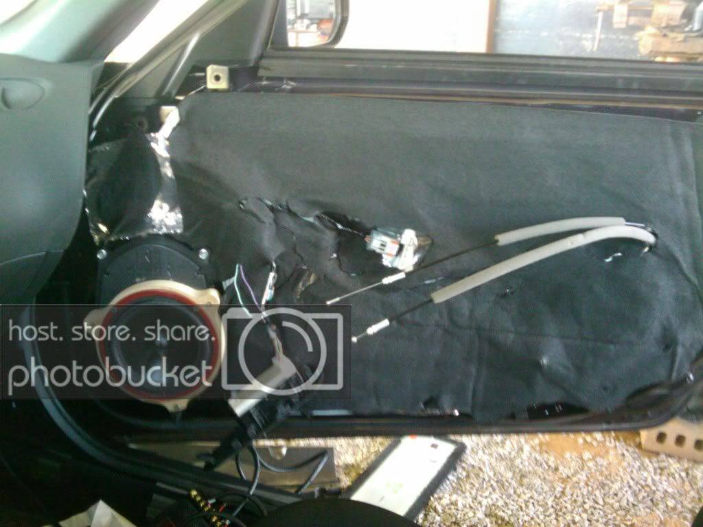

I Rammatted the door skinbehind the speaker used a 3/4 or 1 in spacer in the factory hole for the mids. I installed the tweeters (not shown) in the door panels infront of the door handles. Its about arm pit level and about a foot infront of your of our ears in a normal riding position. I didn't have room for the 4in speakers in the doors and I didn't want to them get damaged by a foot in the kick panel. My car doesn't have large foot wells to begin with. They already had mud and scuffs on them when I started the project with less than 3 thousand miles. I wound up installing them behind the front seats at about shoulder level. It is the factory location for some speakers if you spring for the Bose stereo. I know this really jacks up the staging but I didn't want try my first time with fiber on a new car.
driver's door
passenger's door

Do not run the front woofers through the passive crossover then. Run the front woofers full range (or just with the HPF that corresponds with the sub LPF). That mid plays the majority of the music you hear, being behind you is a problem if you are just using the passive crossover that came with the set. you can still run the mid through the crossover, but since you have no fader, it won't perform the way it could. You could just now run the rear mid or get it on separate amp channels and attenuate it. I would vote for not bridging the set and getting some 2-way crossovers that are made to go with the front woofer and tweeter to run ofmthe front amp channels, then running the rear mids through the 3-way crossover mid output on the rear amp channels. While you will have less power, it should sound a lot better, and louder.

you want front/rear fader in order to attenuate the rear mids. you installed a 2-way front component set and a mid rear fill. you just don't have it wired correctly for that configuration.
you don't get much sound out of the woofers because of the crossover. step one to more output is to simply wire the woofers full range (move the woofer wires to the crossover input terminals). that will instantly give you more output. try this first without un-bridging the amp.
to better control front/rear information, you would un-bridge the amp, get a 2-way crossover from CDT that is made for the 6.5" woofers and tweeters (i'm sure one exists already as CDT will mix and match drivers for different sets). the bandpass filter on the midrange output of the 3-way crossover is adequate for rear fill, you just need to turn down the level.
i recommend you try this: front HU output feeds the front woofer and tweeter amp channels, rear HU output feeds the rear midrange amp channels. new crossover for front woofer and tweeter. reuse existing crossover for rear fill mids.
