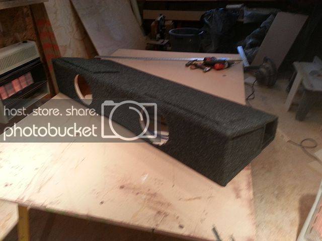

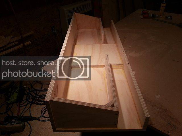

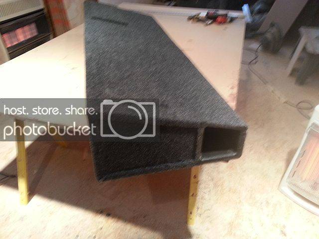

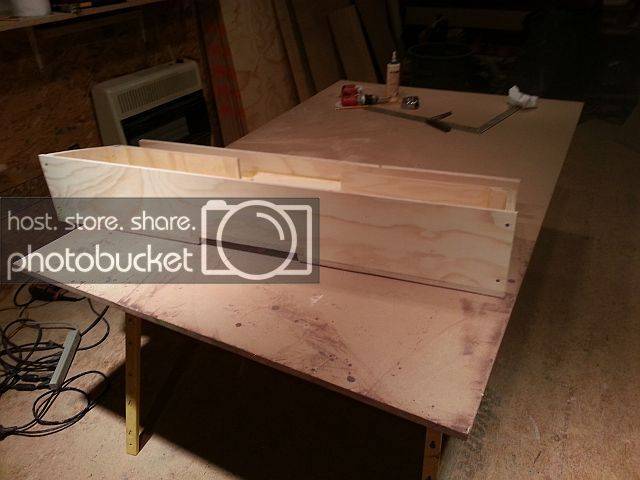

Like the title says I have quite a bit of port noise. My box is built by double 07 for four 8's under the seat of my crew cab. The box is around 2.5 cubes tuned to 35hz. The noise is very muffled at high volumes and honesty sounds like crap. Any suggestions on a solution or should I just build a new box maybe with aeros instead of the slot port?
Port area is too small for 4 8s your gonna need at least 2 5" aero ports.
I just pulled the sheet on your enclosure...it has the most port area I could get @ 13" per cube without shrinking the net of the box down further....It has dual ports...here are some pics and the port mouths are flared a little as well.......My question is did the noise just start or has it been there all along...I haven't heard anything from you...I am sorry you are having problems...
With loss of output you may have a sub out....we can entertain getting more port area on a new box but you will have to do some custom seat mounts and raise that seat a little....because your current enclosure is as big as we could get it....we will get it figured out...
All subs seem to be working, I'll have to double check though. Thanks for the help guys. @double 07 what if we went 2-2.3 cubes net and more port?
That wouldn't net you much more port area....it would be nice if the box could grow a little to allow the net to stay there or go up a little as well.......I will look at the box pics and dems again tomorrow....
