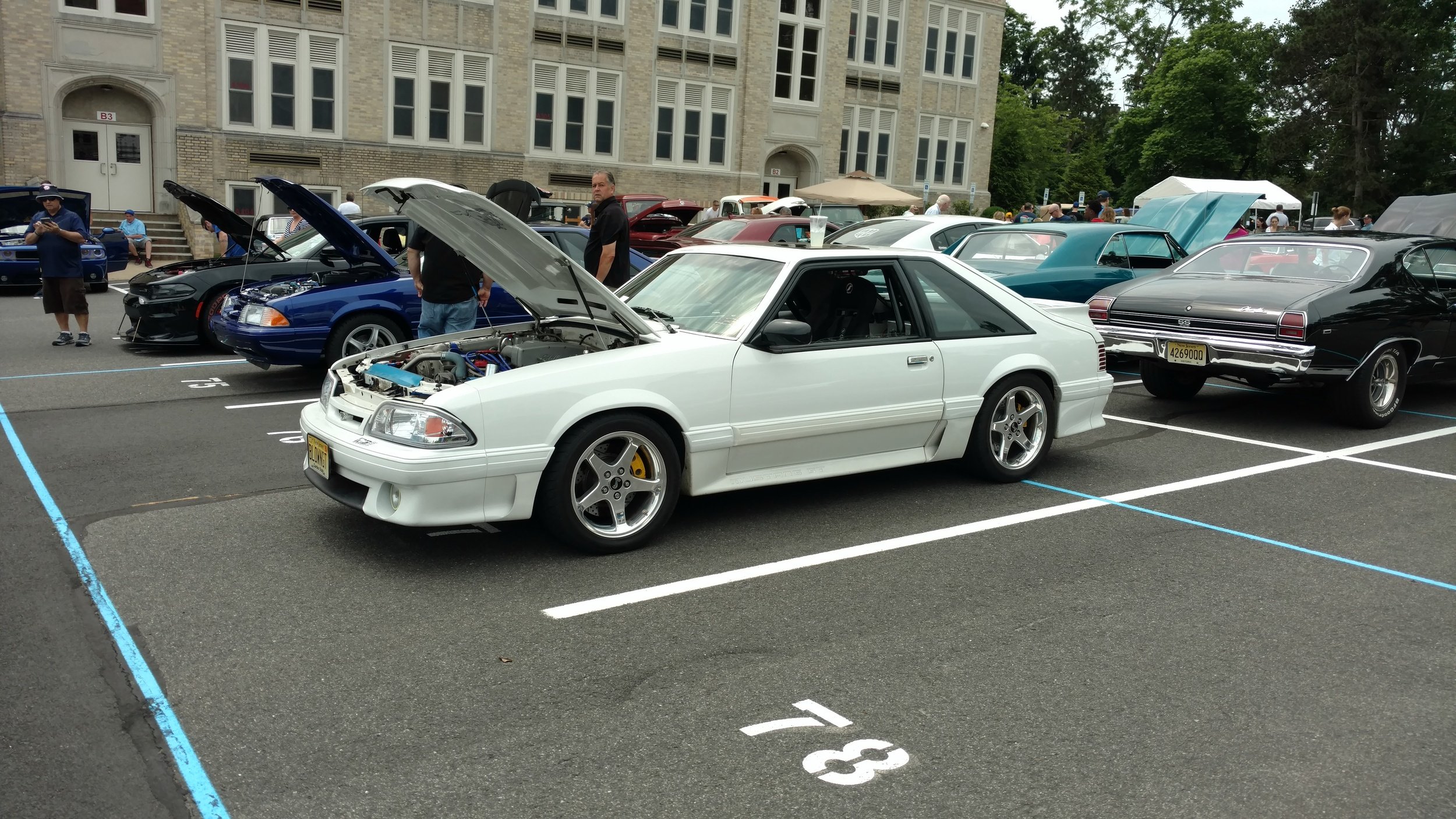

Aha! The smoking gun. Newer radios seem to be more susceptible to RF noise. May be part of the planned obsolescence agenda. RFI compliant means they can receive noise but must not emit it. But at that range I do not know if it is acceptable. I think High Flow fuel pumps also emit RFI. You may have to sacrifice yourself and settle for Bluetooth or SD Card.
BTW, a picture of that 'Stang would be neat.
