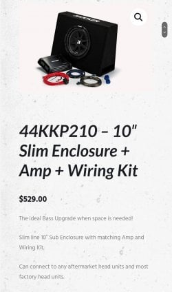

It's one of these bad boys. Comes as a package. I believe it's a ported box.
This is only a 150 rms sub. I havent found what it is tuned to. I would recommend looking at a mininum of a 600 rms sub up to 1k rms @ either 1 or 2 ohm and an amplifier to match with a ported enclosure tuned from 32-35 htz with sub and port facing rear of trunk which generally yields great result for trunk placement. Others may chime in
