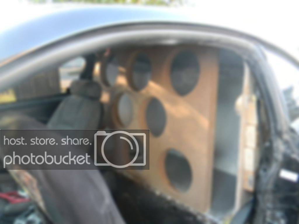

I have my car walled with 8 10s. It seems the top passenger side and top middle subs have a loading issues because i keep breaking the joint where the cone attaches to the coil. It seems like it is the top passenger side one more than the middle but i replaced the middle one the other week and noticed it is starting to rip its self apart to.
How should i go about with fixing this without building a new baffle.
Here is a pic of my wall. It is before i had the port in so dont say its because i have no port
i dont know about the loading issue other than the top of the box being on a slant causing wave interferance but as far as the neck joint. when u fix it heres the steps for an unbreakable joint
use 5k lbs pressure epoxy on the joint.
let dry
put a line of goop on the bottom of the neck joint (aka spider joint)
let dry 24 hours
put a line of goop on the top of the neck joint (aka cone attachment joint)
let dry 24 hours.
then recone the sub and i promise you wont be able to break that neck joint again. i have had about 10 blown subs and alllll of them were thermal none of my blown subs ever came from mechanical issues.
