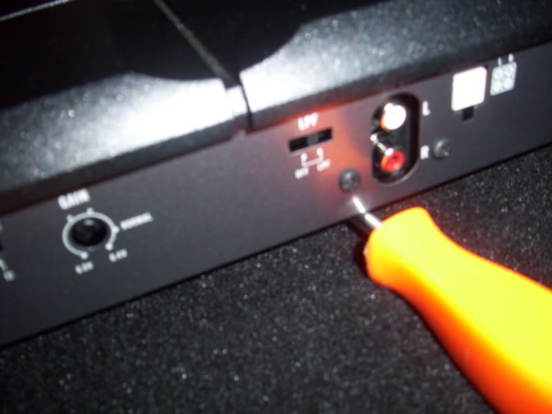

****it. I knew I shouldnt of trusted imageshack for long term images.
Oh well, my detailed images are gone. But here is a similar one with similar arrows pointing towards the various bits.
RED arrow is pointing towards the speaker outputs from the factory amp going into LOC
YELLOW arrow is pointing at the wires that come out of the aftermarket amp and connect to factory speaker wires.
GREEN is pointing towards the RCAs that connect to your amp.
