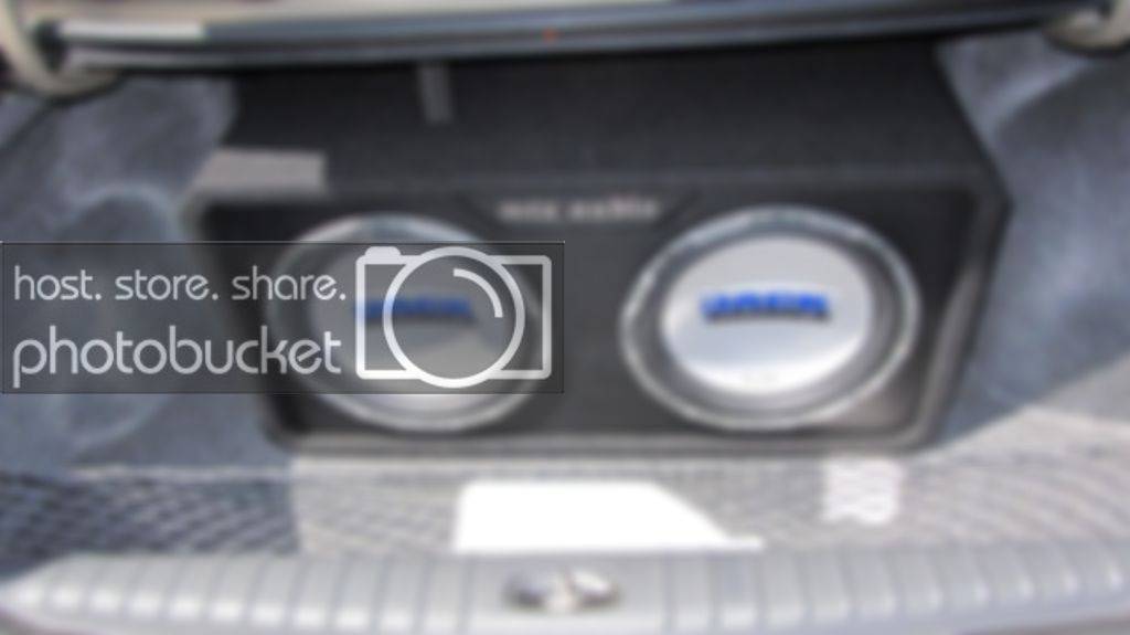

Running a ported now with two MTX JH45's on 500rms. Moving to two 12" MD's on 2200rms SQ2200D Singer 320 HO alt.
Pretty sure I' am not going to have enough room for a ported box max dimensions are about 32w 19d and 16 h taking into account wood width of build.
Thoughts on Sealed? Not really looking to hear it 5 miles away SQ is fine for me. I assume it will still get loud with those subs and 2200 rms. Current set up below
I bet if u shrink the height down to 15"u can gain another 6-8" inches from the depth ..have u mocked up with cardboard different sizes..that just seems really shallow..u would be suprised at what little tweaks will gain u space. My last box i shortened by half an inch and gain almost 4 inches of depth
Nope been pouring here so haven't been able to get any cardboard from work. I' will have to measure the distance from the current sub face to the trunk see how much clearance I have to work with. Amp u see sits up against the seat the seat is down in the picture it's a sedan. I can't go higher either the Kappas are only about an inch from the top of the box.
