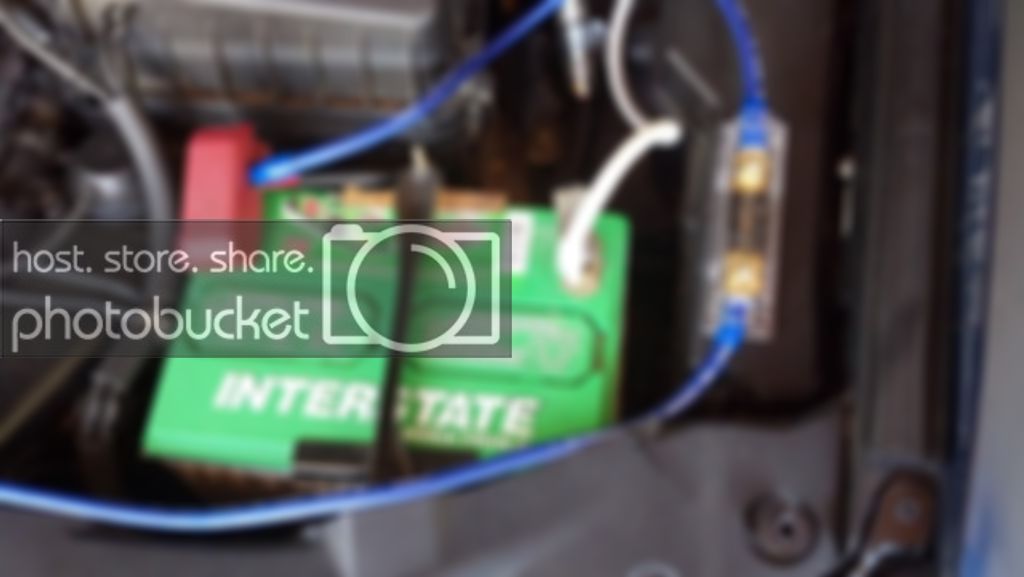

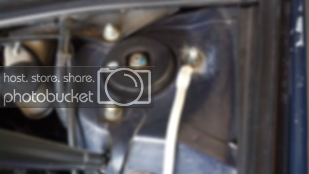

LiL 2 enough?
™Caveman
Looked like factory ground to engine block was already 4 gauge... think that's gonna do it?
Or shall I piggy back engine block to neg battery?
System already sounds way better.
It’s so easy and inexpensive to do it up nice that I always go for more than I actually need. I do 0 from alt to battery
0 from alt case to ground
0 from engine to ground
0 from battery to frame and engine and body
When I do cars for other people I do it this way also. Its just too easy and I can rest assured that there will be no problems.
