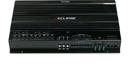

See the third set......
What I haven't figured out yet was if using a 4 channel amp through those do all 4 channels work. I gave that amp as an example because I'm gonna use one of those.
