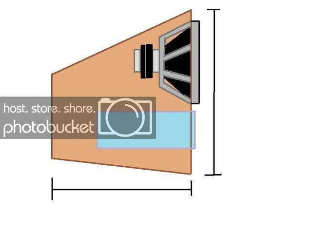

Basically we are walling the hatchback. >20 cubes, 8" port. This is temporary until a 21" or 22" driver of similar specs is finished. ( >30mm Xmax,
I originally designed it to have the sub on top and port on bottom, but once the 22" is in, side by side works better.

so ur making a wall for an ib woofer?
yes. I prefer to think of it as a driver with an Xmax of 30mm and an Fs of 22Hz ( a tad too high for me, but it's temporary till the 22" is done which will most likely be lower)
Not only walled, but ported as well... if I just did a wall and left the rear "open" it still wouldn't be enough airspace to qualify as a "true" IB. IB requires 10 times the Vas on both sides, this subs Vas is 13.7 cubic feet... it would need no less than 137 cubic feet on each side.
