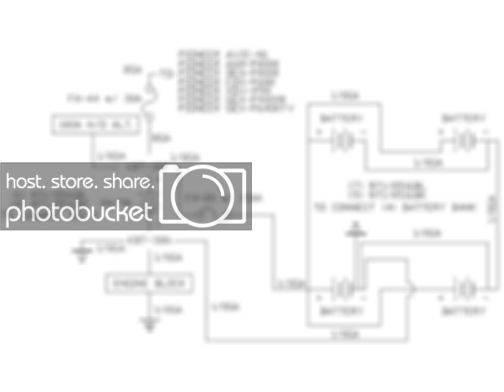

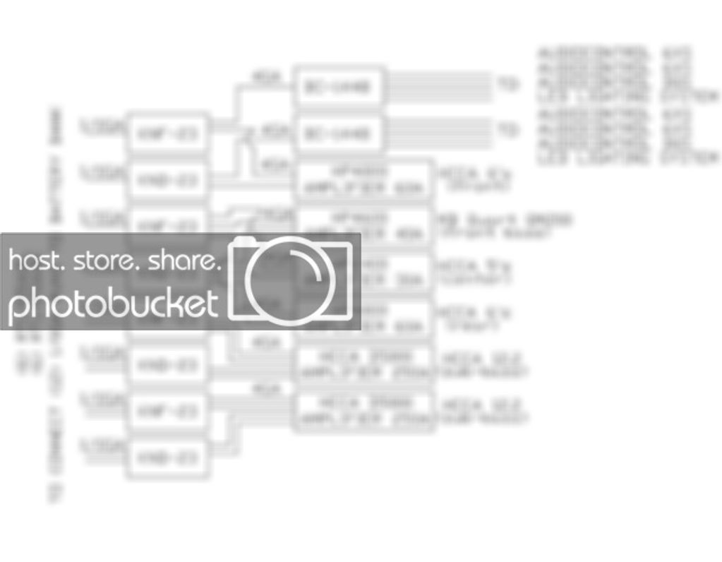

You have no idea!. I recently drew up a Schematic for my up and comming system to get a list of wire, fuse holders, disto blocks, ect. ect. the list came to $1141.60! Some of my earlier sound systems didn't even cost that much.

I'm not going with that many amps/speakers, but i'll probably spend the same on all the installation parts. //content.invisioncic.com/y282845/emoticons/wink.gif.608e3ea05f1a9f98611af0861652f8fb.gif
And I am going with all Kolossus.
