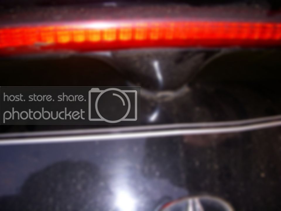

kinda ripped my spoiler mount

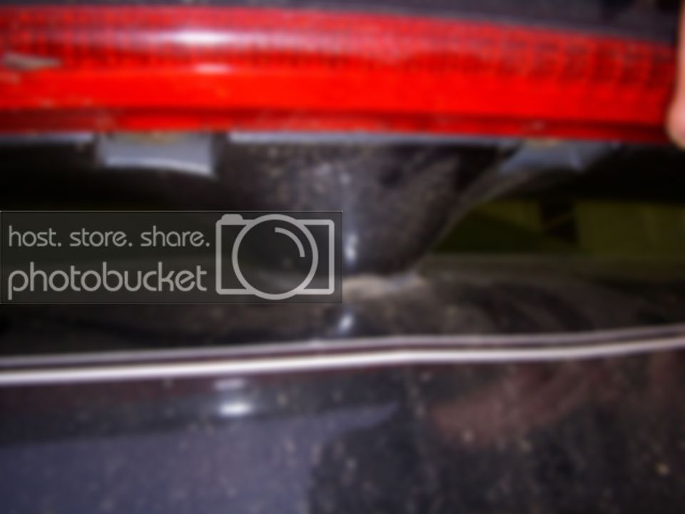

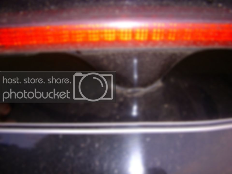

anyway here are some pics of the actual damage. how would you fix it .i have 48 hours to fix it before a show. any idea is appritiated. silicone has been thought of but i do not think it will hold. my roof is also starting to go //content.invisioncic.com/y282845/emoticons/crap.gif.7f4dd41e3e9b23fbd170a1ee6f65cecc.gif
My last hatchEs spolier, wana know how I fixed it? Scrap yard swap out, the whole hatch lid.
can't make it pretty in 48hrs unless you can take it off, weld scrap metal over holes, buff and paint.
does it come in black? //content.invisioncic.com/y282845/emoticons/laugh.gif.48439b2acf2cfca21620f01e7f77d1e4.gif do you have any idea how flexible that stuff is right off hand?
Yeah, there are different colors. Sorry, couldn't tell if your car was either a dark blue or (no offense) a little dirty but black. Flexibility all depends on the epoxy you use, hardening time and application. There are a lot of different types. Sorry I am not more specific.

black base blue sparkles and dirty :/
many ways to fix that in 48np. have done entire vehicle customs in a little less. there are hundreds of good epoxies you can use, just have to pick out the proper one for the job. if there is still the mounting piece stuck to the hatch, it is simple as picking the compatible epoxy and prep with scotch brite while prying it apart, and then epoxy it back together. or other etc. key is in the prep and some setting pressure to get it in all the little places. if you want it to hold better than a weld, go with fusor(25000psi) but it's gonna run you $50+ for one little tube.
