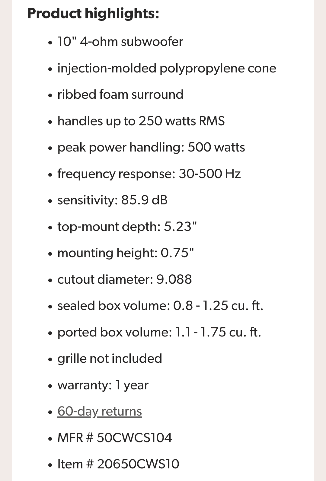

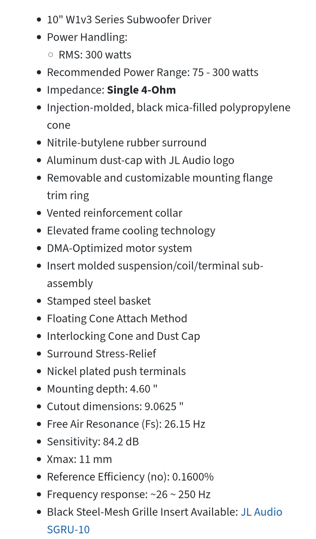

The comp is the older C model it is a single voice coil 4 ohm. Haven't installed them yet. Waiting on a day off, hopefully Tuesday. I also got a lot of sound deadener to install in the doors at the same time.
This is the speaker I have vs what I was thinking of going with.
