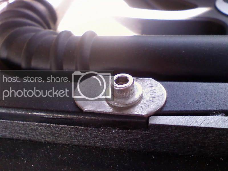

well i made my new mounting bolts of the sub and i am very happy with it. everything clamps down on the surround making a MUCH tighter clamp on the surround. even without glue there is no way to remove the surround now with out ripping it out. i will put some pics of the clamps this afternoon. works perfect and has the added bonus of looking cool to lol
someone asked me for a pics of the way i made the bolts pull down on the black retaining ring. in sort i just took some long oval washers and made it so the bolt can not go into the hole. now it sits on top of the rim and pulls down as tight as i want. I used T nuts on the bottom so i dont have to worry about striping the holes out. super simple but here is the pic.

Hey i just finished sanding everything down and i got the clamps ready. May I ask what kind of rubber cement did you use? The closest glue i could find was Elmer's rubber cement or gel epoxy, but im afraid they wont bond as good or be too stiff. Thank you
Old thread is old.
I just used Shoe Goo when I repaired one of my 15" L7s, that stuff is pretty strong, but requires DAYS to properly dry.
Edit: Forgot to specify that I had to rewind the voice coil on it, and was not due to the surround, though I did have to follow this process mentioned above. I did have to cut the spider and glue the edges together to the plastic ring as well. That glue was a PITA to get off.
i used gorrila glue. they have a flexable rubber like glue. dont use the "standard" verison. it expands to much
