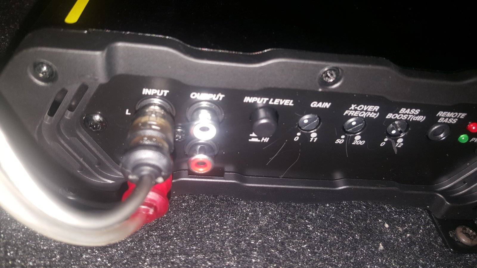

Bestbuy installed everything May 2014. The amp blew out of no where last week so I went to bestbuy today and they replaced it for me. I was driving home and noticed that some songs have very noticeable crackling sounds...
I am clueless with the settings on amps so can someone lead me in the right direction. Right now I have the input pushed in (hi) and gain around 4 (0-11), cross over freq. at 85ish (50-200) and bass boost at 0.
it was perfect before.. no idea what the previous installer set them too either

take a picture of the amps settings and post it here, we have no information to work with
here you go... maybe not the best pic but it should be efficient..
As 2 people have said the input level needs to be pushed in. If you are not going RCA from factory to the amp it needs to be high level input.

Per the manual push it in:
Input Level:The RCA inputs on KICKER CX amplifi ers are capable of receiving either Hi or Low-level signals
from your source unit. If the only output available from your source unit is a Hi-Level signal, simply press in the
Input Level switch on the amplifi er. Refer to the wiring section of this manual for additional instructions.
