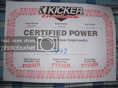

Hi. The kicker birthsheet says 317watts max rms
Model:
KX 250.2
Details:
» 85 watts RMS x 2 at 4 ohms (125 watts RMS x 2 at 2 ohms)
» 250 watts RMS x 1 in bridged mode (4-ohm stable in bridged mode)
I am wondering if somone can tell me how much power this thing can do at 4 ohms. with two channels I searched a bit and cant seem to find anything. Thanks
here is another amp's specs and birthsheet scan to help figure this out
kx 850.2
295 watts RMS x 2 at 4 ohms
425 watts RMS x 2 at 2 ohms
850 watts RMS x 1 in bridged mode
Model:
KX 250.2
Details:
I am wondering if somone can tell me how much power this thing can do at 4 ohms. I searched a bit and cant seem to find anything. Thanks
Now I could be wrong but those look like they are rated to 4 ohm
125/85 = seems that the amp does approx. 32% more power at 2ohm per channel...
317/2 = 158 x 2@2ohm, so approx. 108wx2@4ohm.
I was close enough, i said approx 110 //content.invisioncic.com/y282845/emoticons/biggrin.gif.d71a5d36fcbab170f2364c9f2e3946cb.gif
