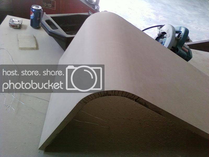

If you need help, let me know. Its super easy to do. Just try a few test pieces first. I can't remember how deep i made the cuts for sure. I think it was around 11/16 down, and space them 3/8 of an inch apart. I just cut a circle at the radius for the bend i wanted, set it where i wanted the bend, and measured the distance between cuts out and marked them on my piece of mdf, if that makes sense.
Yeah Ive seen some similar log. Kerfing is alot easier to do that I expected. Just make a bunch of cuts until you are able to get the curve you want. The cuts should go nearly all the way through. Shallow cuts wont be able to bend.
A table saw works wonders.
I think it would be better to simply glue a stack of boards together and cut them (then sand). The reason you use MDF is because the thicker and more dense the wood the less it vibrates. And a 1/8'' space with some glue behind it obviously isn't that dense or thick... The method I mentioned would leave you with a much thicker kerf.

not to mention the weight and increased cost. You fiberglass behind the kerf, not glue. Mine was fine, it was in a box with a lvl 5 with a saz3500 going to it. Didnt flex at all
