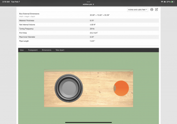

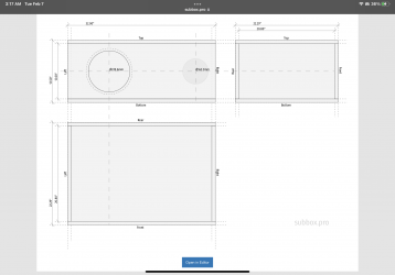

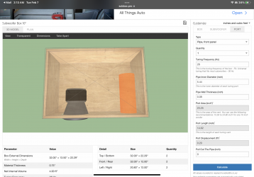

Why waste your time building and designing a kerf port box? Look at the research, there is no actual beneficial gain to rounding the outside of a port. If you want a kerf port “sound” then design the box to be ported with aero tubes. How many Hz are you trying to tune your box to?
Here is a aero tube box design for the sundown 10 that you want to get. I tuned it down to 28hz based off of your dimensions
