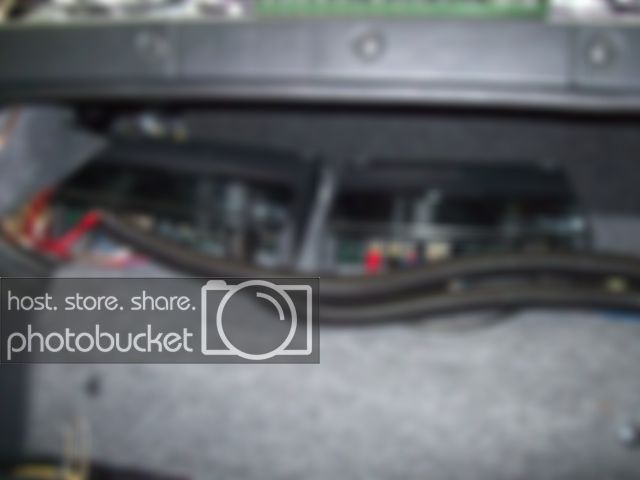

Theres a pic of my trunk. Youtube link is a crappy video my friend in the passenger seat took for me, thats how it sounds now. For some reason when I fade the music back up front, my polks sound distorted.. which I know theyre not. I think its just the crappy flip video camera mic.
Heres my amps, how I have them now.

I have a Kenwood 8105d, and as of a few hours ago on ebay, a Kenwood 9105d. 500W @ 2 ohms and 900W @ 2 ohms respectively.

The speaker amp is fine, that's all good bridging it to the fronts. For the subs though, you can only use one amp, or 2 of the same exact amp "strapped" together in high powered situations.
Something to keep in mind with Kenwood's amps is that they aren't known for actually putting out their advertised power, or doing it "cleanly". A dirty signal can ruin your equipment. I'm not trying to talk you out of your current amp really, but you have to choose one. So keep the 9105d, anticipate it to maybe put out 800w. But sell the 8105d and take the hit to the pocketbook as much of a bummer as it is, and use that money towards subs. You just can't properly use both amps.
As for a used amp around the same price... http://www.caraudio.com/forums/amplifier-classifieds/529587-treo-750-1-a.html
While it's outer case is beat to hell, I guarantee that tiny amp will outperform 2 of the 9105 kenwoods combined, and with ease. That's a great amp right there from a great seller too, just something to keep in mind.
