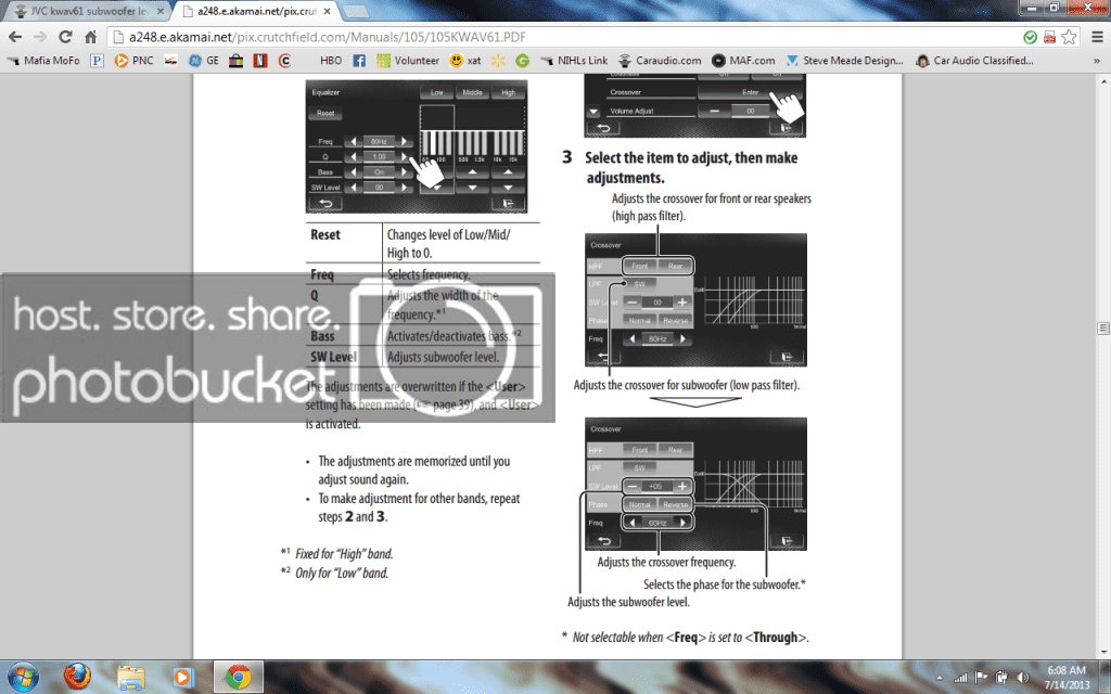

I would 1st check to make certain that your RCA cable is in fact connected to the proper output (Sub) on the head unit. Then check your settings for the LPF in the x-over section of your adjustments (pic incl. for reference)... You've got something along the lines of my suggested connection/settings - off somehow...
